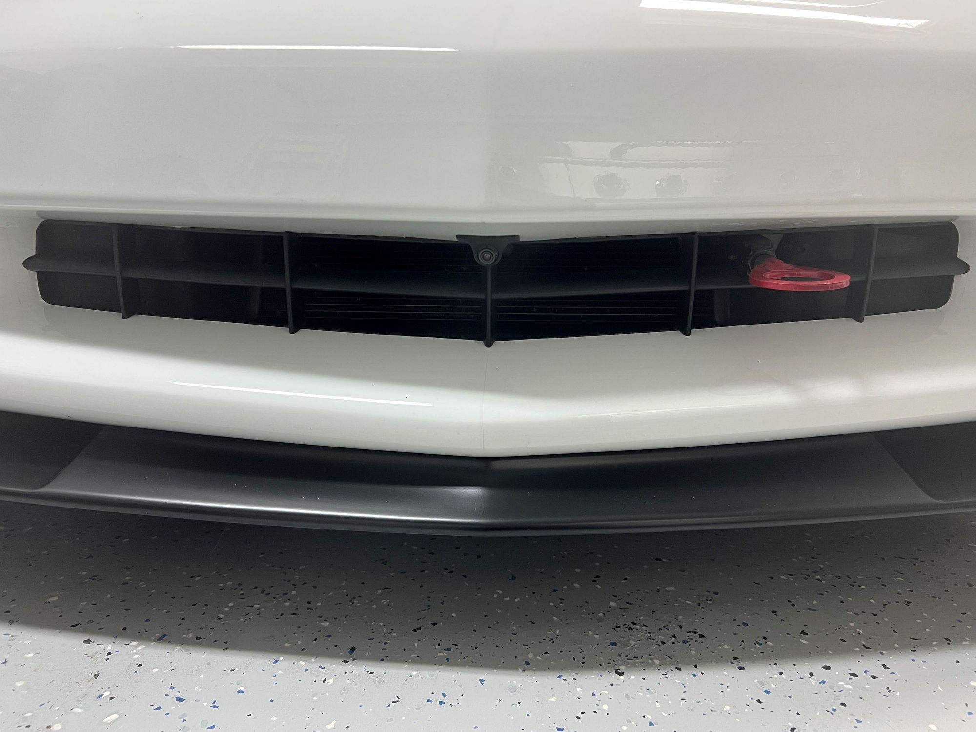

I had a Kenwood DNX577S installed in our C6. I, like you worry about a spoiler strike. So, I had the front camera put in as well. The routing of the wire was easy and I mounted the Cam under the front bumper fairly far back. The camera comes on automatically when I drop her in reverse but there also is a button on the screen for the front camera. Either that or I just drop her in reverse a second and then drive. The cam switches automatically to the forward camera. Yeah, it can be a pain when you are in a hurry...or others around you are. I don't really give a @#%& what they think as it's literally a second out of their lives and saves me MONEY. Enjoy.

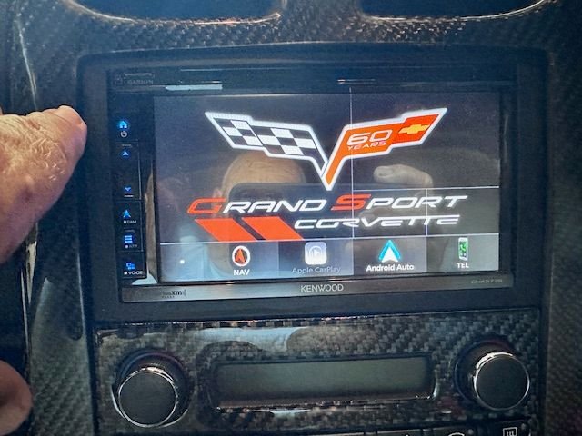

I have a Kenwood and mounted the camera ABOVE the spoiler, behind the grill. It works, I can see what I need to see. My Kenwood actually has a button to push for the camera. THe back camera comes on automatically when I go into reverse. IF you didn't know it was there you would miss it. I don't use that camera much, but instead learned from someone on this forum to STOP, about a foot before you think you should. Works every time.

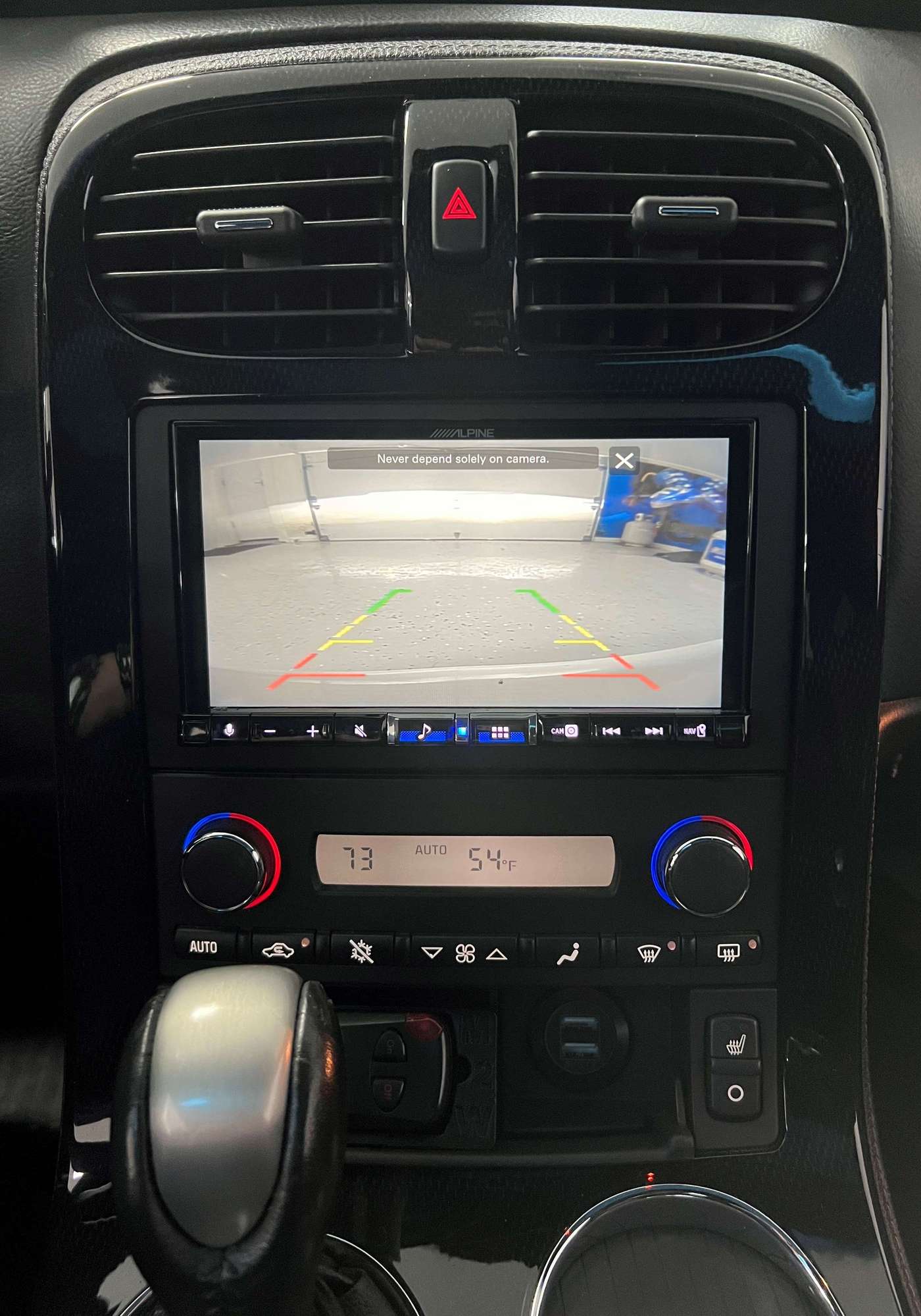

Does your Kenwood unit have any exterior buttons or screen icons for a front camera if it has the ability to connect one? I installed an Alpine iLX-507 which has a camera button on the front (2 right from center). I just push this when approaching anything and the front camera view comes right on, works great. I put the cameras on front & rear, now pulling up to a curb or backing up is very simple & safe. Got the head unit & camera kits from Crutchfield.

Purchased them from Crutchfield. Mounted it using 3m double-sided tape, which I believe was included, and it mounts firmly. I recall there's a clearly labeled camera wire that you simply clip to flip the view for use as a forward camera - it comes set up to be a backup camera. Ran the cable up along right side of the engine bay, and through the large wire-harness boot behind the battery to get it inside & under the dash. A great upgrade and one of those things you wish you did sooner.
