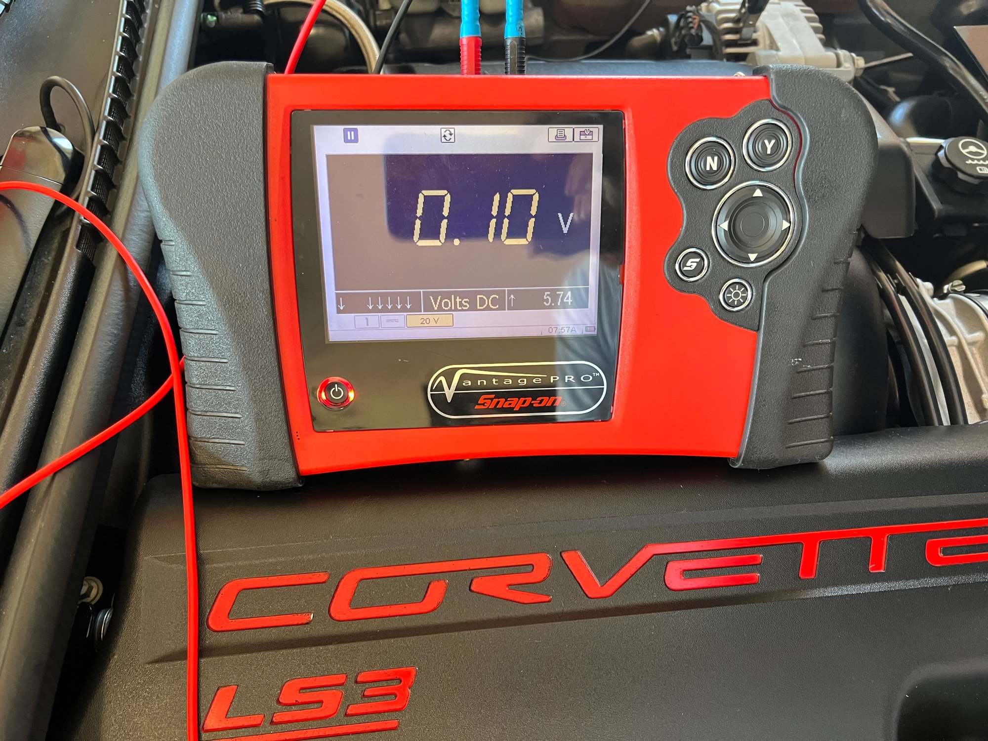

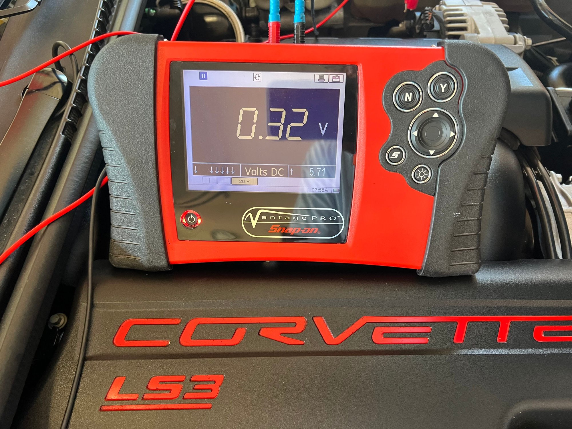

So if you know how to use a DVOM with a load on the electrical system put one lead on alternator B+ and other lead on battery positive and record what you see…don’t worry if you see a minus number just record the value…do the same between the alternator case and battery negative and also record that reading.
Old Aug 4, 2024 | 05:44 PM
C5 Diag's Avatar
C5 Diag
Moderator, Tech Contributor
Posts: 15,320
Likes: 3,927
From: Cape Coral, Florida
These are the values on my 2008…..0.10 on negative side and 0.32 on positive side.
