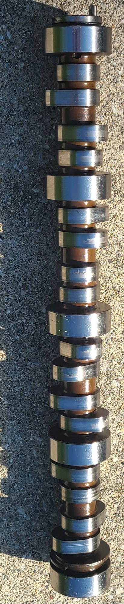

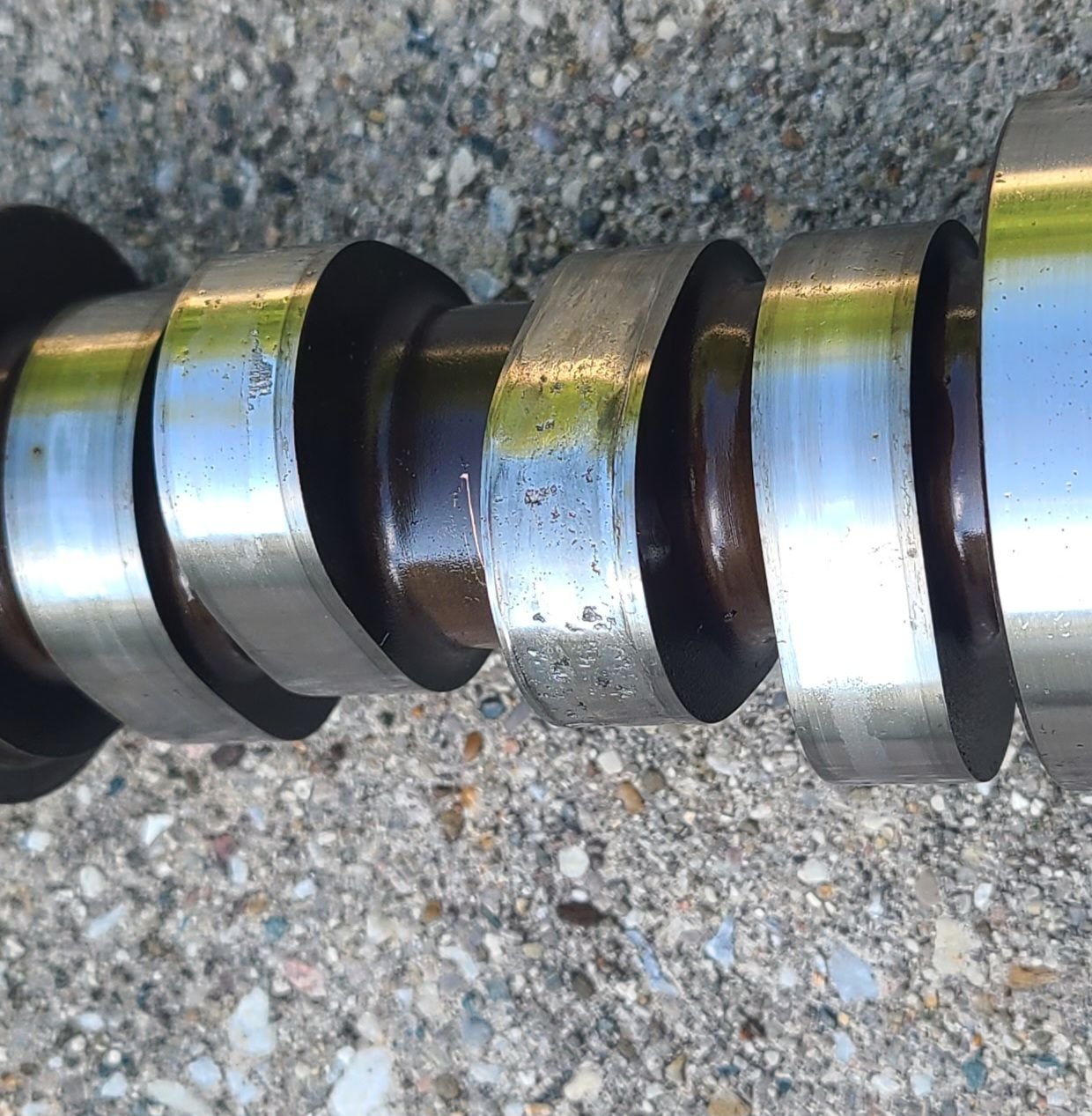

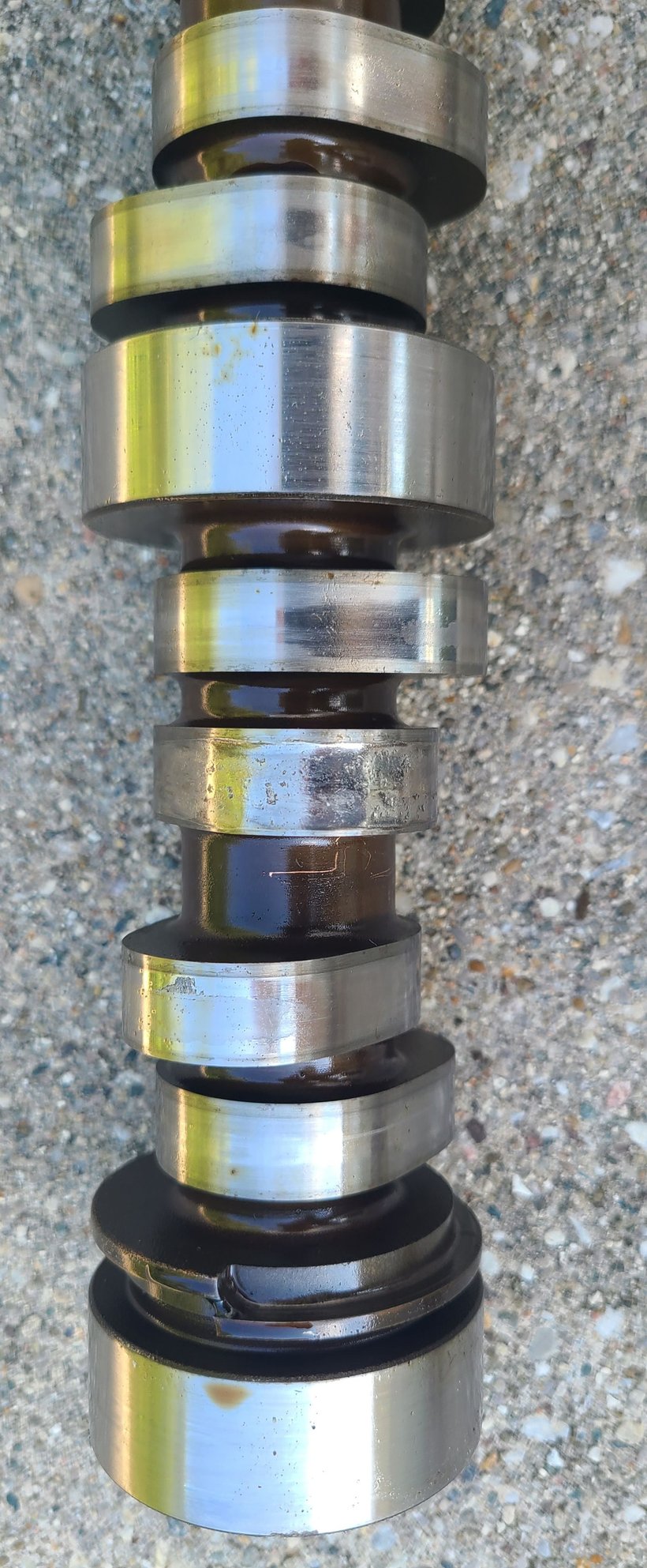

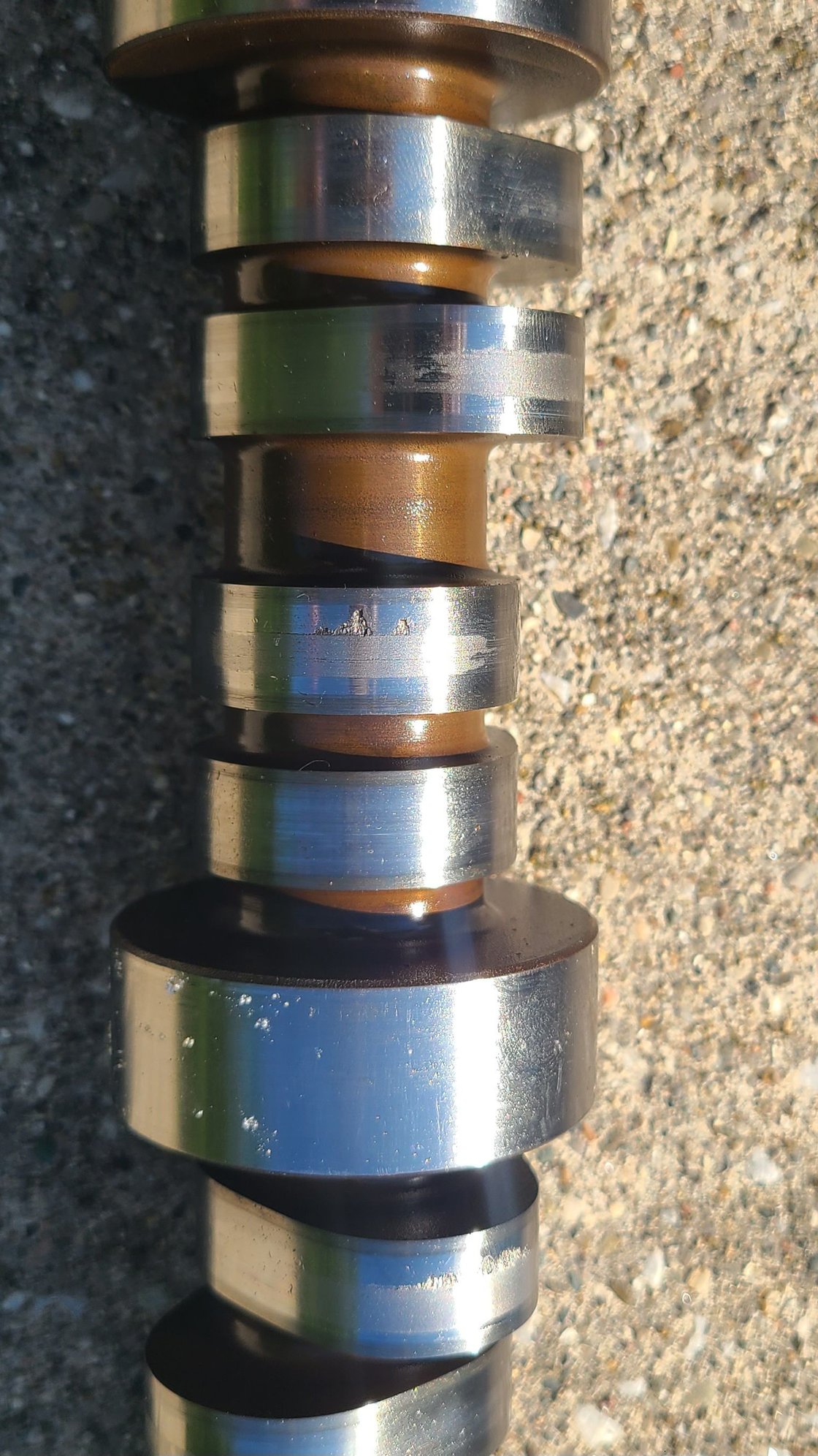

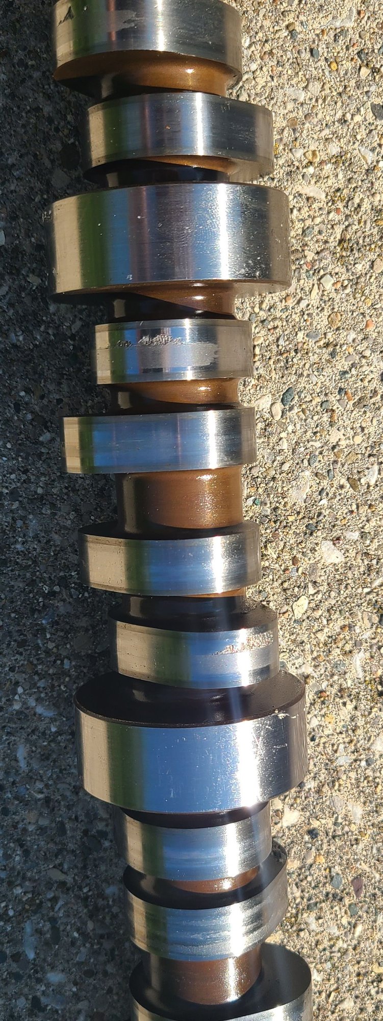

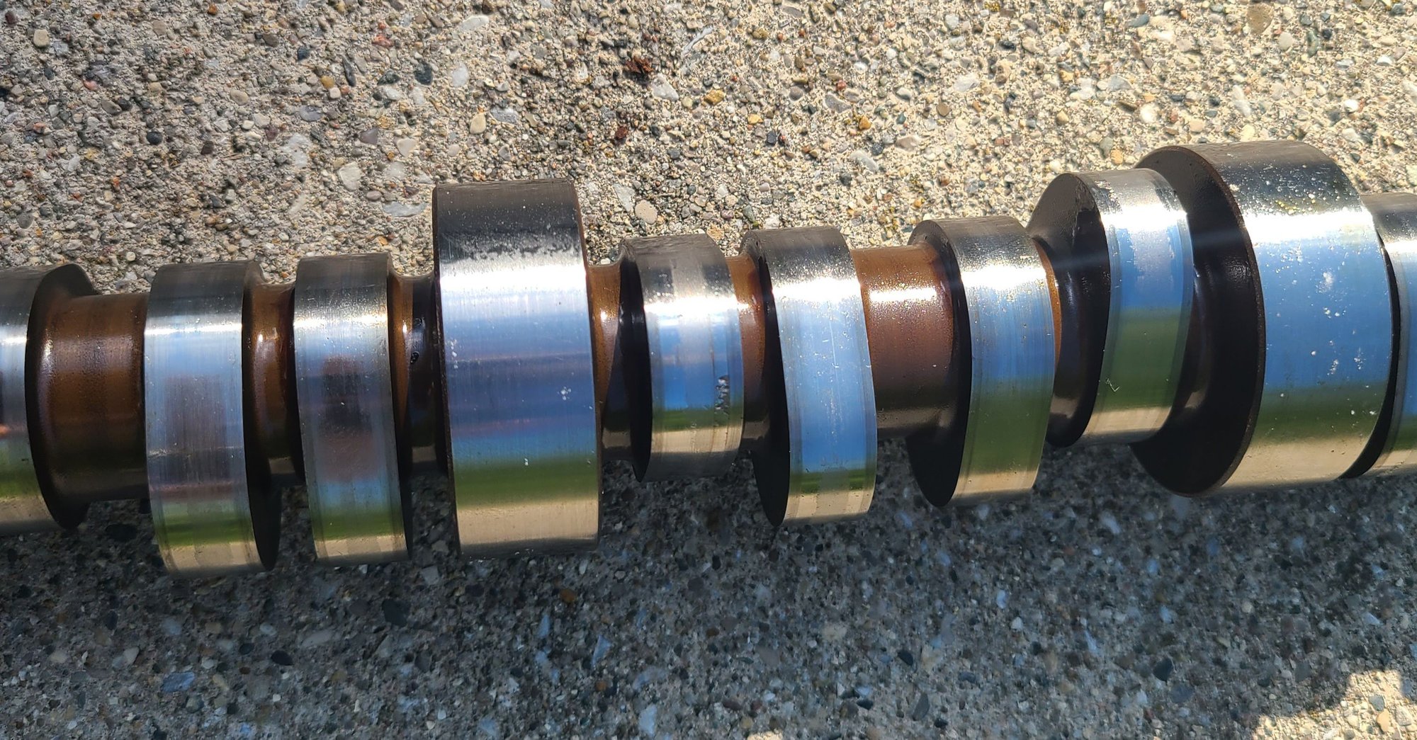

Man, do I hear you on that! Sleep quality sucks as Ive gotten older. Check out these pics, taken an hour ago.....
#8 Exhaust, worst of all...
Another view of #8...
5 of 16 lobes (31.25%) showed some distress, with #8 the worst. Here's the rest of the pics.....
So, here it is....WAAAAHH!!
