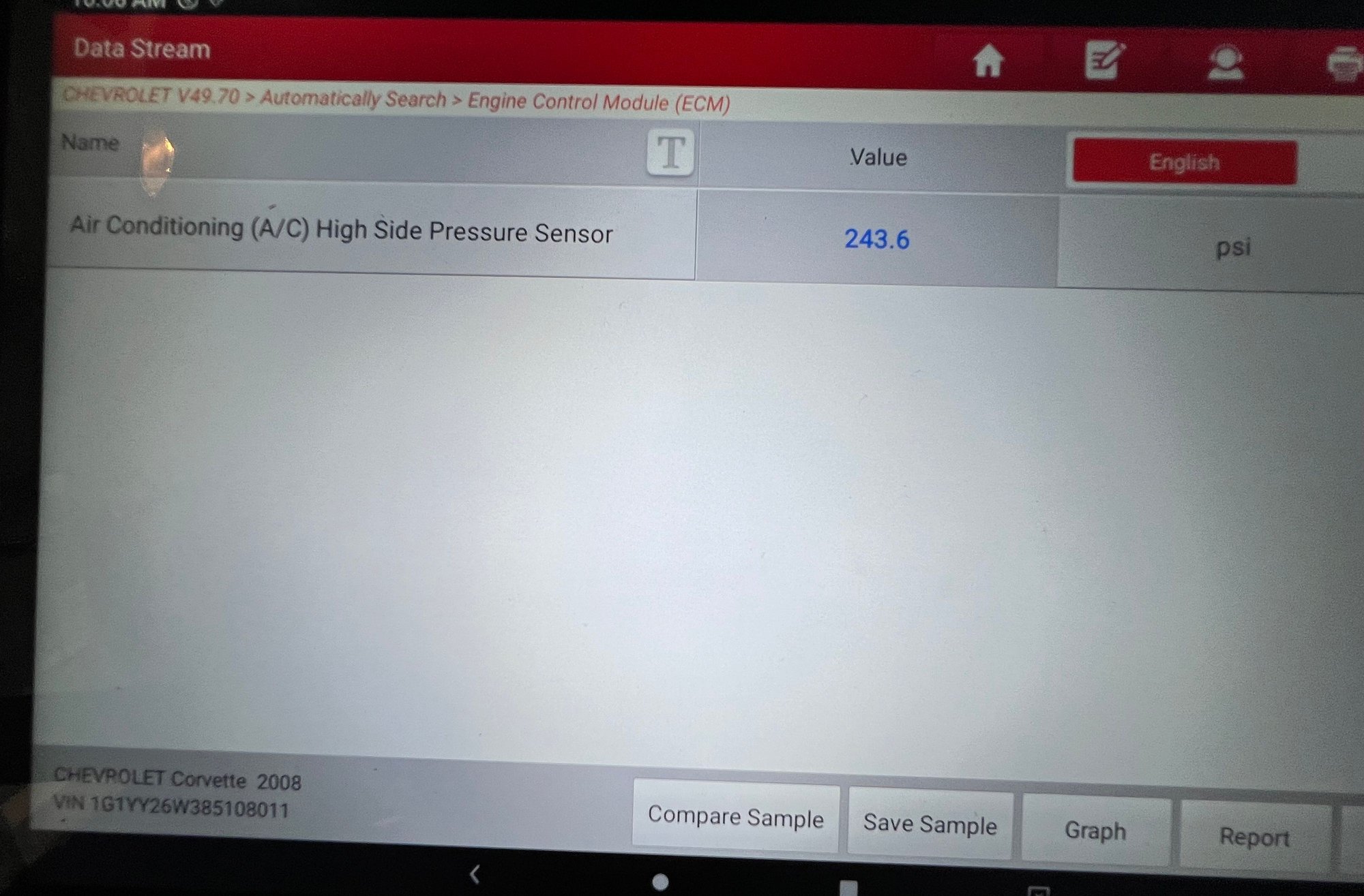

If you have a scan tool that can look at the AC Pressure Sensor data PID if it reads over 160 psi the fan should be running…you don’t need a gauge…no, don’t bother hooking up a manifold…high and low side pressures are dependent on outside air temp and humidity…at 243 psi my fan is running on cold start AC on.

C5 Dieg:My fan only goes to 70% at 203 degrees when it gets to 207 it will start dropping back down,and when it drops below 203 the fan runs at 30%.....That connected above was pulling a lot of current..Right

Was the AC on or off when you saw these numbers ??…did you get them from your mechanic or from you ???…when my AC was ON and ECT was 203 my duty cycle was 49%…with AC OFF it was 16% with high side pressure at 125 psi…the ECM uses the highest of either the ECT or AC high side pressure…someone had posted a chart in this thread…looking at the chart the high side pressure would have to be around 268 psi or so to see a 70% duty cycle…your ECT would have to be around 220 degrees to see 170 psi…if you are using that scan tool look at ECT in generic OBD2…there is something called “substituted values” which I won’t get into right now but in generic OBD2 whatever the ECM is seeing as an ECT will show accurately in generic….the DIC might show something different…the connector melts because there is a bad terminal connection like corrosion or bad “terminal tension” it’s called and that increased resistance causes heat and then the connection melts…I threw a lab scope on the control wire which is a “negative duty cycle” and I saw 10% that matched the scan tool…as duty cycle increases those square waves will get “wider” you can say !!…if you check the control wire with a DVOM you will see system voltage of 12.6 if battery is charged and will drop to around 7.5 volts or so when the AC is turned on.
