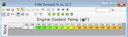

Regardless of the rad and fan(s) that that you have, unless you’ve made other arrangements, you’re at the mercy of the fan table parameters.
The fan doesn’t go to max (90%) duty cycle until the coolant reaches 225°F. If you’re not going fast enough to push enough air through the rad, then the fan needs to make up the difference. You can modify the fan table so that the fan ramps to max sooner, but that puts more stress on the connector to the fan control module, which is a known weak point. IMO , GM underprovisioned that part of the wiring, and possibly the control module as well. Some folks have spliced out the connector and I’ve not heard of a case where that nuked the controller, though. I suppose you could also slice in a beefier connector.
