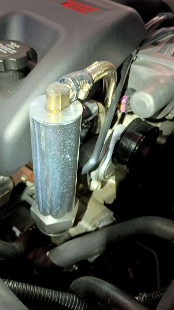

I think this is an oil catch can but there are no identifying marks at all. Is that what I am looking at? If so, it's not going to be fun to drain it.
Looks like a catch can?
Absolutely no markings on it.

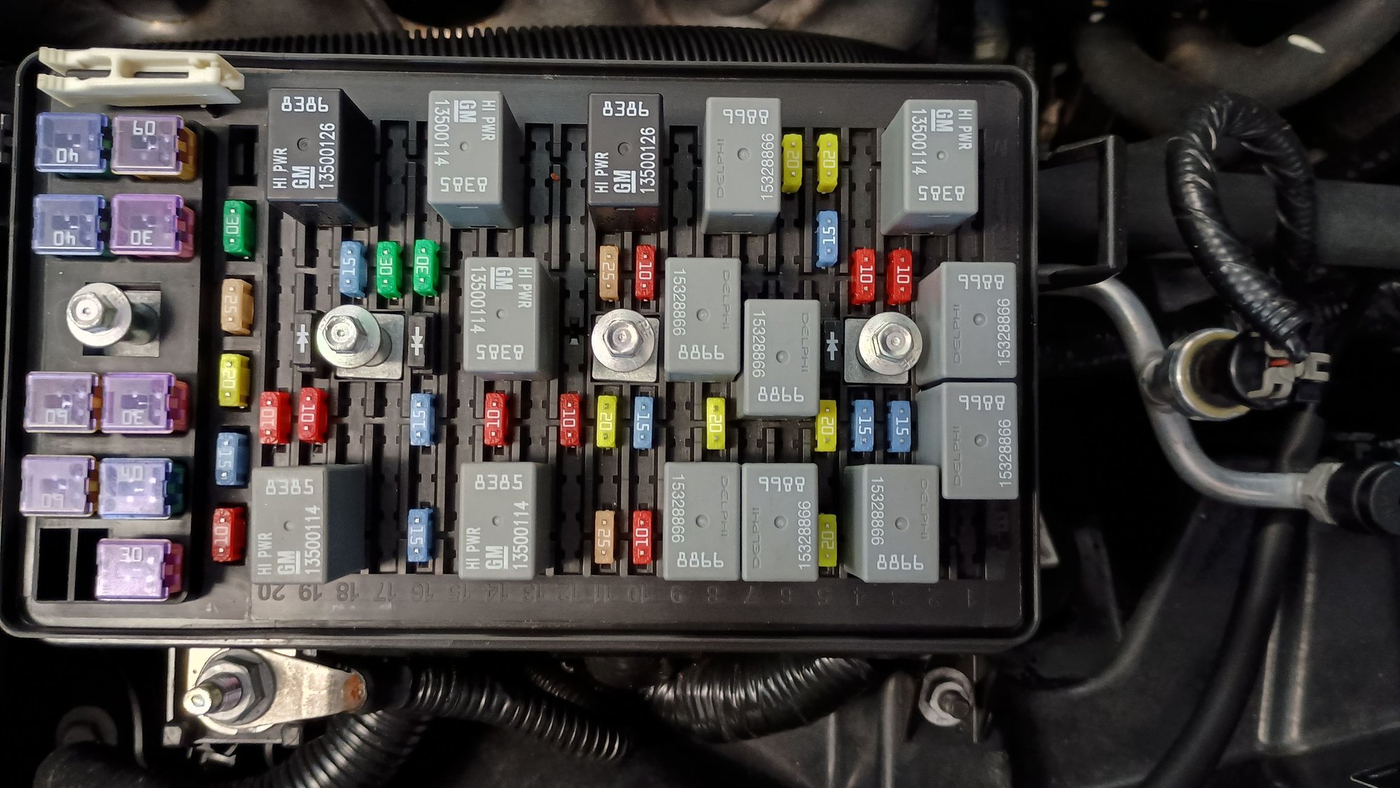

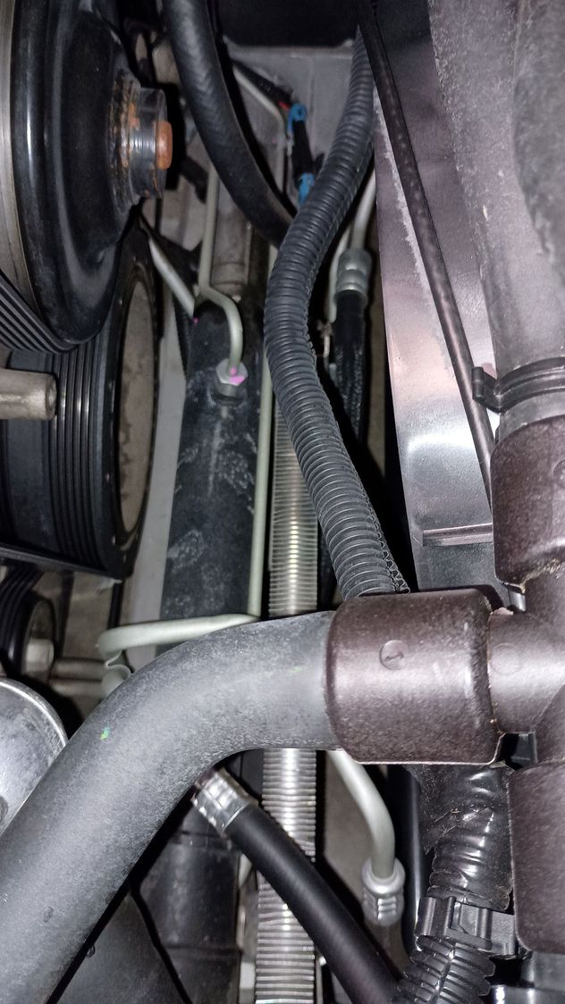

Then, just for fun, does anyone see anything odd, missing, or extra in these pics of the front of the engine or in the fuse box? I see Delco plug wires, no headers, stock down pipes, no dual cooling fan set up, engine temp runs in the 180-200 range.
Front of the engine.
Fuse Box

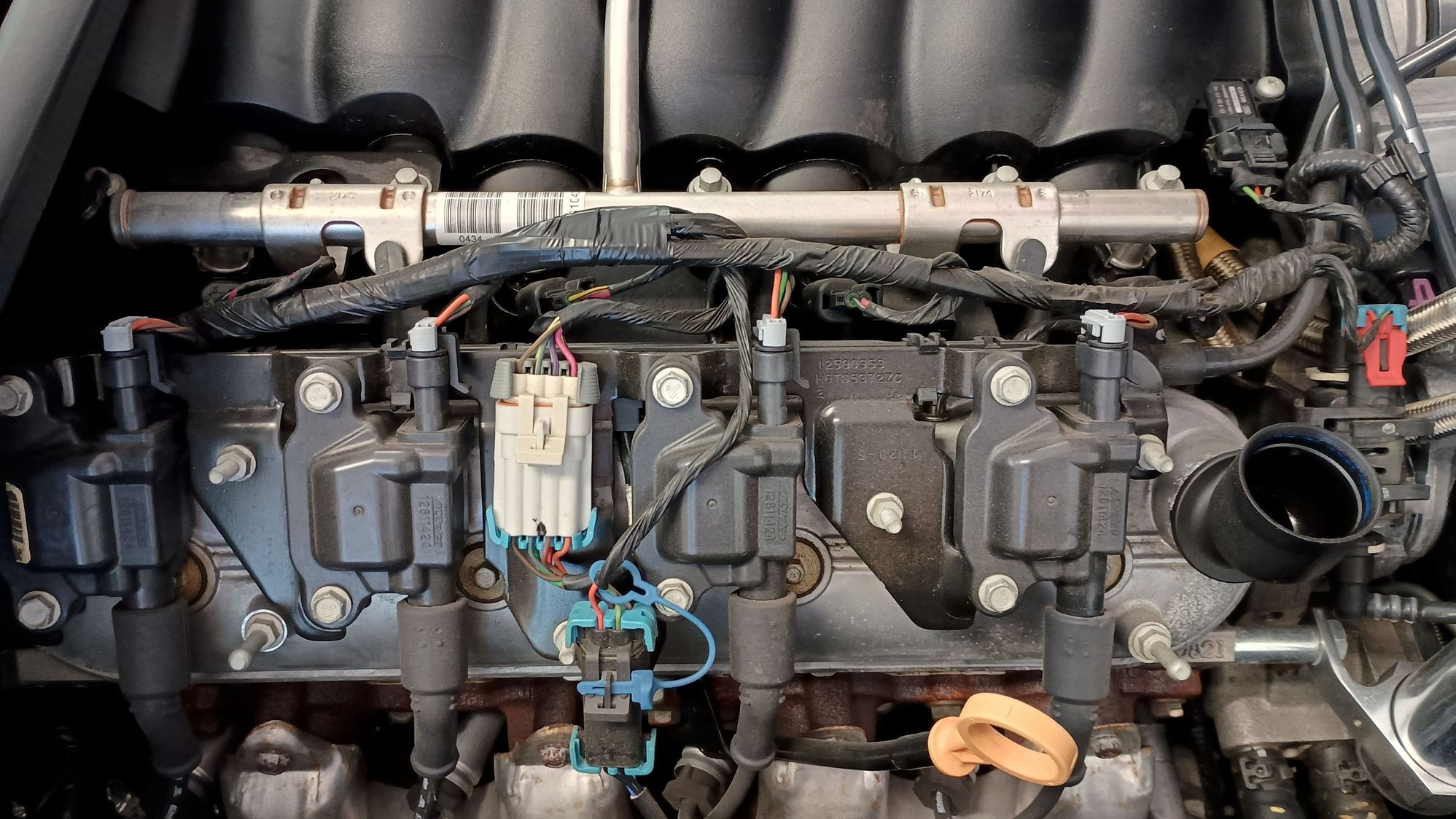

One more pic, I pulled the passenger side engine cover, it all looks stock but again, not the expert.
Under the passenger side engine cover

Looks like your current intake is an aftermarket intake and the original was removed. The original with that large side box (Hemholtz chamber) is very good to begin with. Those walls on either side of the intake are not stock and yes look to be to try to block engine heat from the intake.
That cylinder on the passenger side does look like a catch can.
Everything else looks stock.

Yes to all what you think they are, and this,
Is the factory air intake resonator, to keep the intake quiet.

A slight overfill on the dipstick is not an issue. People often add a little extra oil when hitting high rpm's or in performance driving events. The fuse box looks normal.

Probably just me but that plug wire on the first coil looks like it's about to come loose
Old Aug 27, 2024 | 01:13 PM
gdmoore01's Avatar
gdmoore01
Joined: Apr 2016
Posts: 1,285
Likes: 609
From: DFW Texas
That is exactly what I saw. Should check all of the plug wires to ensure a good secure connection with the coil on both sides. These cars have a problem with dropping the wires off of the coil pack.
It happened to me.
