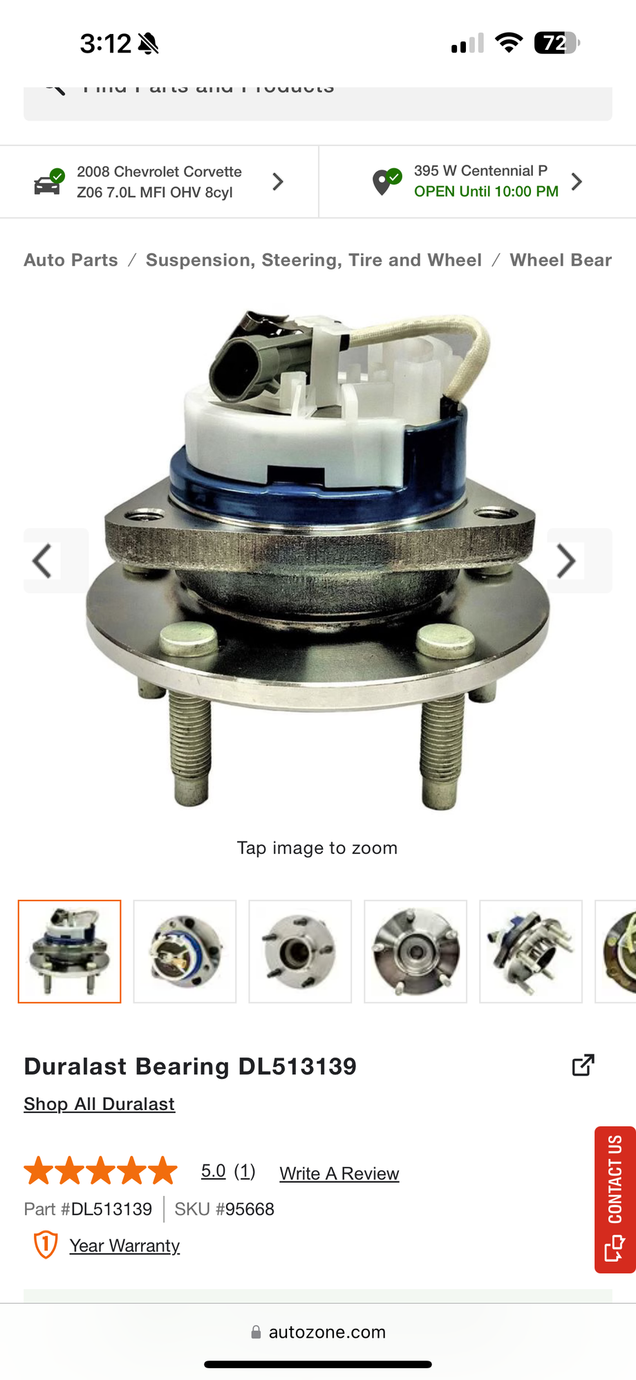

Local dealers did not have FRONT hub in stock, so I went with an Autozone part:
I just looked up this exact part number and listed the car as a 2011, and it says it’s not compatible. This leads me to believe I have the correct part.
513139 should be the right part number for early ABS.
