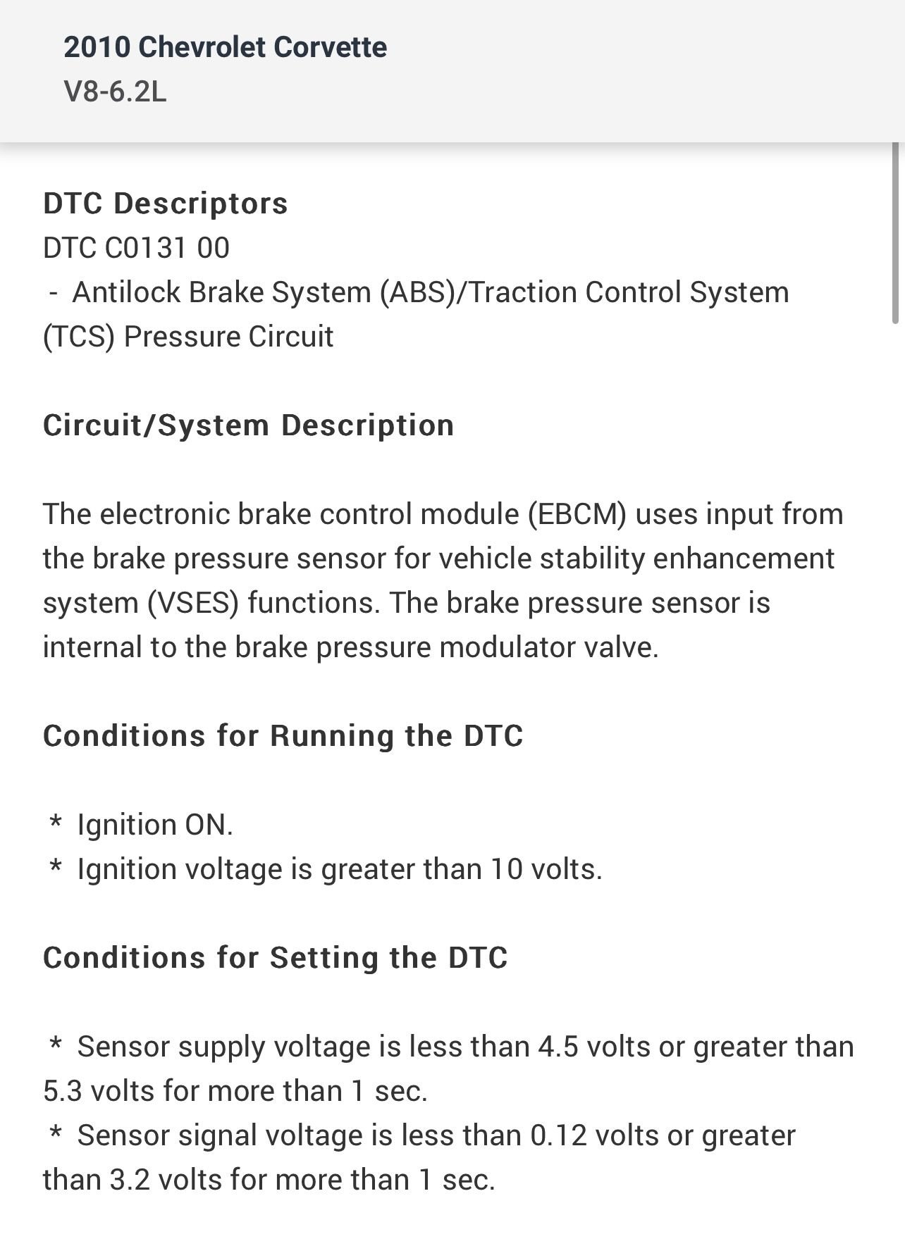

The picture is what they said about the issue. Found code C0131.

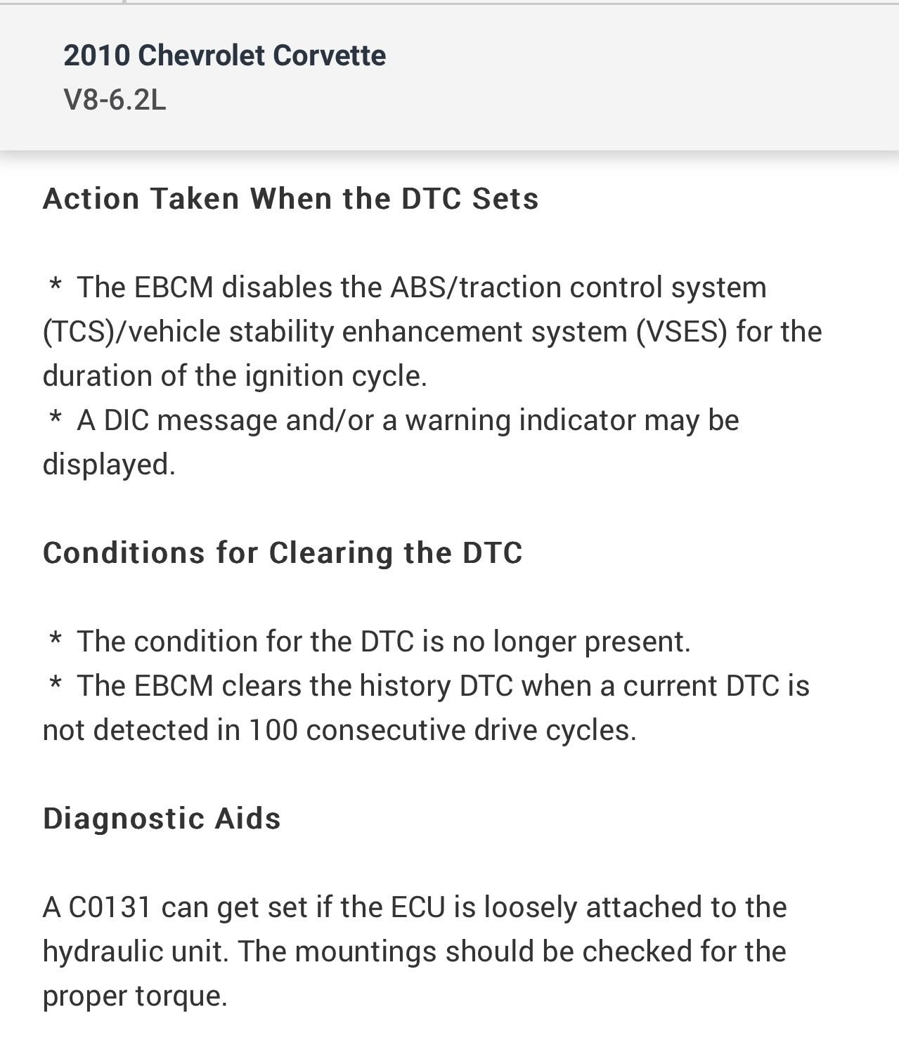

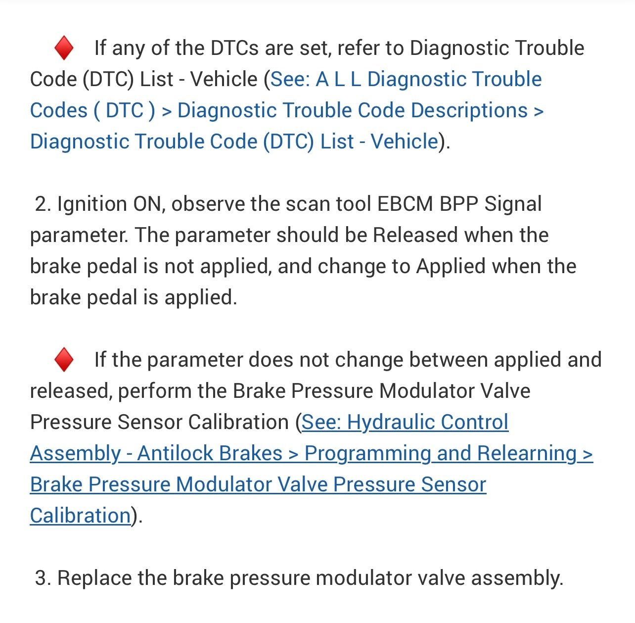

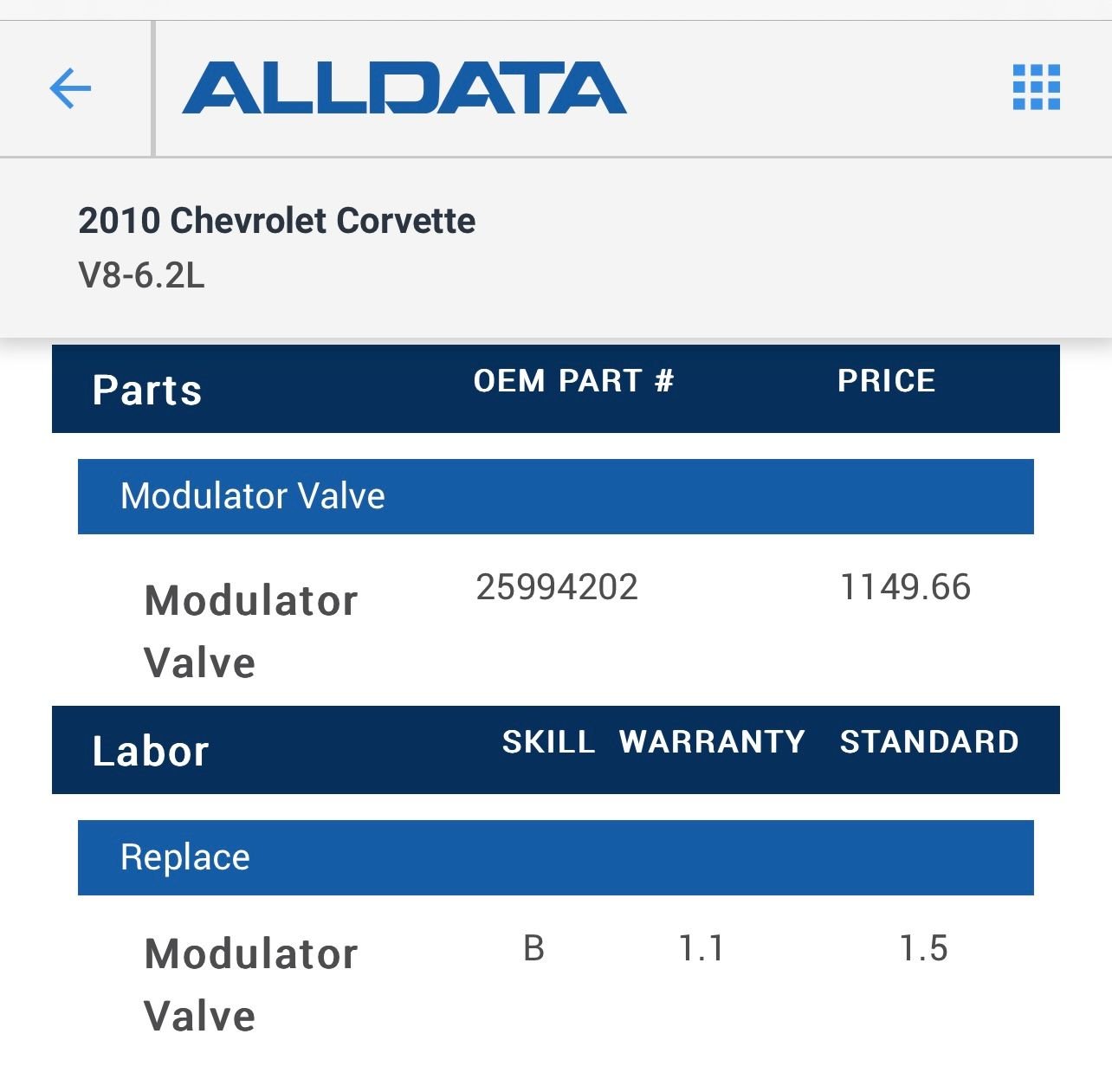

Not to much info on this DTC…here is some info from Service Info but I’d still have another shop look at it…price is pretty steep for OEM…as usual per your RO the dealership follows their “flow chart”…they can’t think for themselves as far as diagnosing.

As many electrical glitches as these cars have and seeing that the warnings didn't come on for the dealership, I wouldn't do a thing. Just wait and see if it happens again. Things as unrelated as a loose plug wire can throw those codes.
