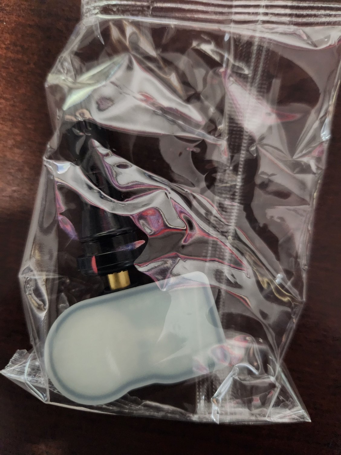

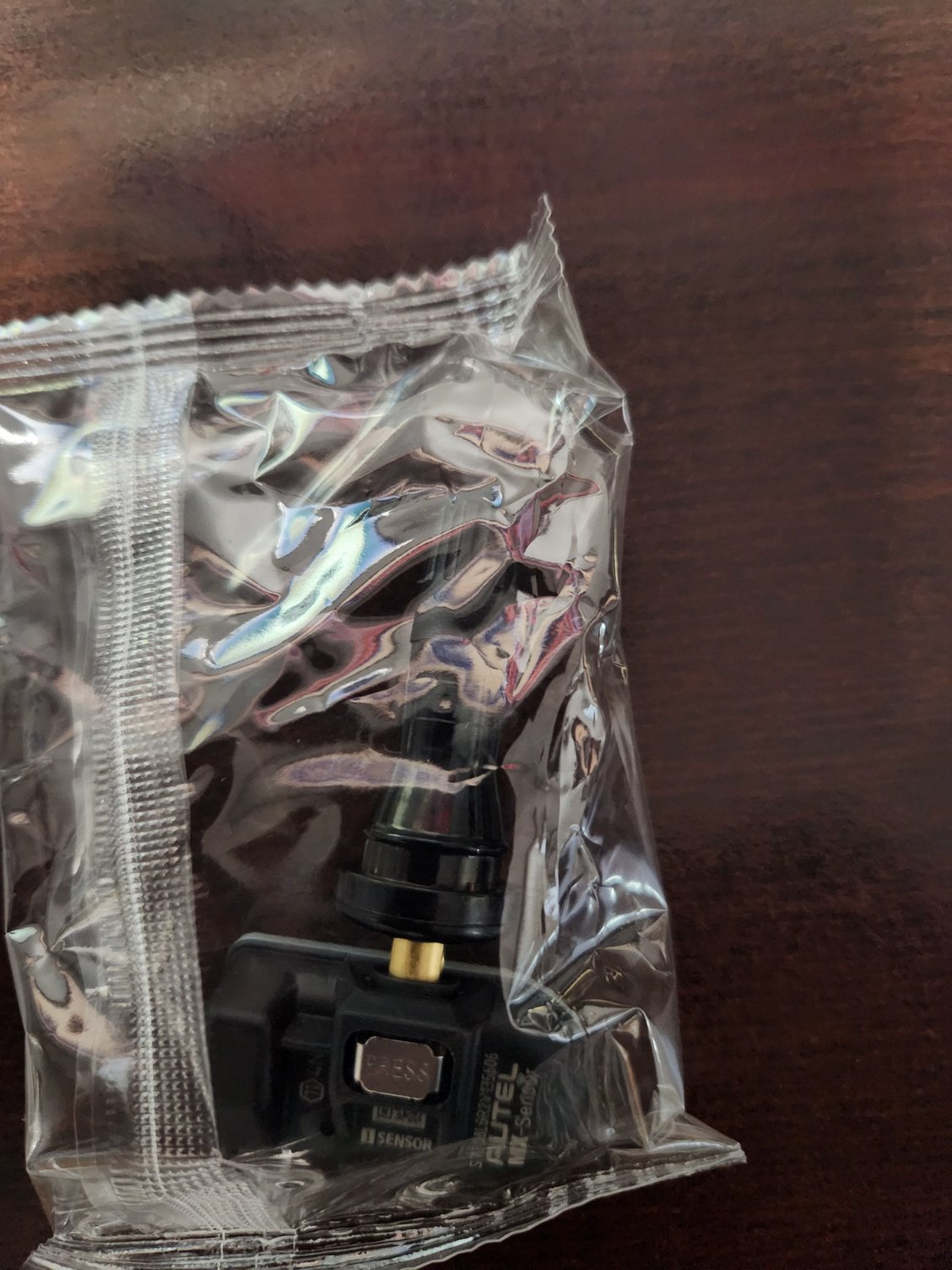

Thanks. I had the tires changed, and this being my first Vette that’s not from the 60’s, I wasn’t aware of the internal sensors. I can only assume that when they changed the tires, they took the sensors out of the old and put them in the new…Ya think???
They likely replaced the valve stem portion, typically called a TPMS service kit and let the original sensor.
See attached photo for a TPMS sensor.
