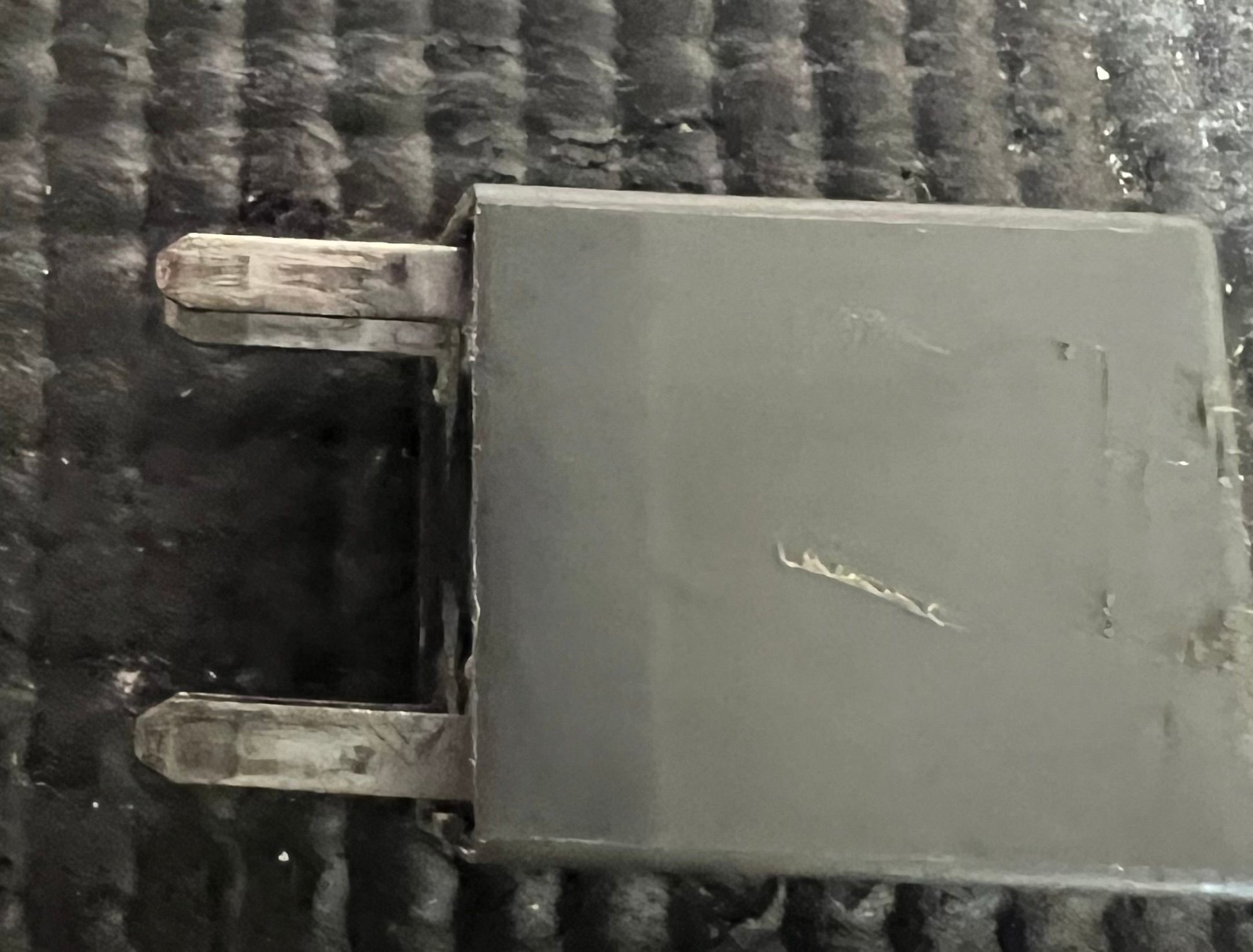

C5 Diag - I just swapped 44 relay with the Defog relay. Started right up with no mega misfire or any code relating to throttle body or tps. Stopped and started a few times and no code. Took the car for a brief run and I couldn't get it to do anything it's been doing. I did notice that some of the other relays were super-hot only after about 15 minutes - especially the fuel pump relay - and some also have brownish blemishes on the sides also. Kinda pressed for time tonight so Saturday I'll be able to highway it and really get on it. I'll let ya'll know what happens... Thanks again!!

Cool !!…so I guess you won’t be needing that new TB after all !!…and as far as testing the relay, resistance testing across the contacts is NOT the way to do it…dynamic loaded circuit voltage drop testing is and if you look at electrical testing in the Service Manual GM wants you to do this resistance testing…there are a couple things that may cause the relay to overheat…increased resistance across the load contacts and poor “terminal tension” of the relay blades…remove the relay and you should see “striations” across the blades denoting a good connection…if not the terminals are spread inside the fuse box and that will cause overheating of the terminals which will cause high resistance and lower current flow…I use a terminal tension test kit (pictured below) and make sure I have the same “pin drag” when removing and installing the correct size blade…maybe just replace the relay with new and I would go to a dealership and get an OEM relay…I replaced my fuel pump relay when I had my 2001 and it was about $20.00 at the dealer…not all relays are the same…some have a diode in them like the AC Clutch relay and some have a resistor…let us know if it’s a good fix and I couldn’t even imagine how many parts a dealer would have thrown at this with misfires and TB codes !!…I’m curious what my voltage drop is across relay 44…I’ll check it tomorrow.

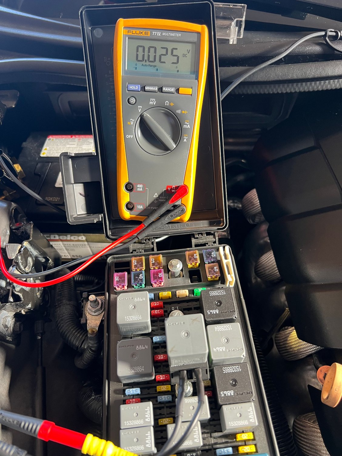

Did a voltage drop test on my Ignition 1 Relay load contacts (30 and 87) and saw a 0.025 volt drop across the contacts…wondering what yours may have been ??
