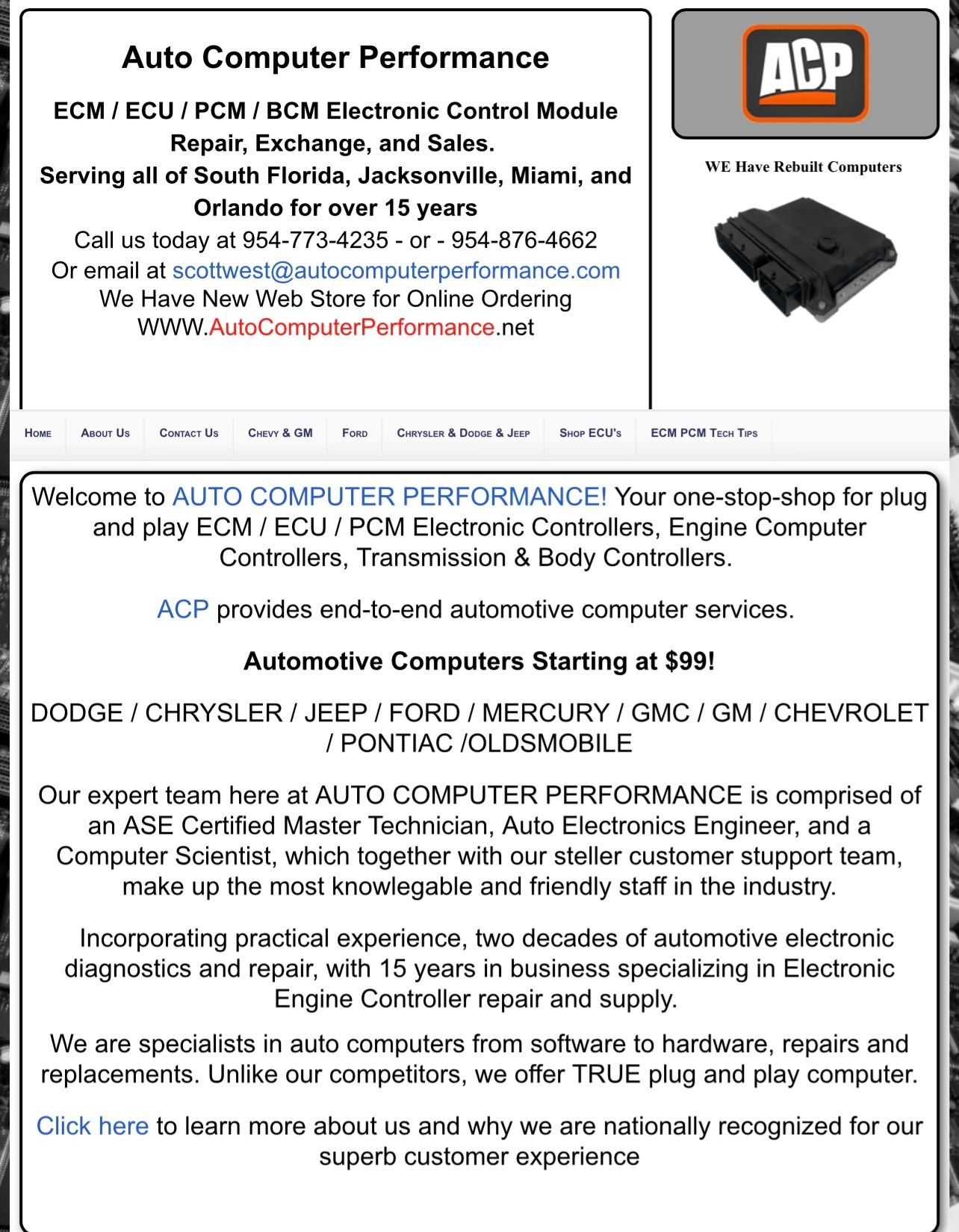

You can call this place and if they can’t do it they probably know someone who can…hope you guessed right about your BCM.

[QUOTE=C5 Diag;1608167819]You can call this place and if they can’t do it they probably know someone who can…hope you guessed right about your BCM.
Thanks for the lead, I hope I guessed right about the BCM as well. I appreciate it. I'll give them a call, and hopefully get my baby back on the road asap.

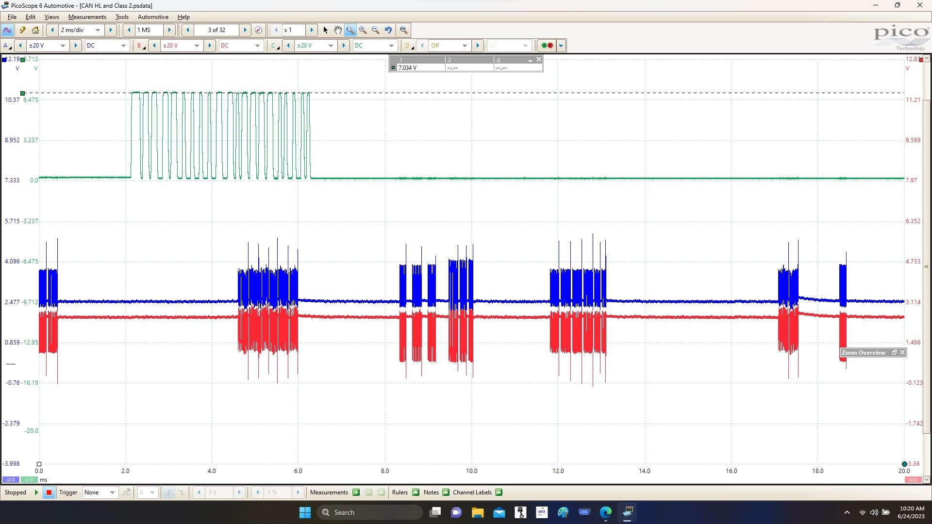

OK, well what makes you think with all those communication codes it a bad BCM ??…the modules you mentioned are all on the Class 2 Data Network which is a single wire communication network…what kind of symptoms were you seeing ??…have you installed something new like an aftermarket radio when all this was happening ??…do you have a DVOM and know how to use it ??…when a module on the serial data bus is communicating you’ll see 7 volts and when idle or not communicating (recessive) you’ll see 0 volts…with a DVOM you won’t see this 0-7 volt signal but instead a fluctuating 0.2 to 0.4 volt signal with the multimeter…below is a good data bus signal on my 08 which is the green waveform (0-7 volts) and the high speed CAN which is the bottom waveform.

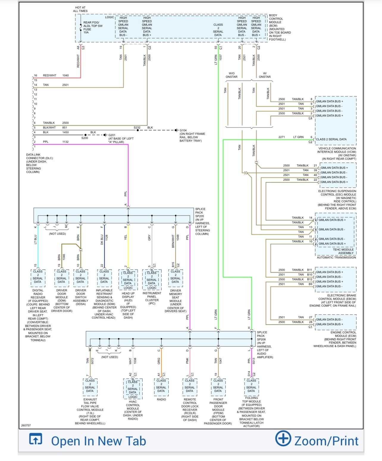

The schematic for the Information Bus on your 2007 below…the modules on the Serial Data Bus are at the bottom…Radio, HVAC, RCDLR,DDM, HUD etc…

Splice block 206 (which the wire from the BCM goes to first), located to the left of the bose amp in the passenger foot well and it can be seen at the white/green glowing device on the top left of the below photo that is clipped in place.
Splice block for 208 (wire jump from splice block 206 to 208) is located on the fire wall behind the dash gauge cluster, to the left of the steering column
