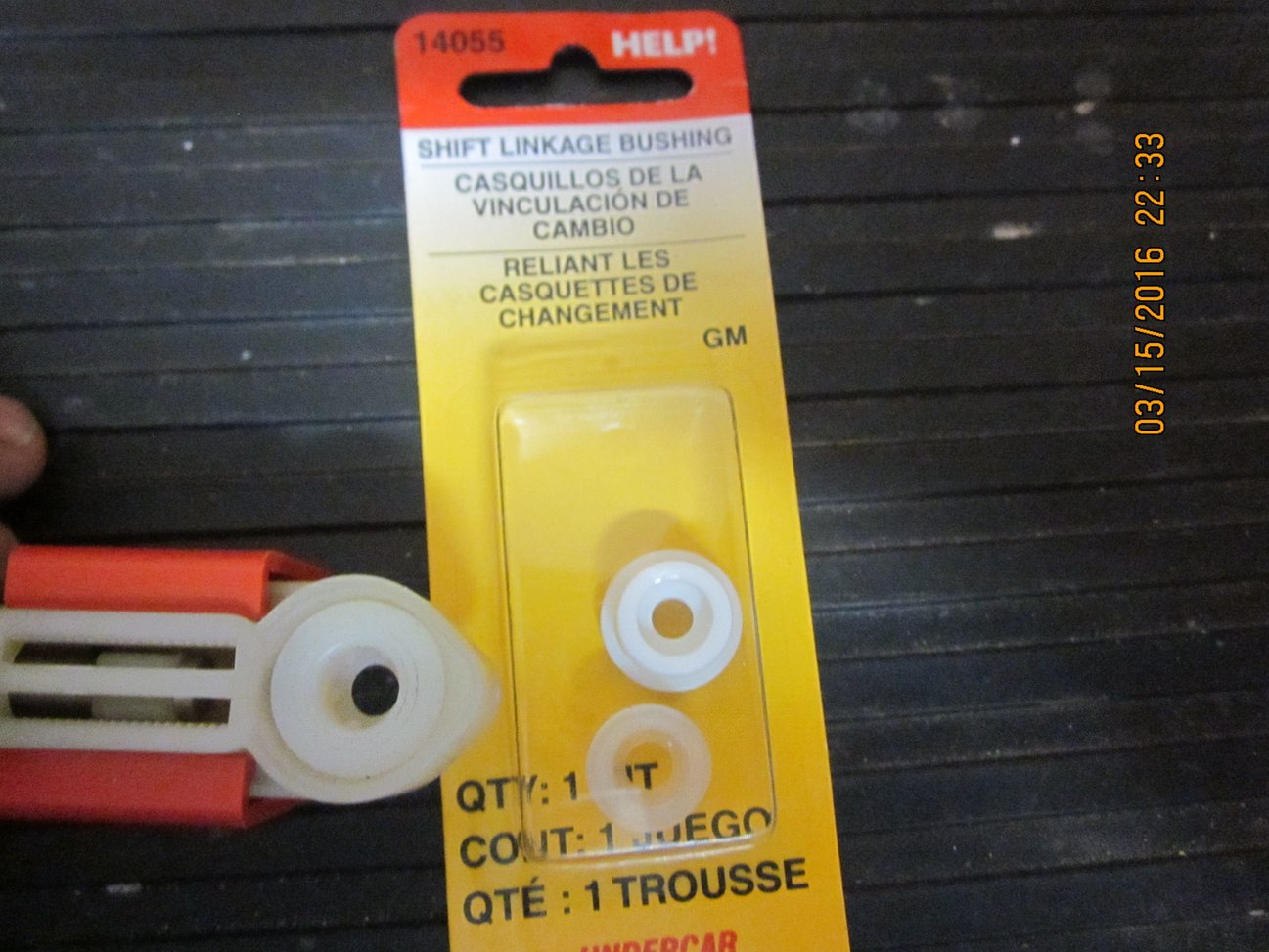

Best guess may just be a linkage issue with shifter cable, being the the end of cable grommets are worn/they need to be replaced, and possible once end grommets replaced, then shifter cable re-check for correct adjusted length (if trans is in second, but shifter is in first, then above wear/adjustment would explain why shifter arm at trans ,is still in second gear position, and not pulled all the way into first gear instead)..

Would bank on shifter cable grommets starting to go out, while when you are trying to shift into 1 with shifter, causing the cable to be too long, and not pulling the trans shaft lever far enough to get the lever on the trans all the way into the first gear detent position when shifter assembly is moved to 1st gear position.
If grommets are still in good condition, do not have play between and the shafts on the trans lever shaft and shifter assembly shaft, then pop the cable adjuster open with shifter in drive, trans lever clicked so its detent center on drive potion, then close the adjuster on the cable to adjust the cable to correct length.
Hence cable or grommets may have been replace, but you may have slight stretch in the cable over time (or not length adjusted correctly on cable replacement), and as stated, cable just adjusted too long to be able to pull trans lever into first gear detent for last of pull by the shifter assembly.
