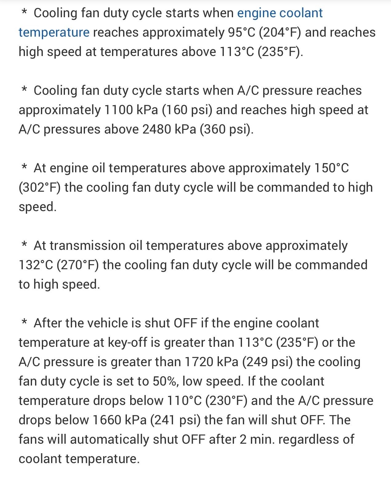

Below are the conditions that will cause the fan to run and since it duty cycled controlled it will not be running at full speed…duty cycle varies from 10-90 percent so at 10% you probably won’t hear it…did you visually check the fan to see if it is coming on or are you just going by what you hear…the fan will come on if high side AC pressure is higher than 160 psi…if your outside temp is higher than around 60 degrees your pressure should be higher than 160 psi…I’m in Florida and my high side pressure is around 220 when I start the car with AC on and it doesn’t run fast enough for me to hear it inside the car…so if your outside temp is over 60 or you have a scan tool to look at high side pressure visually see if the fan is running…if not then you have to do some electrical troubleshooting…now at low speed the fan draws a little over 15 amps…have you removed the connector and performed some checks ??…did you check for at least power and ground ??…for the fan to run properly at low speed the ground has to be able to carry that 15 amps back to the battery but many DIY’ers don’t know what a ground circuit of a car does…all they know is if I put my red lead on power and black lead on ground my voltmeter works and I see 12 volts…I use different headlight bulbs of different amperages to “load” the ground and they range from 1 amp to 6 amps…if you don’t have a scan tool to read high side AC pressure or the electrical equipment to check a circuit I’d bring your car to an auto electric shop…also on the “speed control” wire with the fan not running you should see around 12 volts and if the fan starts running you will see a little over 7 volts on that wire…revving the engine won’t do anything unless the ECT reaches 204 degrees and at that temp you won’t hear the fan…did you check the fuse ??…the fuse is a J style fuse and if you remove it or can see through it does it look blown ??…maybe take it out and put an ohm meter across it…anytime I check a J style I always see if one leg of the fuse is hot depending if it’s a battery feed or with ignition on…even though the fuse may “look” good it might not be good.
yes i visually checked, and it’s not running. i unplugged the coolant temperature sensor and the plastic looks like it’s rotted and was all cracked up, im guessing it’s from the heat of the engine and is old, i ordered a new one and i’ll replace it once it comes in. i can see inside the j style fuse and it’s not broken.
