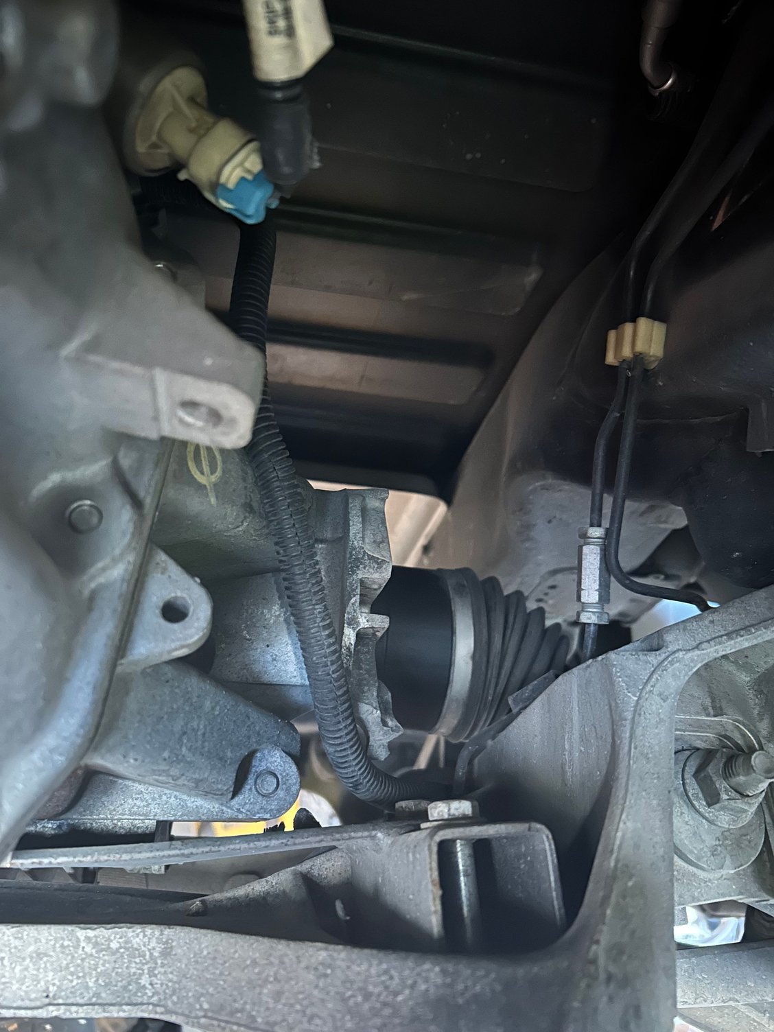

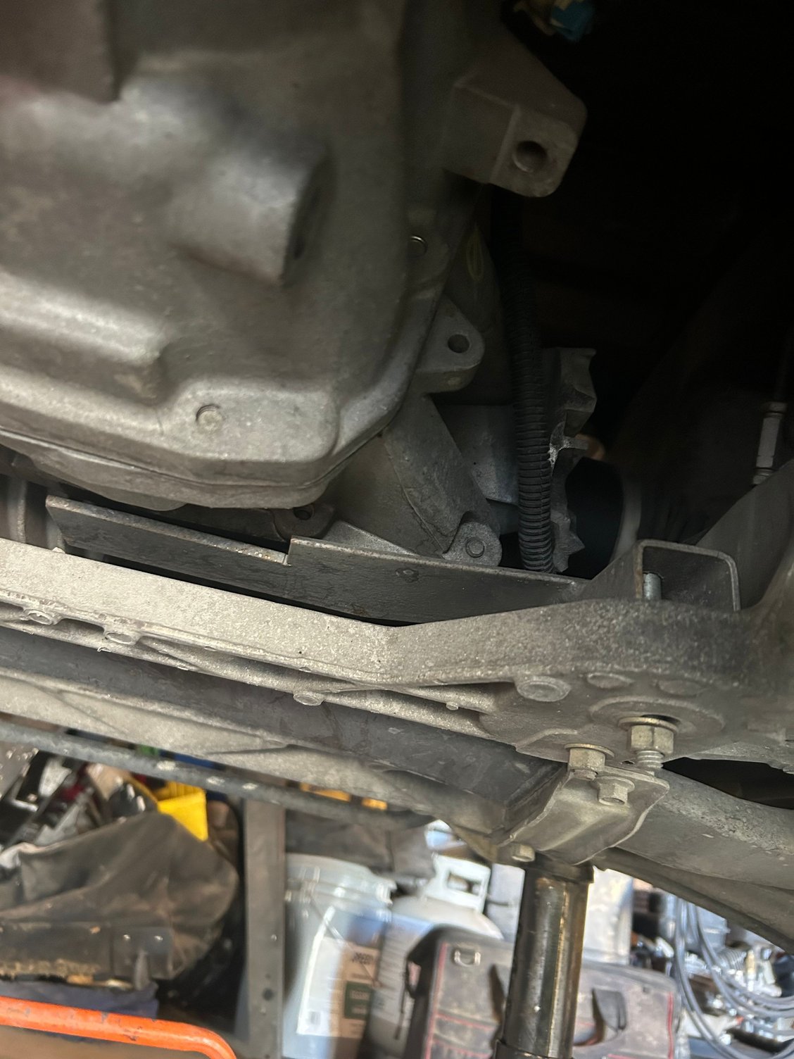

So last night I was installing my Borla ATAK cat back and that's when I noticed it. The driver side diff mount was gone, broken off of the diff cover. At first I thought it was the transmission mount but still. Yesterday is one week of owning it and it is my first vette. Someone clearly knew this happened as you can see in the photos they fabricated a bracket to support the diff. It hasn't made any odd noises like it's thumping around so that's good. I don't mind putting the time and money into this car, but I really am disappointed by how poorly the previous owner took care (lack thereof) of the car.

Does anyone have experience with this type of repair?
Can you replace just the cover without pulling the diff?
I have seen photos of side covers on differentials that don't appear to have the mounting foot on them, is that a different style for the Z06/ZR1?
