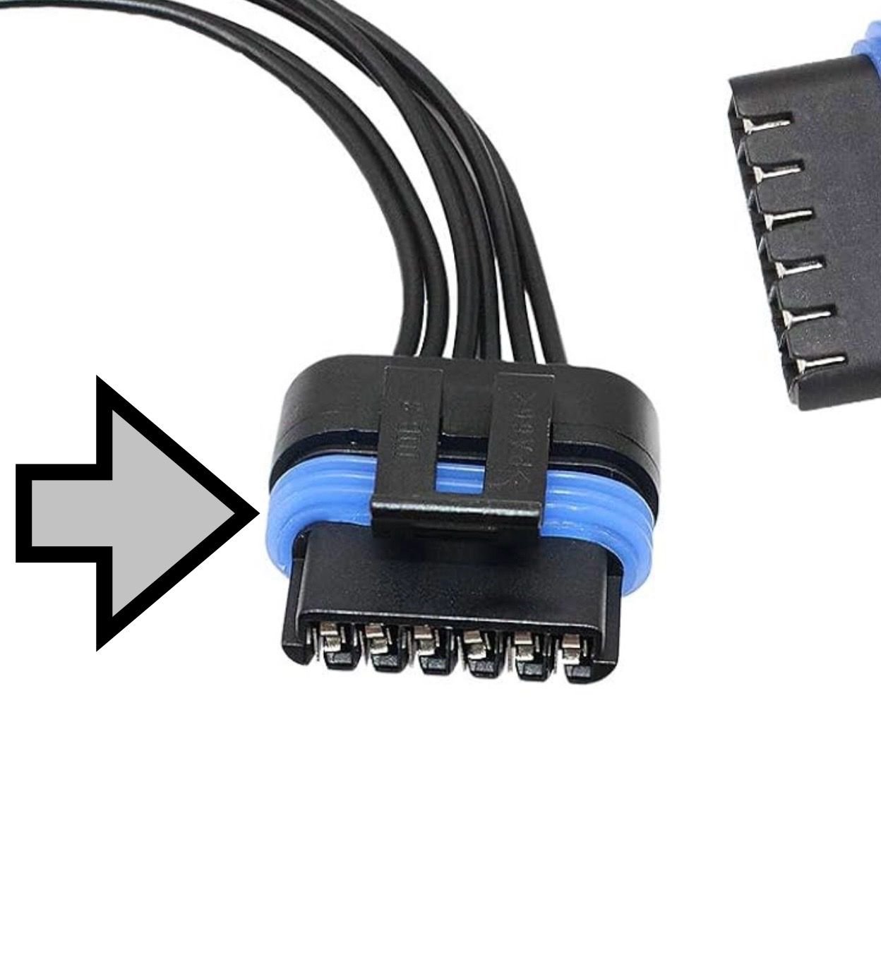

You are probably having a water intrusion issue in your TPS sensor connector…remove the connector if it goes into REP again and see if water is in the connector…what Corvette owner goes through a car wash ??…you can try getting some dielectric grease and coat the rubber seal...the weather pack seals may also be leaking.

Yep. 99% of the time, when the C6 goes into limp mode, Code is going to point to to either the Throttle body sensors or the accelerator pedal sensors.
Both of these have two sensors each (think restat pad and swiper arms) and as the vane or pedal is being moved, the two sensors in each sensors work backwards against each other (one has rising rate, the other has lowering rate), and when these sensor per TB or pedal movement do not jig in movement.sensor feed back to each other, going to put car into limp mode.
So since is sounds like problem is only under the hood with water, then either connector problem at the TB, maybe at the ECM connector, or fray problem in the wires between the two connectors.

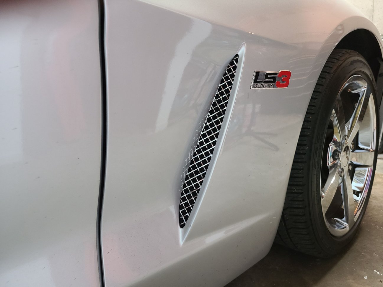

Water to the ecm, and it connectors, is an easy thing,
Since the front fender vents allows water to shot right into it the BCM location when washing the car.
As for ecm connector, although it has the rubber ring on it that kind of seals that side off to the outside of the connector socket, its the wire side of the connector that can allow water to enter into the connector as well.

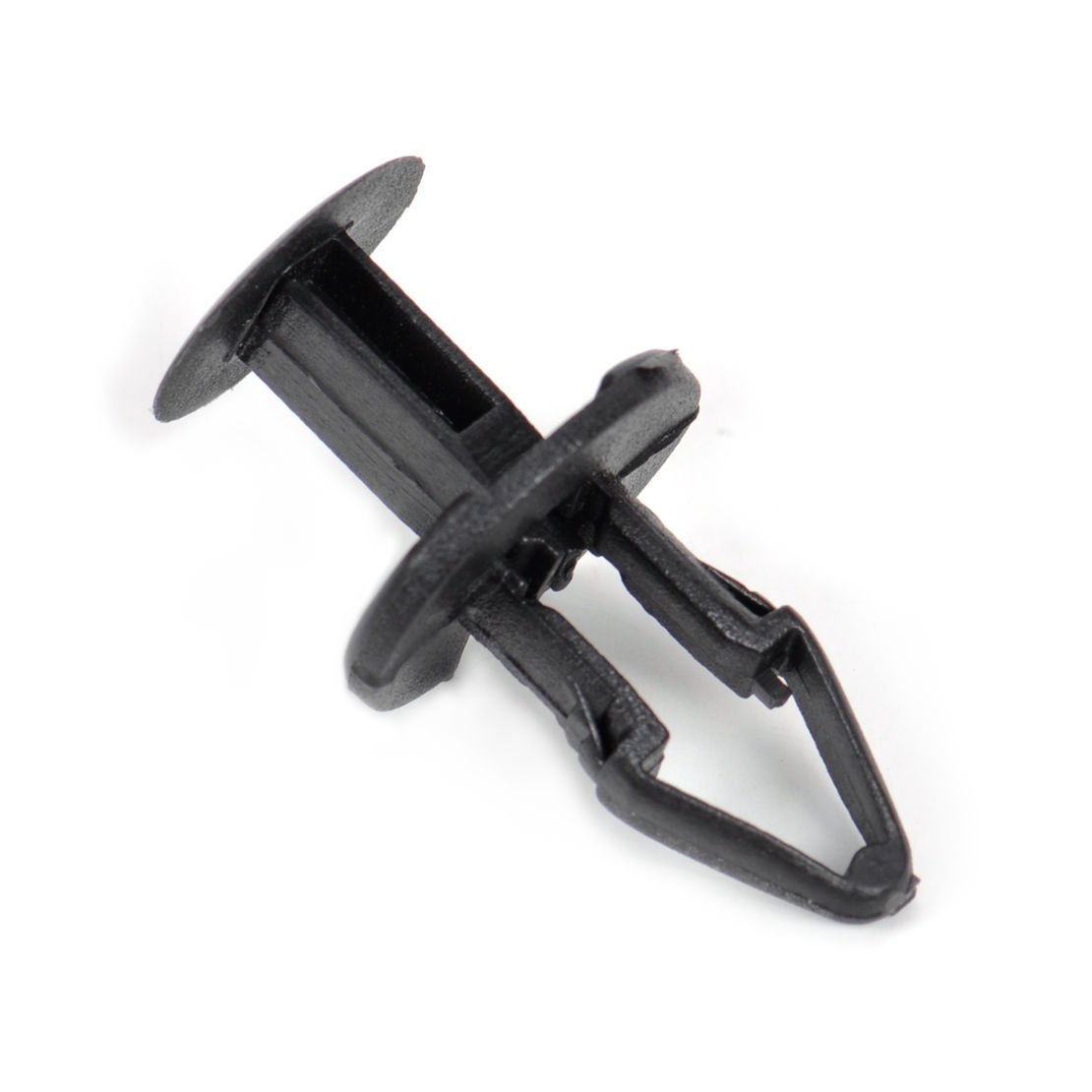

As for getting to the ecm, do not need to remove the fender, just jack up the front passenger side, remove the tire, then on the back side of the fender well, will see the rear assess panel that has plastic center tab rods that you need to pull out to remove them, and under the car, will have 3 bolts that you need to remove on the bottom of the panel to remove the filler panel.

From here, can get to the ecm connector to release the cam locks to disconnect the connector from the ECM, use spray electrical cleaner to clean the connectors and pins, use silicone grease on the outer rubber seal gasket for the connector, and where the wires go into the back of the connector, again with silicone grease to seal them off as well. Some will say don't, but myself, tend to spray the connector and pins down with light coat of silicone spray, to help keep the connector from corroding long term if water or moisture does get to them.
