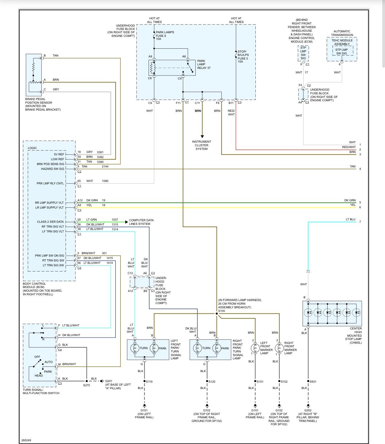

06 3LT c6 corvette
the headlights, break lights and reverse lights work fine. However, when my headlights are on the rear taillights and plate lights don’t work. I can’t figure out which fuses they are if it even is a fuse problem. Any suggestions or help would be appreciated
