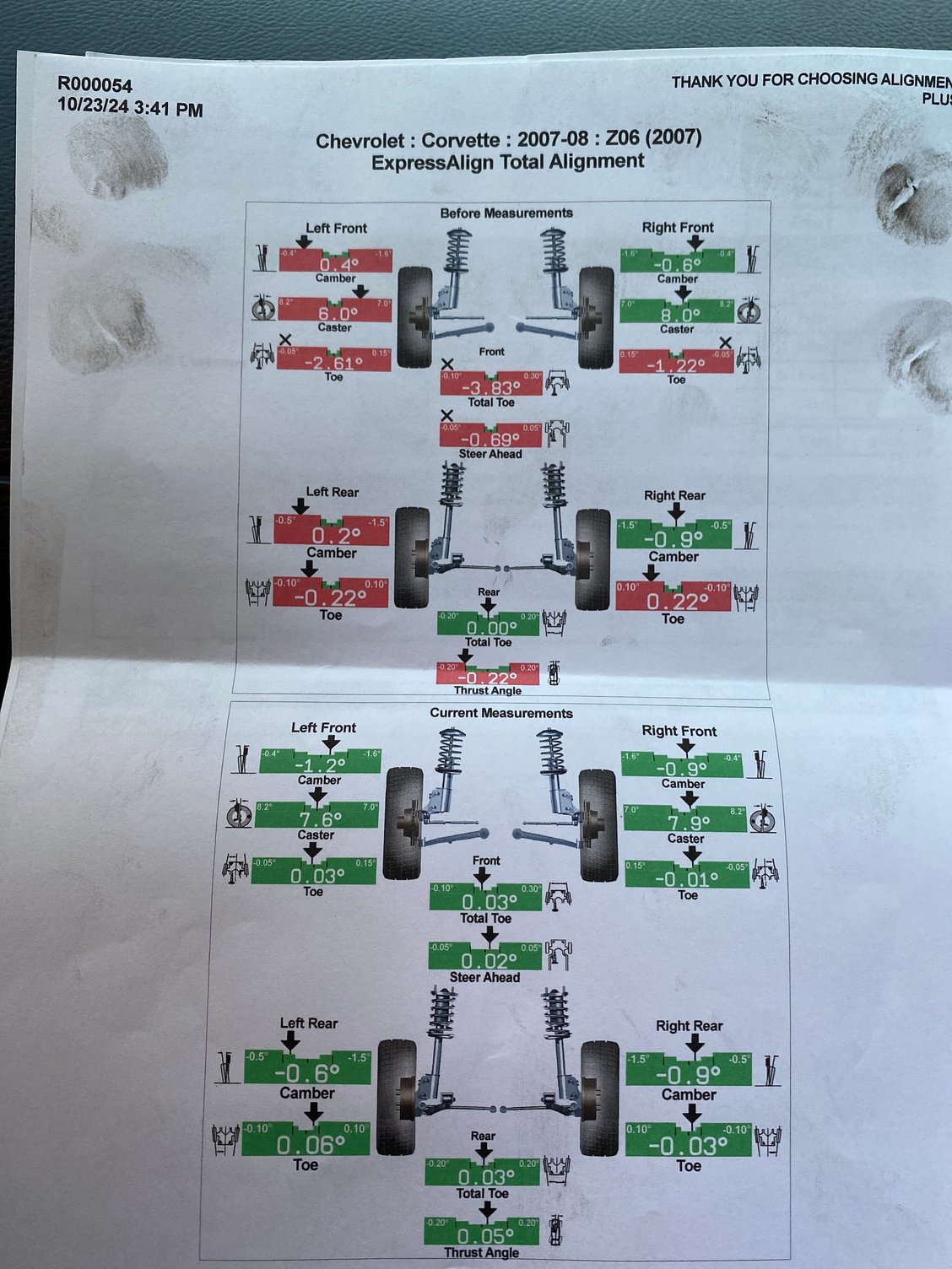

Got my car back today! New (to me) rack and outer tie rods in it! With the new parts in it my speed sensitive steering is much much more noticible (not sure it worked before at all). It is definitely different lol. First impression, not sure I love the new steering feel, but from what I could tell off the forums, this is what it is supposed to feel like. Much heavier than what I am used to, but maybe it will grow on me.
Old Oct 23, 2024 | 06:45 PM
andrewbass's Avatar
andrewbass
Cruising
Joined: Oct 2024
Posts: 10
Attaching my alignment sheet.
