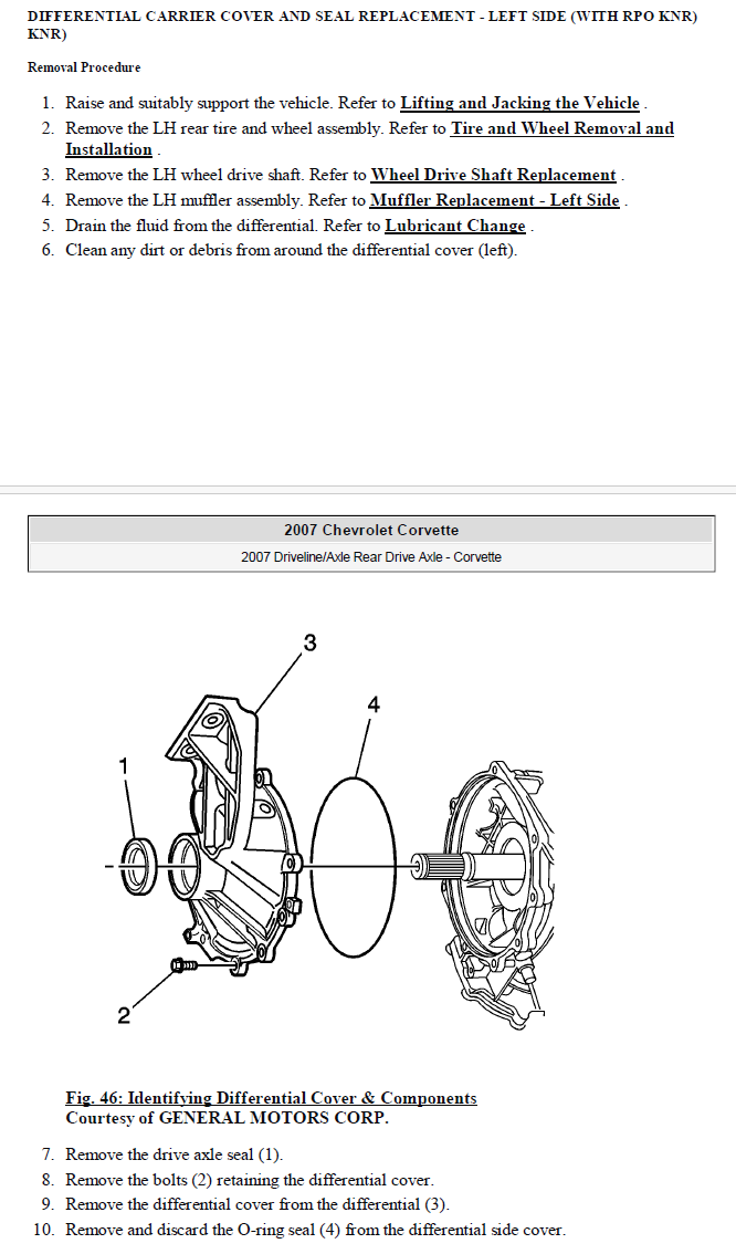

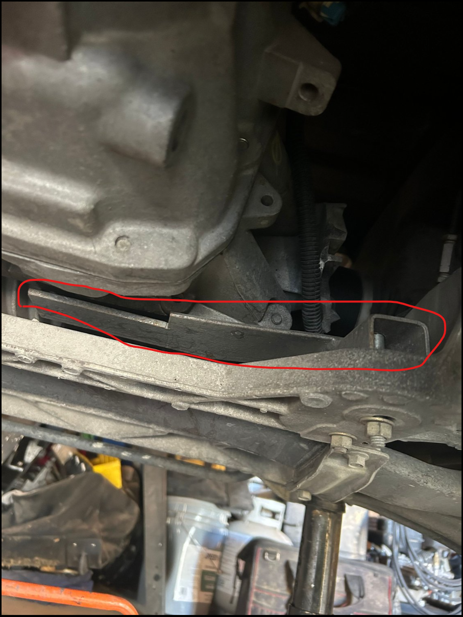

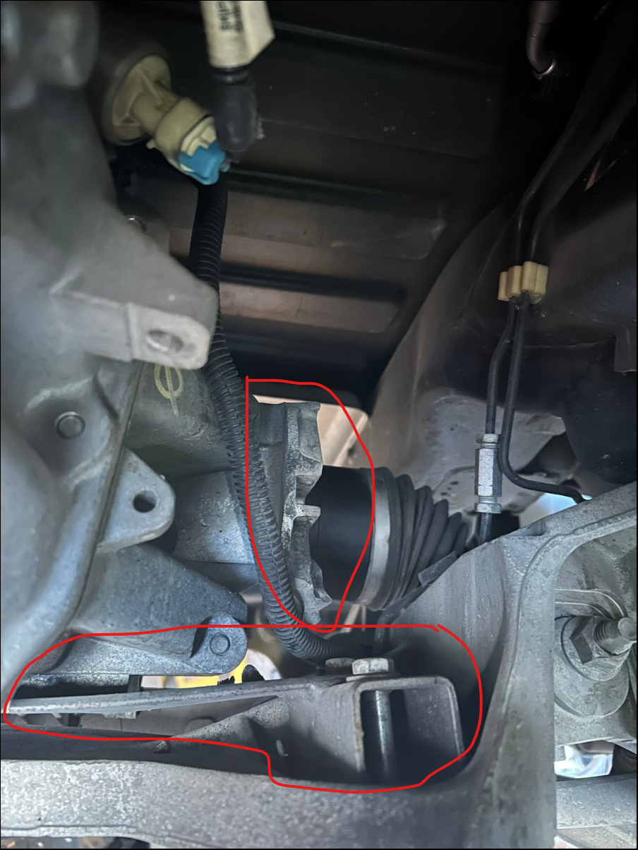

So this weekend I will be putting the car in the air and replacing the driver side differential cover that has a broken mount. I have already received the new rubber mount, AC Delco diff fluid and pump, and diff cover seal. The ebay diff will be arriving Friday, along with axle seals. From the shop manual I have this should be a breeze to do and I will not need to remove the subframe or differential to do this.
Any input from those with experience performing this is welcomed.
