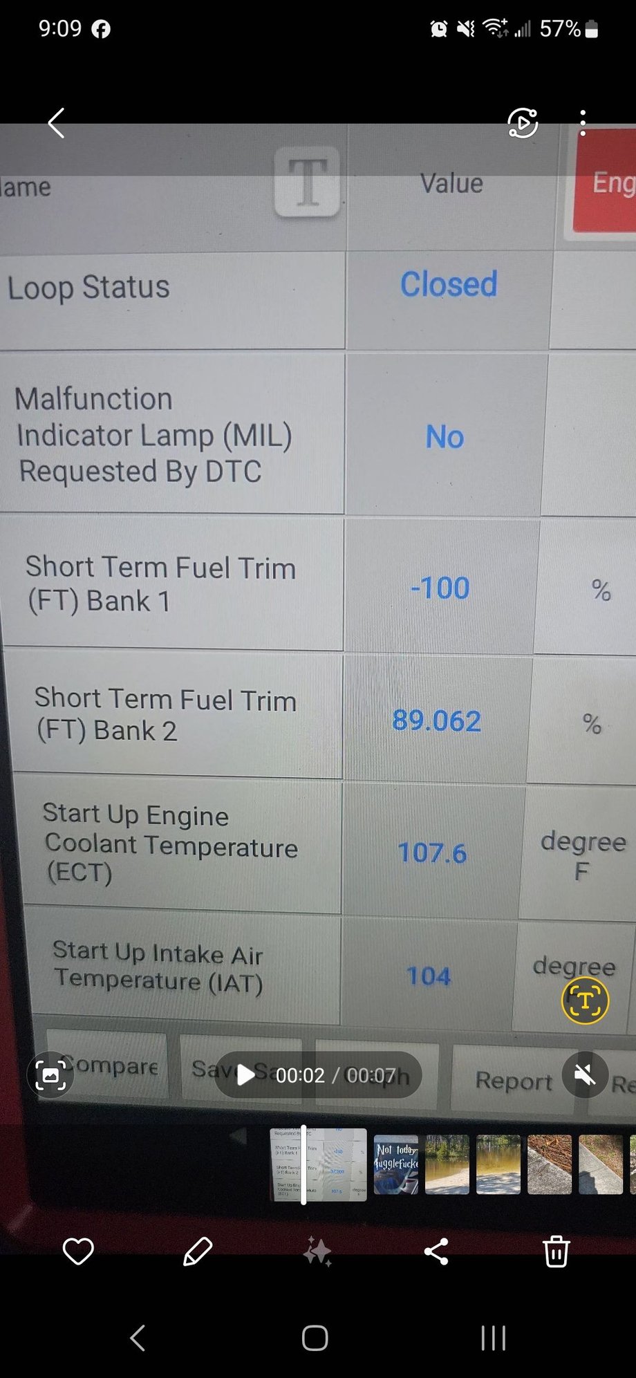

Today the car seemed to run rough all of a sudden. Fuel trims are way out of whack, i did a fuel trim relearn and will check tomorrow after driving long enough to set the monitors but one bank pegged at -100% that doesn't sound possible. Check engine light works, no fault codes and misfire counts are zero current and history. Is my scan tool reading something wrong? Am I misinterpreting the data?
Take a screenshot of your scan tool data.

Old Oct 29, 2024 | 10:16 PM
C5 Diag's Avatar
C5 Diag
Moderator, Tech Contributor
Posts: 15,320
Likes: 3,927
From: Cape Coral, Florida
Originally Posted by C6VetteLover
Is this an Autel scan tool or one of the phone app scan tools ??…never seen fuel trims with those numbers…is this with the engine running ??

Originally Posted by C5 Diag
Is this an Autel scan tool or one of the phone app scan tools ??…never seen fuel trims with those numbers.
I took a screenshot of a short video of the scan tool screen. It's a Launch X431. I have access to that, a Bosch and sometimes an Autel.

I thought readings like that were impossible with the car actually running. Adding almost 100% fuel on one bank and taking 100% away on the other, all this all of a sudden. Fuel trims a couple days ago were in the 5% range. No codes in the ECM, misfire counters zero current or history.
Well the car would have to be running to look at fuel trims…what do the long terms look like ??
I know it has to be running but i meant not running so poor it barely runs. I will have to check at work tomorrow when I get a break. Still getting around 24-25 mpg average with rural highway driving.
