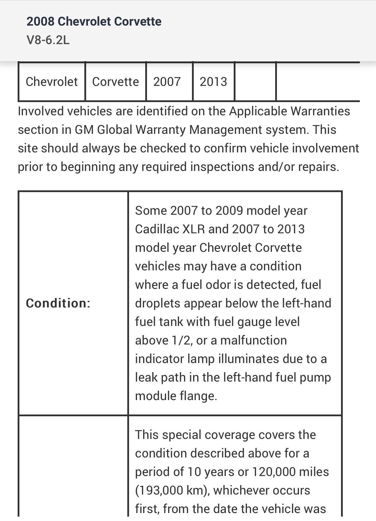

Who told you that if you fill up your tank halfway that “one” of the fuel pumps will go bad ??…there is only ONE fuel pump and it’s in the left tank and that needs to be replaced if you have a fuel smell possibly and not the tanks !!…if you keep your fuel level above 1/2 full you may notice this…this may also be a crack in the tank itself but that would have to be diagnosed…when the tank is at a half tank the right tank is empty and the left tank is full if you didn’t know that…there is a TSB for this but due to the time limit the “special coverage” for this issue has expired for C6’s…by the way it’s not a “common thing”…I have an 08 and I don’t have this issue…I’m not good at diagnosing noises so that is something you’ll have to find out for yourself…what do you mean by “car starts up like nothing” and no codes ??…does nothing means it doesn’t start ??..I may have commented on one of your posts 3 months ago concerning this sound…you said a shop smoke tested the engine and no leaks but I would expect a vacuum leak to show itself at idle when manifold vacuum is at its highest…this vacuum will decrease as the throttle blade is opened when you press on the gas pedal.

If it is indeed a crack in the fuel pump module it will be an expensive repair…you may want to have it diagnosed.
