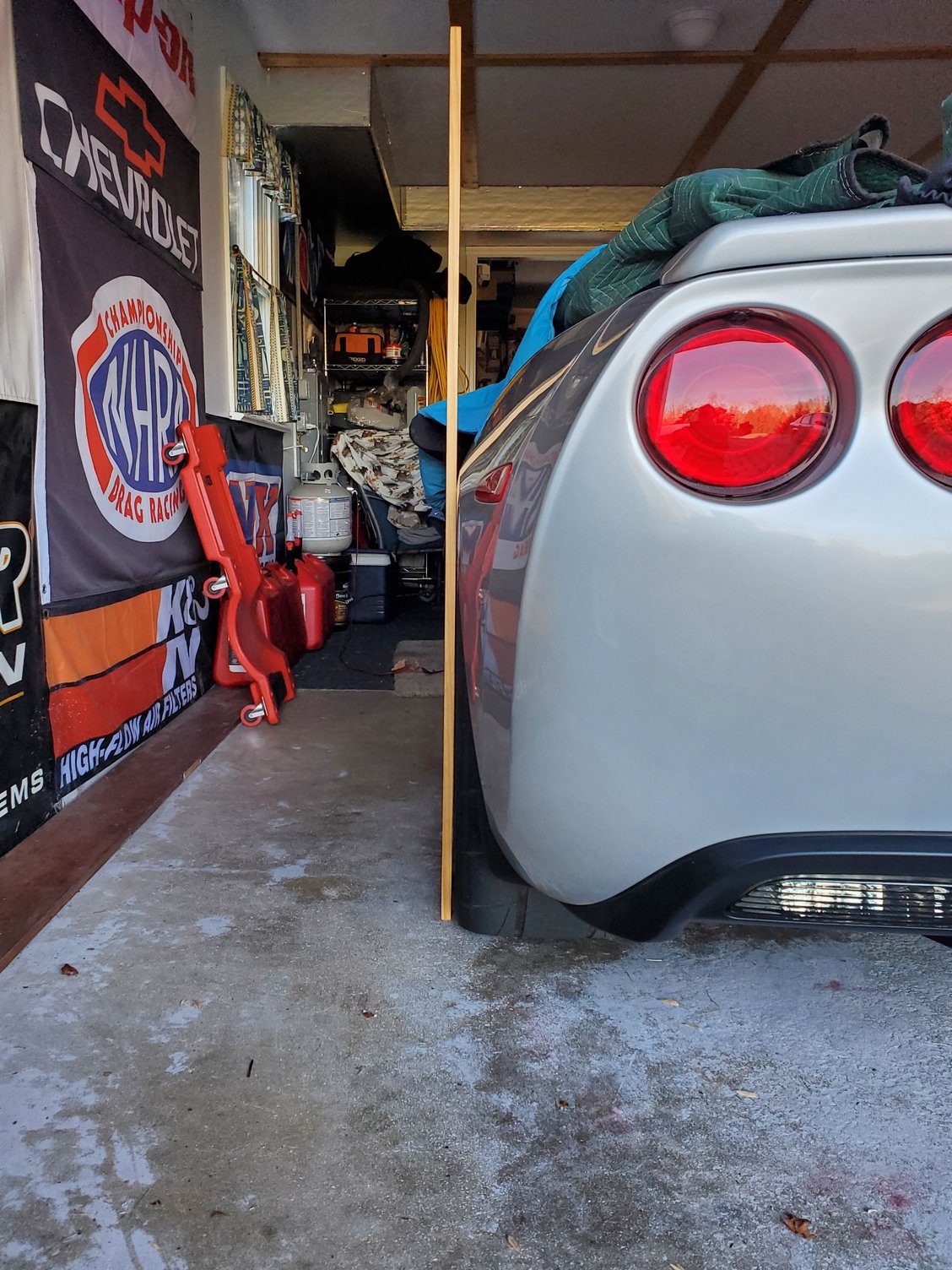

I run their SM10 on 18x11 with 315 square. Backspace and alignment help a ton. I have some poke yes, but the car will never be IG famous.
do you mind posting a photo? I was thinking of going 305 rears but worried about how much poke

bynummustang's Avatar
bynummustang
Joined: Jan 2021
Posts: 410
Likes: 76
I think in the front I'm at 2.7* camber and like 1.7* in the rear.

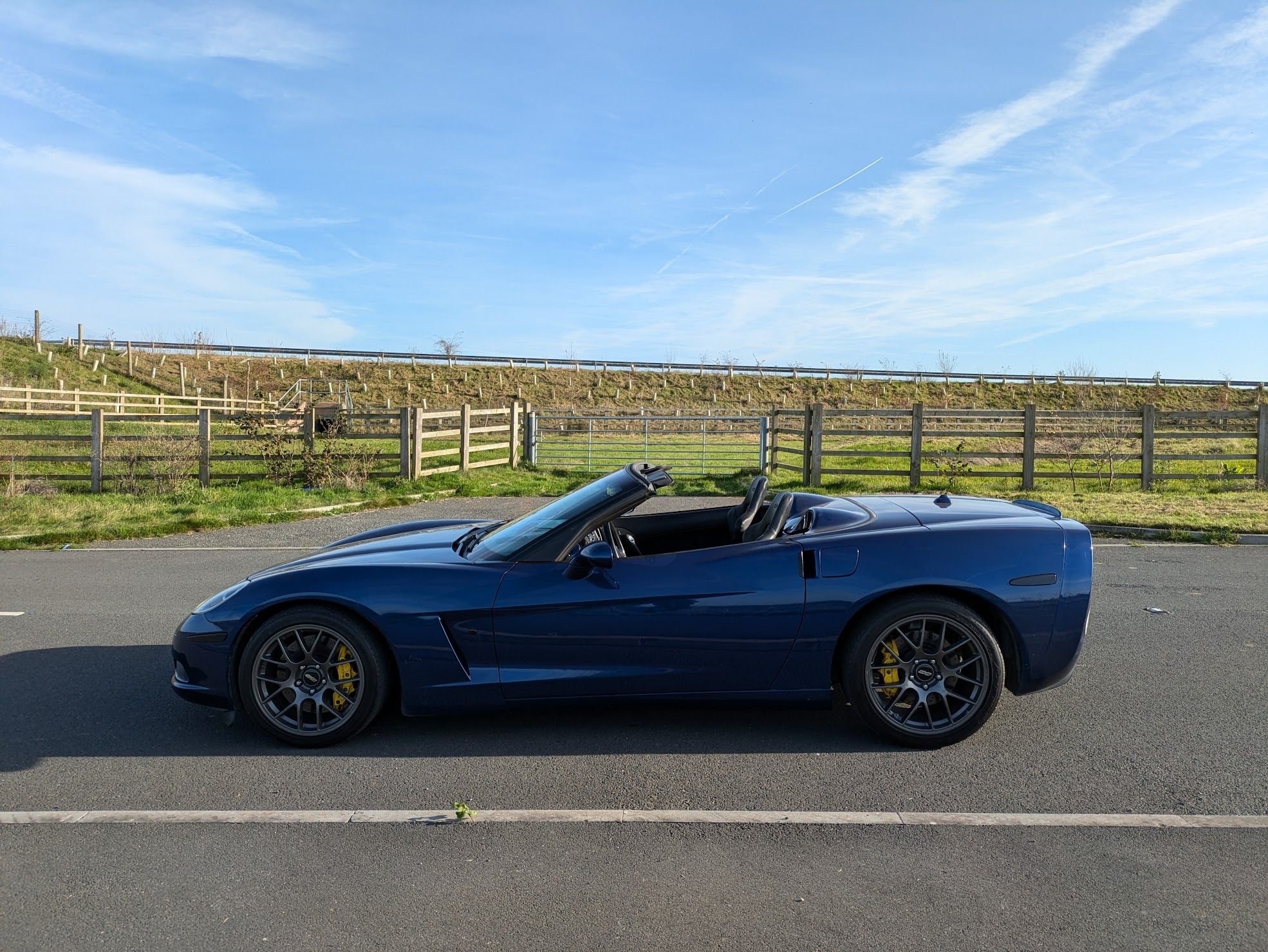

I have the EC7 on my base 18x10 19x11 using 275/35 and 295/35 tyres. I used Falkens and have to say I'm very impressed, they were half the price of Michelins which I would have chosen previously. My car is 400whp 6 speed and is driven in all weathers.
Apex were very good customer service especially shipping to the UK. I used a 1/4" spacer on the rear to clear the Z06 caliper but the 18x10 would have cleared it. Quality of the wheels is excellent, they've been on for 18 months now and seen salty winter roads, washed every couple of weeks and still look new.
