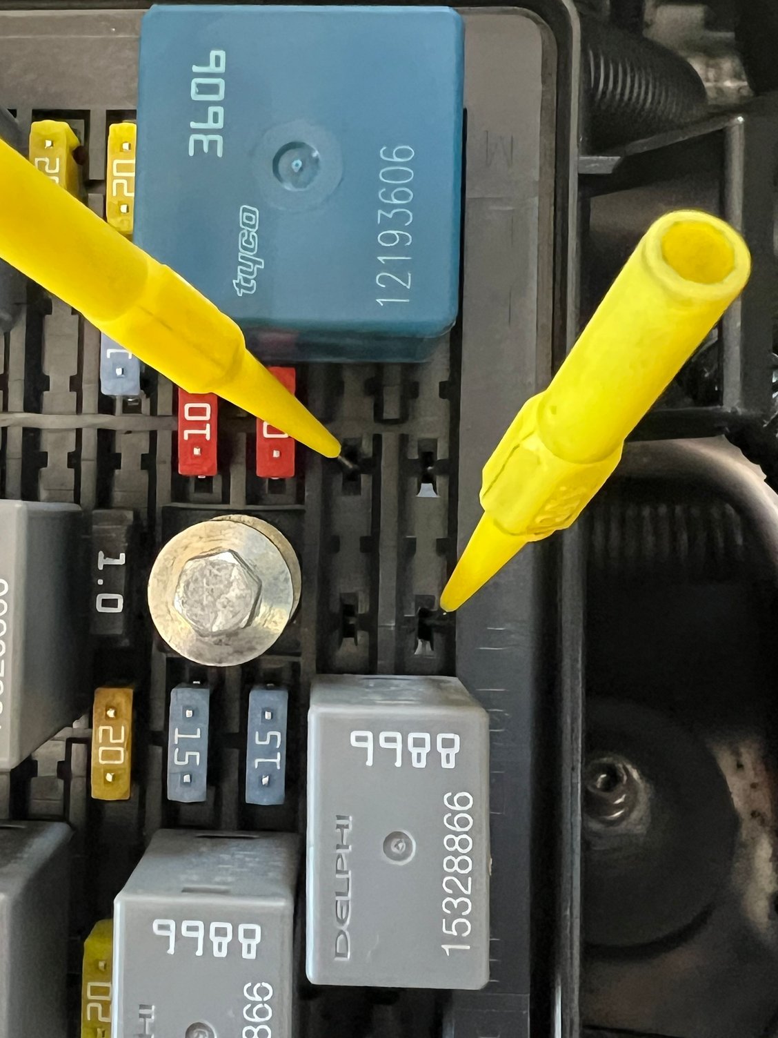

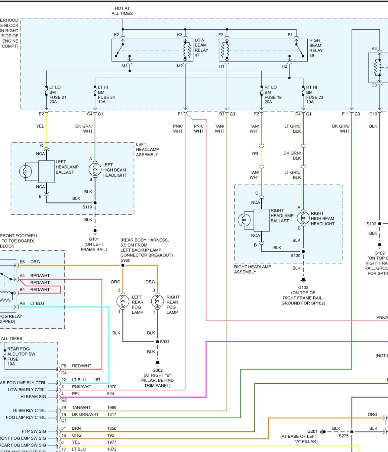

Just to see if your high beams come on can you jumper terminals 30 and 87 of the high beam relay 39…the load side is “hot at all times” so you don’t have to do anything with the ignition…when you jump those 2 the high beams should turn on…if this may be over your head guiding you step by step to diagnose this would be next to impossible…may be time to seek out an auto electric shop in your area…and don’t worry about being good at electrical diagnostics…99.99% of professional mechanics whether at a repair shop or dealership are in the same boat as you.

30 and 87 are the 2 terminals below.

You’ll be jumping the “load” side of the relay….pins 85 and 86 are the “control” side…every relay has 2 power sources…if you have a test light the other terminal which is closest to the fender should also have power…the 4th terminal goes to the BCM so we can check that later.

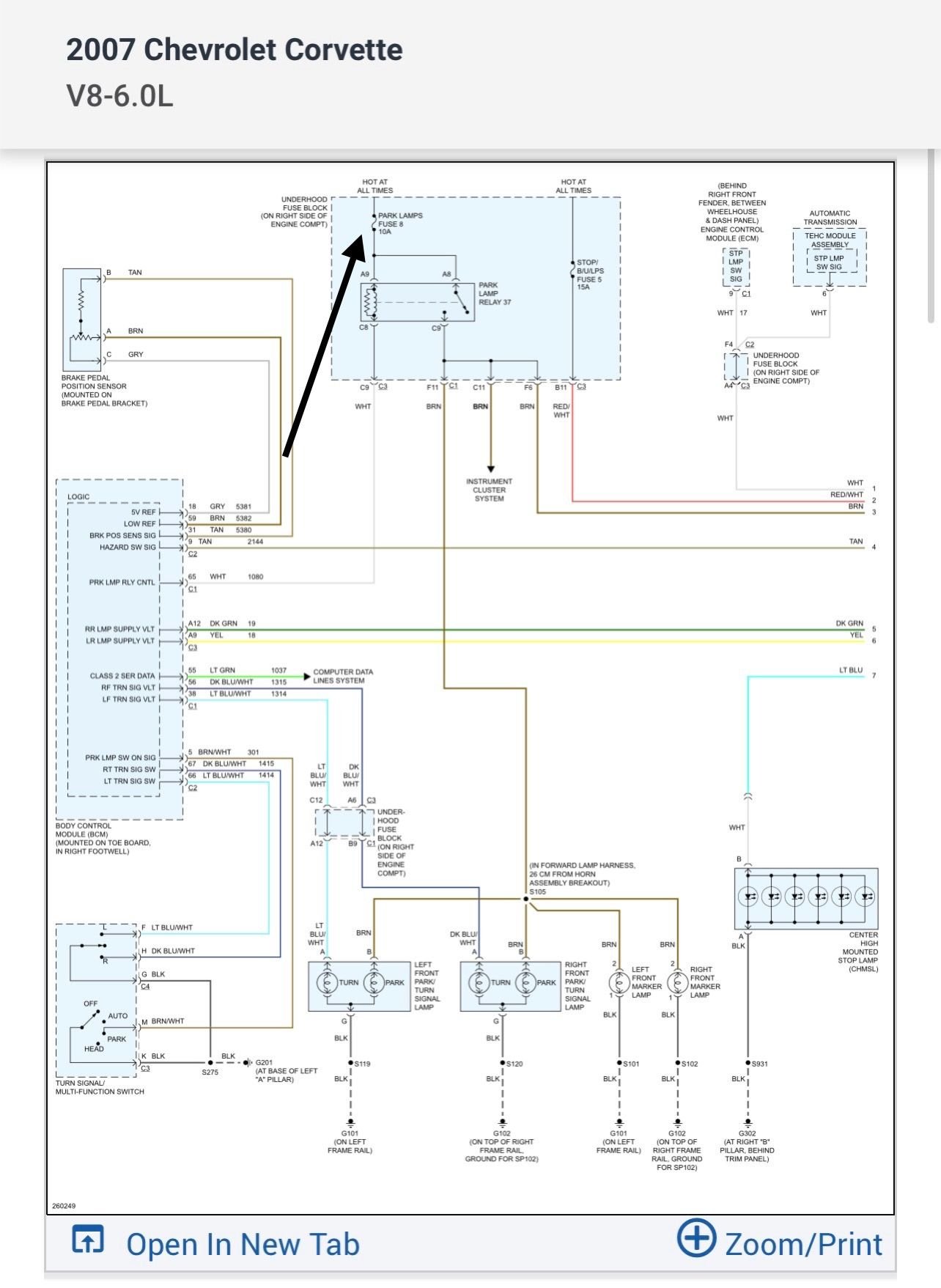

Old Nov 8, 2024 | 10:10 PM
C5 Diag's Avatar
C5 Diag
Moderator, Tech Contributor
Posts: 15,628
Likes: 4,071
From: Cape Coral, Florida

Thank you for the diagrams, I will study those! This am I went outside and tried the running lights, nothing. Went for a ride and noticed in the ride home they are back on and the high beams working. I have an aftermarket kenwood (non bose stock) with the pac audio harness. Since install the radio is hit or miss turning on with the ignition, sometimes you have to turn it off and back on. Noticed the door/ignition chime was going off double yesterday when the lights were giving me issues… hope the bcm isn’t going bad. I’m assuming it’s one of the following: fuse block, bcm, radio issue, issue with led bulbs. I had installed radioflyer’s led bulbs all around a year ago and had to remove them because they overheated and were causing electrical issues. Parking lights etc went out then… Thats why i switched back to the stock bulbs in front but went with some led’s inside the stock tails.
