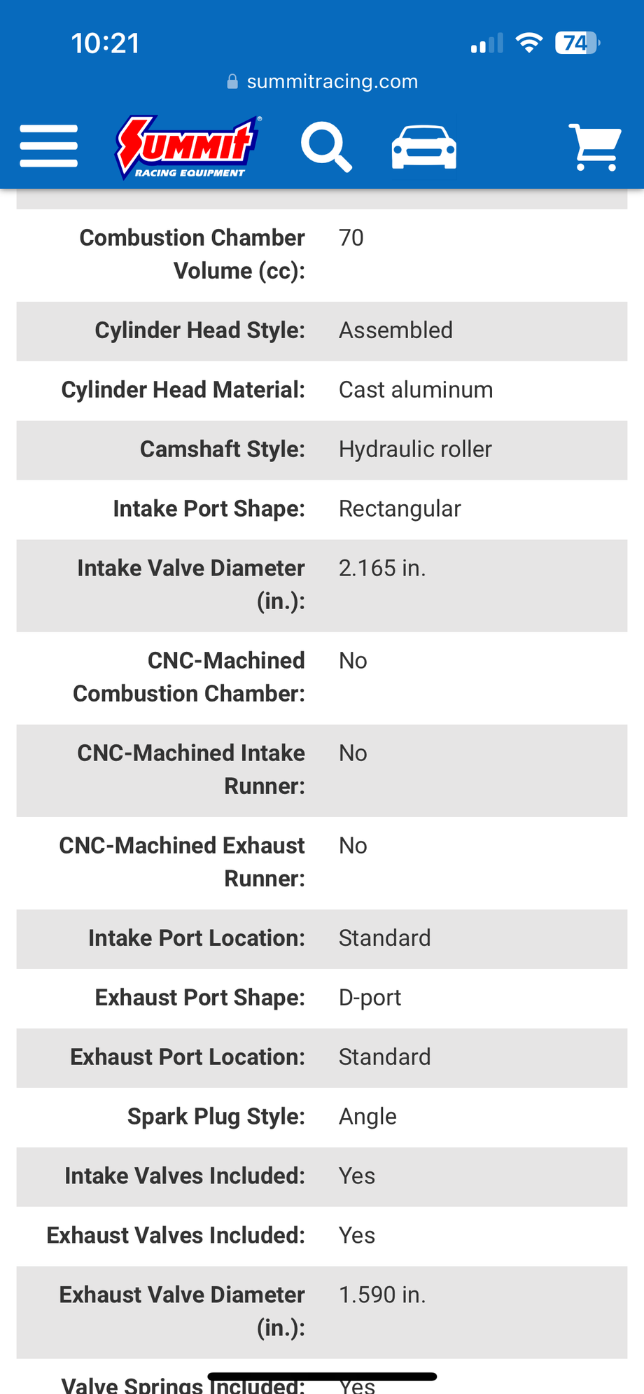

Arw these the correct heads?
Old Nov 28, 2024 | 10:23 PM
bwill03z's Avatar
bwill03z
Joined: Nov 2011
Posts: 3,187
Likes: 266
Default Arw these the correct heads?
Are these the exact same heads that came stock on an LS3 C6? They are the 0821 casting.
As it says in the description, p/n 12711770 is an L92 cylinder head. The LS3 head is p/n 12675871:
https://www.summitracing.com/parts/nal-12675871
The LS3 head p/n has lower-volume combustion chambers and hollow-stem intake valves.

So are the 12675871 heads a good replacement head? The only difference that I can tell apart from the stock head is maybe the valves have a two angle cut instead of a three angle cut like the 821’s. Other than that they seem identical. Are these inferior in any way?
A "three angle job" is generally considered better than a "two angle job" on a car valve, as it provides more optimized airflow by creating smoother transitions at different valve lift points, leading to improved power and efficiency, especially in high-performance engines.

As mentioned earlier, the intake valves are heavier on the L92 heads. If you don't plan to rev past 6500 rpm, they're probably fine.
I know it comes with the hollow intake valves but on the exhaust valves they might be heavier than the stock 821 exhaust valve. But no the car won’t ever see past 6500 RPM
12675871 is the current part number for the "stock LS3" head as per GM. The previous part number was 12629063. I don't know if there was any functional difference. GM updates part numbers all the time.
If you buy an LS3 crate motor (19540155), it comes with two 12675871 heads installed. The same heads also come on the LS376/480, LS376/515, LS376/525, DR525 and 525RLB crate motors.
The current "stock replacement solid-stem [exhaust] valve used in L92 and LS3 engines" is part number 12582719, which is the same as it was back during C6 production. It's the same valve. I presume this still-current "stock replacement" valve is what GM installs in their current 12675871 "stock LS3" heads.
Maybe there's a subtle difference between the LS3 replacement parts GM sells today and what they put in the Corvette originally, but I have no evidence that they're a lower-performance design. Some people have argued that QC isn't as good, but that's a separate problem.
So I ended up having a buddy order me some
heads from a Chevy dealer using my vin and the heads that came are the L92 heads that I posted the picture of. I have some hollow intake valves so that’s not a problem but why kind of difference with the combustion volume difference make? I think it’s 70cc on these L92 heads and 68.4 on the other heads.
I will lower your static compression ratio a little. From an online calculator, it is showing a 0.2 lower compression ratio. Not really much. And you can make that back up with a thinner head gasket. 0.045 Cometic would do get it back to normal and give more squish which is a good thing.
Great thanks for the info buddy. I have no idea why they sent the L92 heads because supposedly they used my VIN and that was the part number it pulled. I know these heads will work fine it just sucks because I did have to spend extra money to get the hollow intake valves. I know the solid ones would have worked like we discussed but for valvetrain stability purposes I went ahead and got the hollow valves. I also read that these heads don’t flow quite as good But I’m sure the difference is minimal if any different at all. I had already ordered both head gaskets and went with the factory replacements but I’m sure I can return those. If not, any idea how much that .2 lower compression ratio would actually affect hp/tq?
It won't be much. Probably 1-3 hp, 5 at most. Nothing that would really make a difference. And might be able to run slightly more timing which would make up that difference. But the little bit thinner head gasket can make up for that. The thinner gasket would also have a better squish/quench. That has several benefits such as better resistance to detonation.
