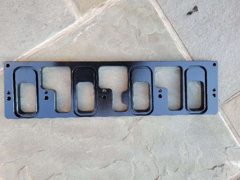

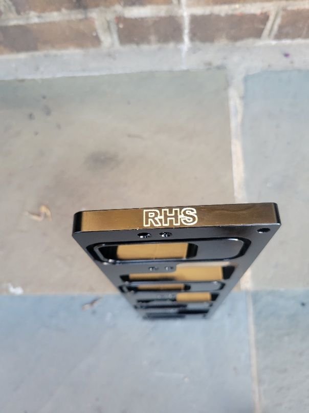

I depends on the manifold and how it impact the cowl area. The MSD back of the manifold is pretty close to the back cowl for about 1-2 inch of the manifold length. Thus any additional height would require some kind of modification. The tall deck will raise any manifold up 5/8 of an inch about 1/2 of that increase comes from the 1/2 inch more deck height (but at an angle so less) and then to readapt the old intake to it you need an adapter plate which is 1/2 inch thick itself but also at an angle so less overall height increase. Because the LS motor the manifold bolts being straight up and down complicates things. There was a guy on here who ran a tall deck and had the 3/8 shorter engine mounts and they shimmed the body 1/4 inch so 5/8 total. Basically the spacer bolts to your existing manifold bolts (which are now further apart) and moves the new ones down to match you manifold. Spacer photos below for clarification.
