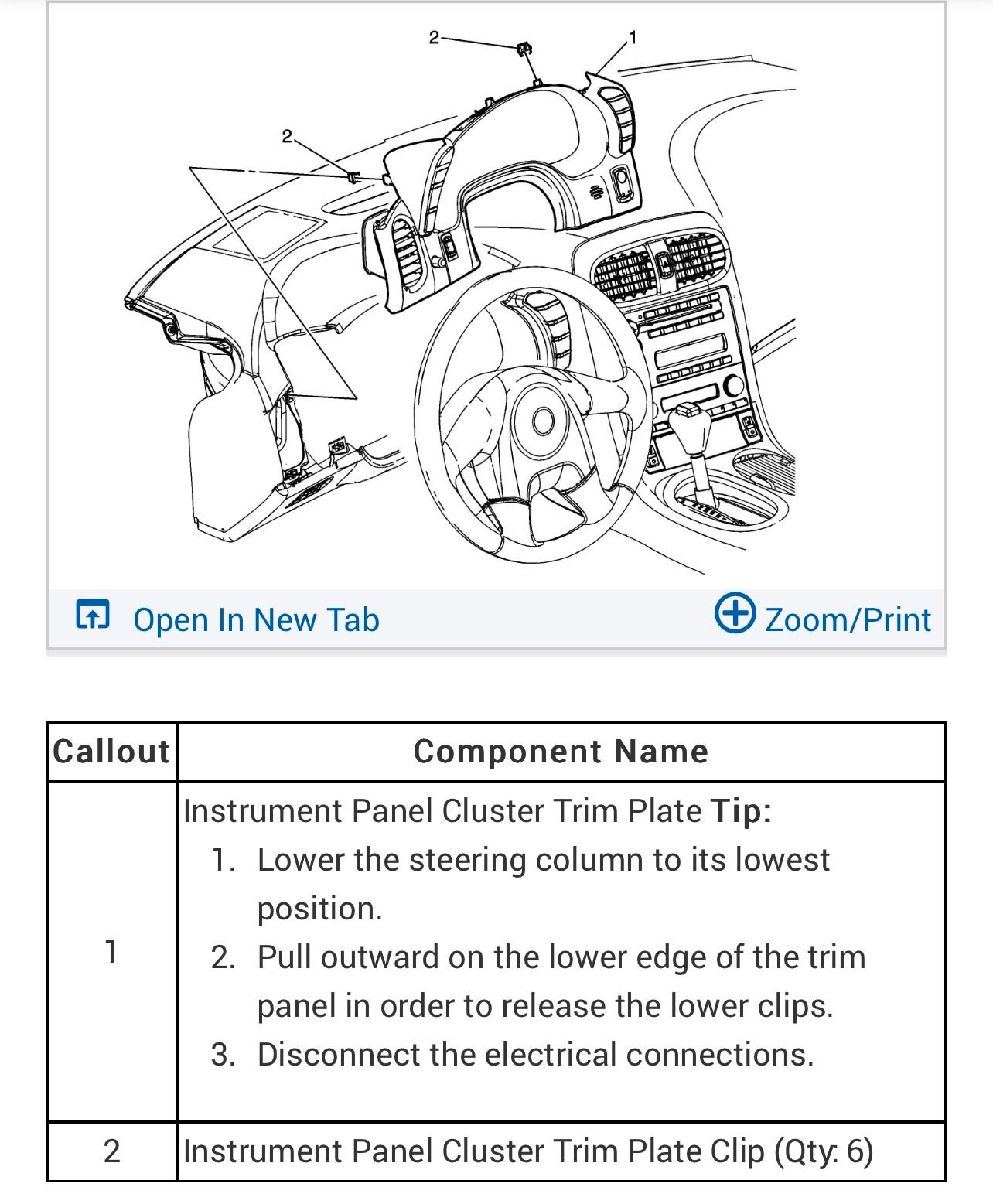

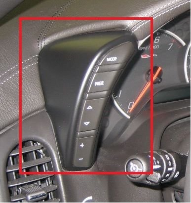

I have an annoying noise coming from here that goes away when I push on this (sounds like a loose washer vibrating). I want to remove this to inspect, but before I go breaking something, does anyone have photos on how this is removed?

Thank you C5 Diag and HK770!
