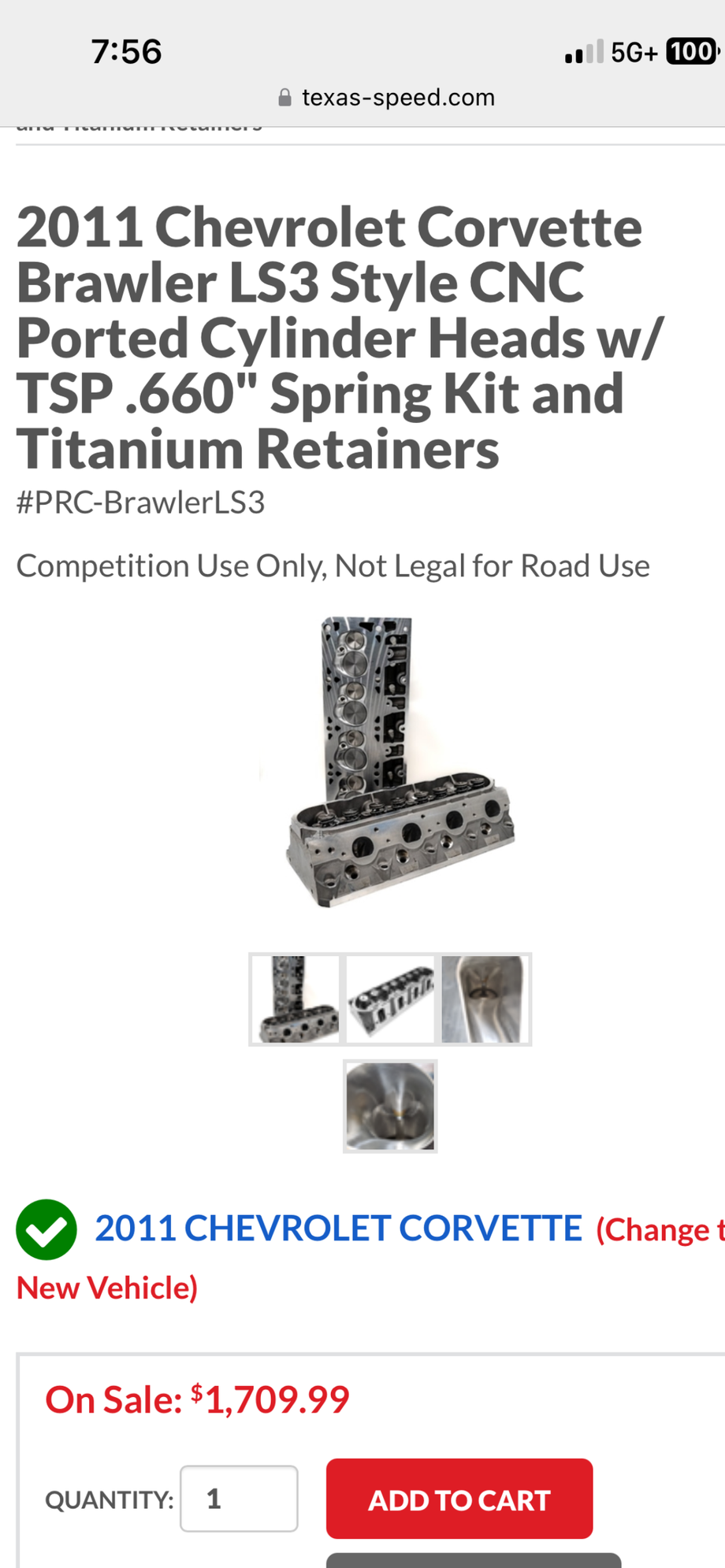

I’m trying to decide which ones I’m going to go with between these three. First set is the PRC LS3 Brawler heads from Texas Speed and Performance. They have a five angle valve and dual PAC springs and flow slightly more than stock.

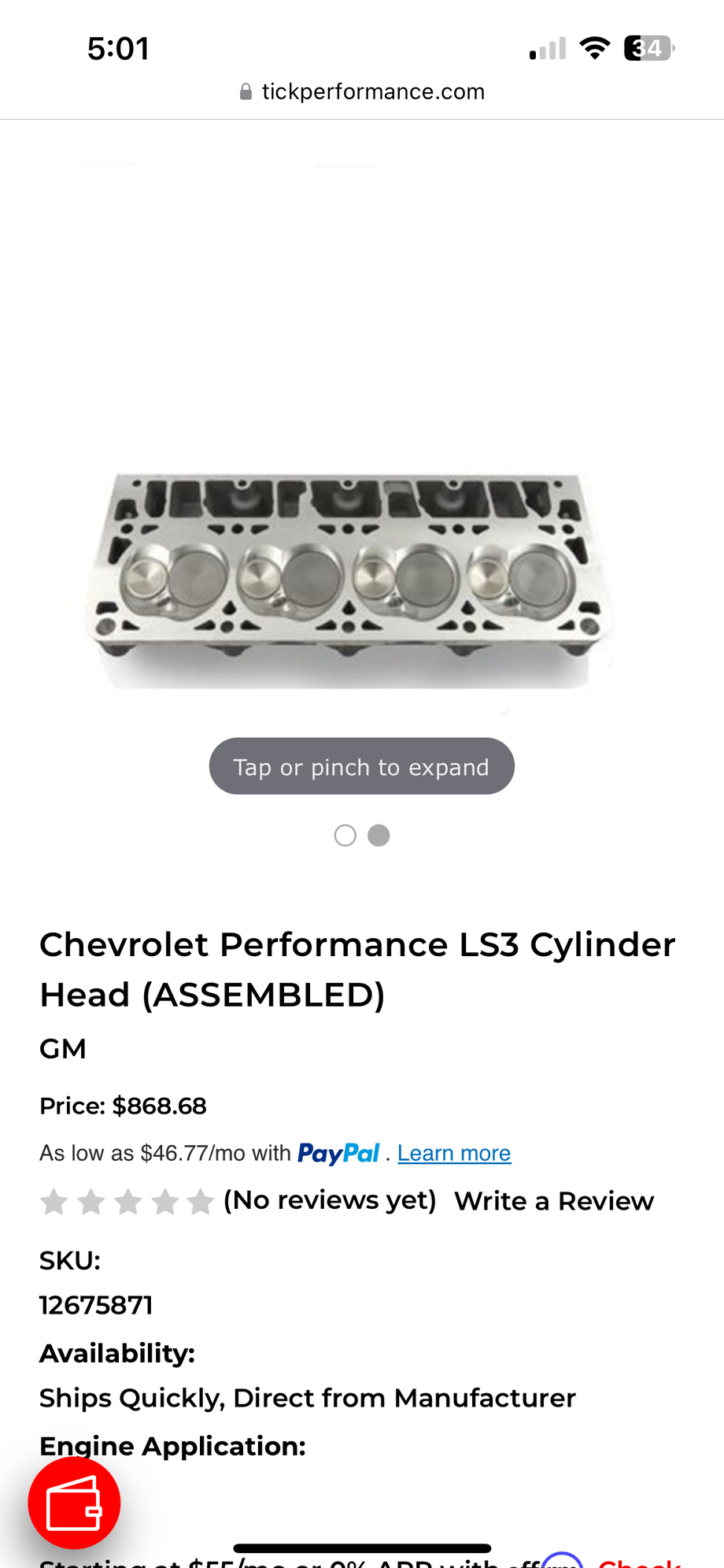

The second set are the Chevy performance heads that are the exact same specs as the factory heads except I believe the valves are a two angle cut rather than three angle, they still have the hollow intake valves.

I'd go with the Brawler heads. Based on the LS3 casting but with a CNC porting job and already set up with upgrades springs. Should work well and maximize gains with the cam you have.
