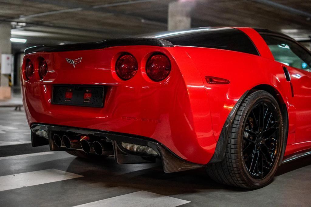

I bought a carbon rear diffuser to replace the OEM one, I didn't find any topic about removing the diffuser, anyone would be able to help me please ?
A glance at the diffuser here :
