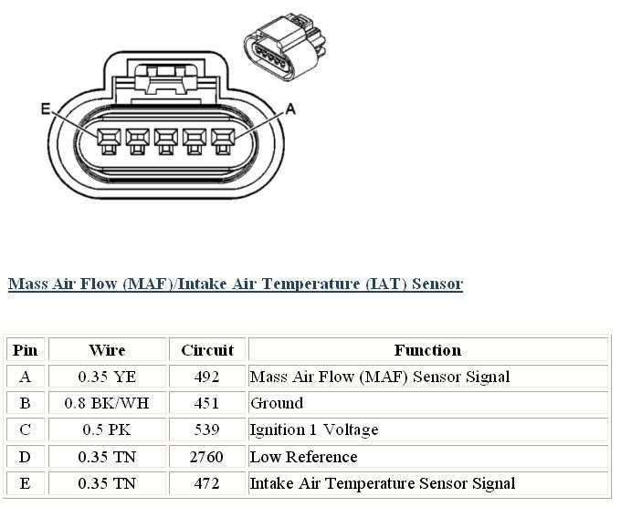

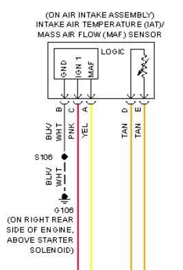

I am reinstalling a maf sensor i need help as to where the maf grounds the previous owner had an iat sensor do i need to splice into those wires? Thanks in advance. 07 z06

Originally Posted by davidfarmer
thanks for the pics huge help
