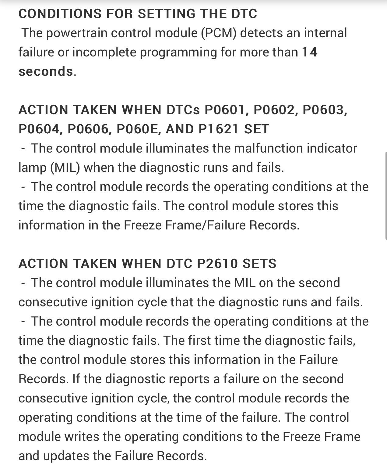

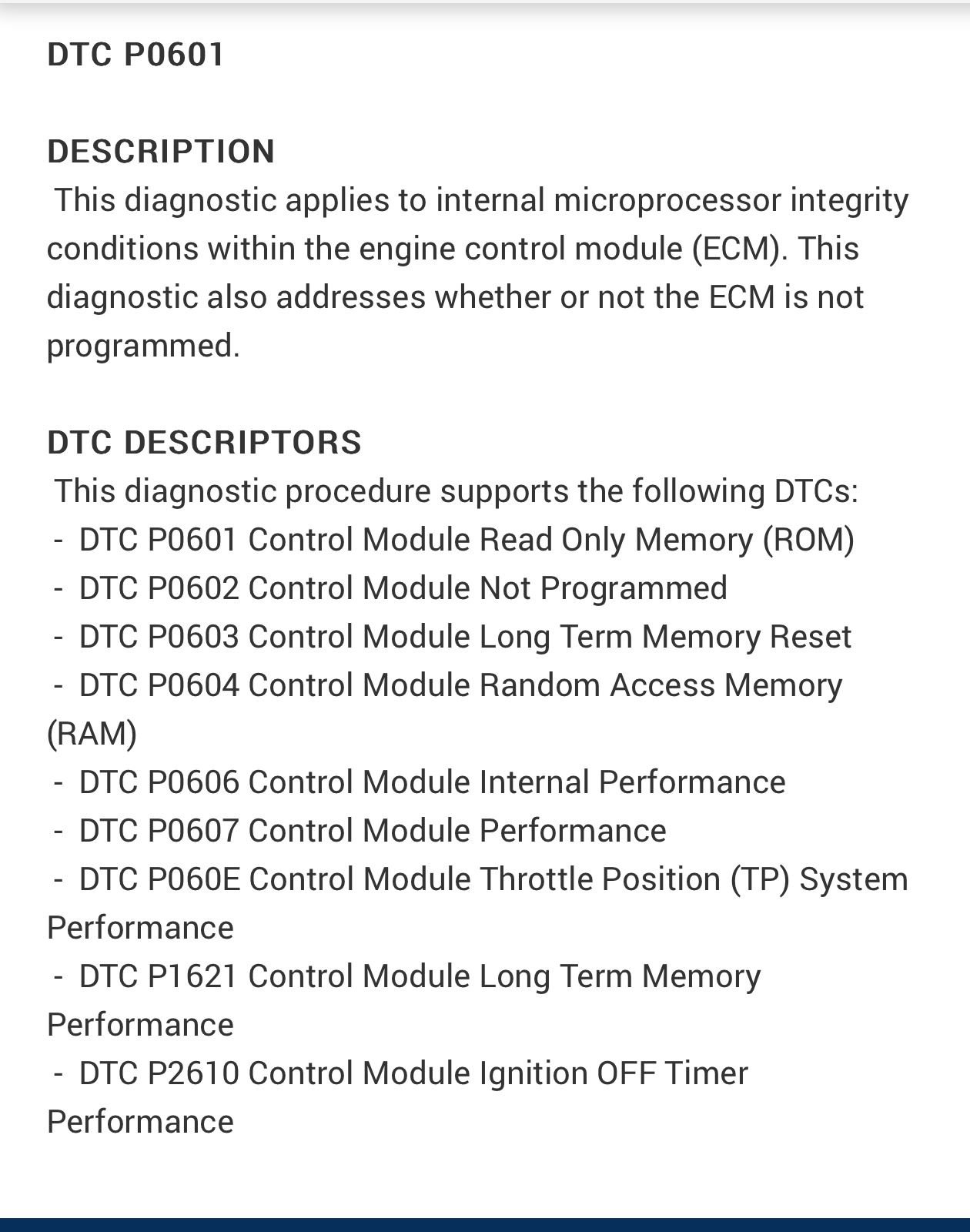

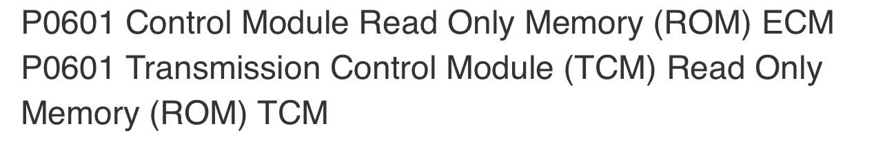

Basically you check powers and grounds at the ECM and if good it’s an ECM change.
