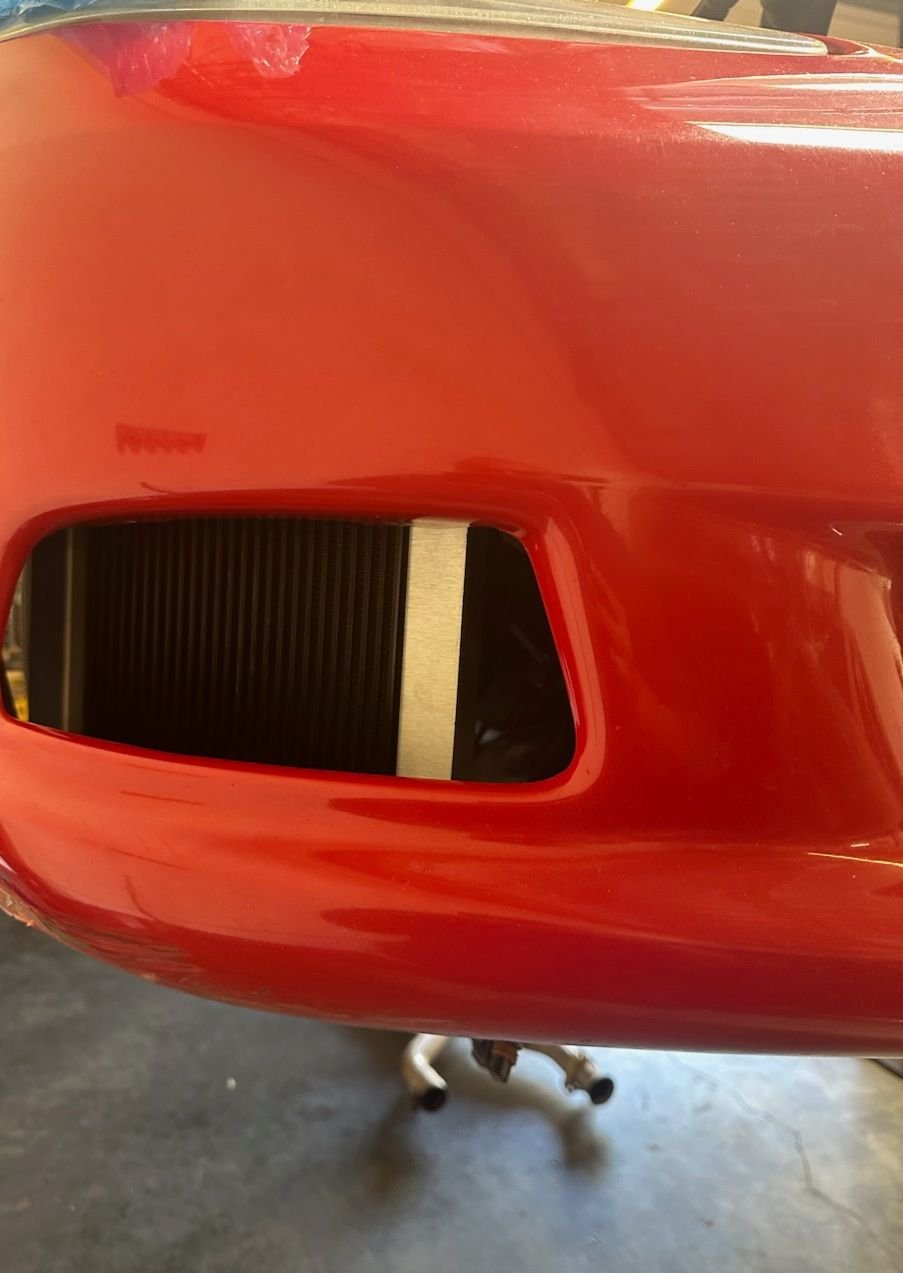

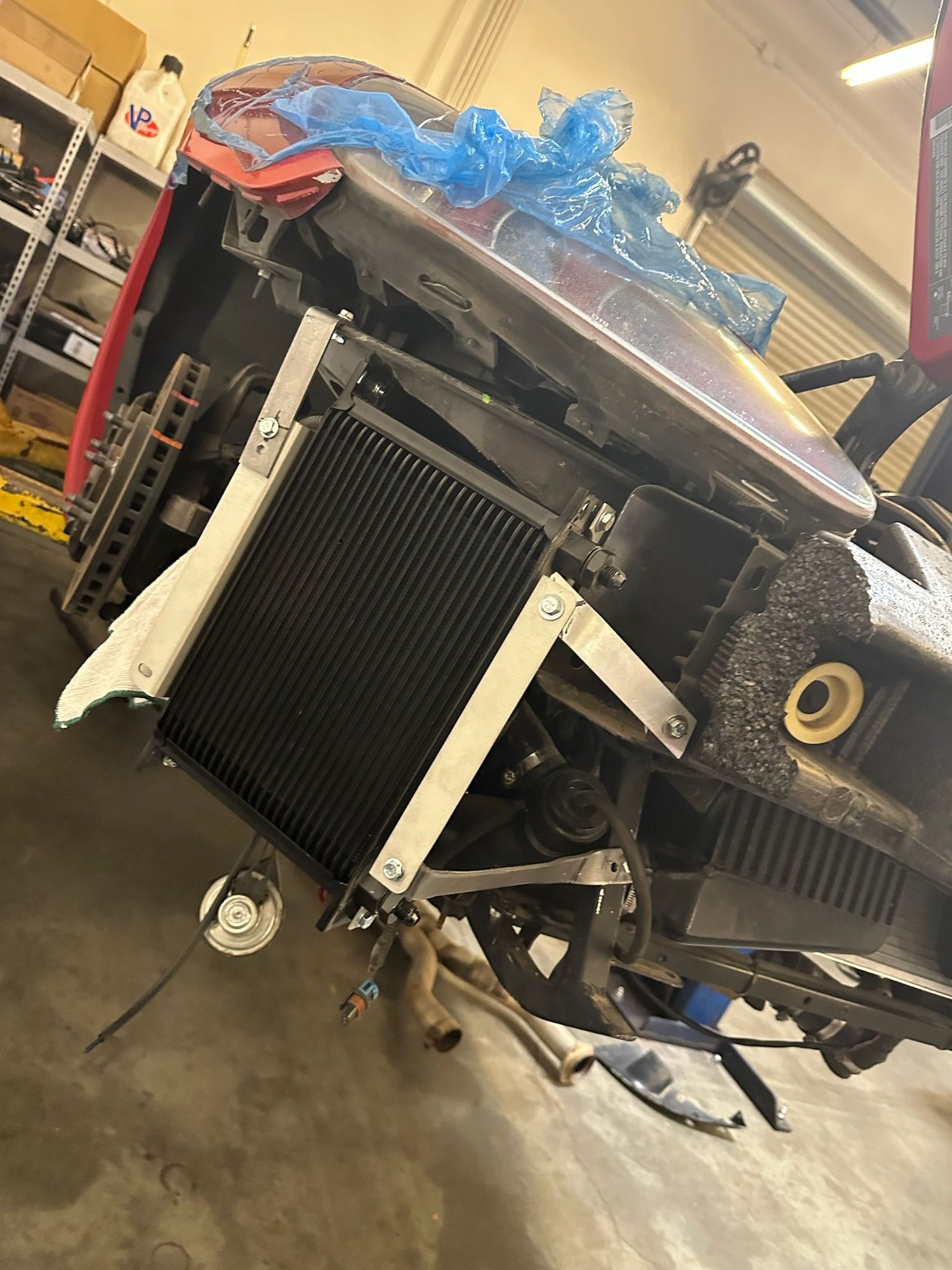

Trans cooler is a good idea regardless, make sure you go with a good stack plate design in the front air stream, avoid the fin/tube ones and avoid fans covering the front of them. Fans can actually deflect air off the cooler. I personally recommend taking the radiator out of the loop but a lot will argue against it even though they can rarely provide a legit reason. I've had my car set up that way for the last 4 years on a Derale stack plate right behind the grill. Barely ever seen temps over 190, typically it stays around 140-160.

I put a cooler on my trans, not the diff. In hot weather romping around my trans was getting hot. Stacked plate cooler, no fan-works great.
I also put an inline thermostat, living in the North East it helps getting the trans up to temp quicker in the colder months.
