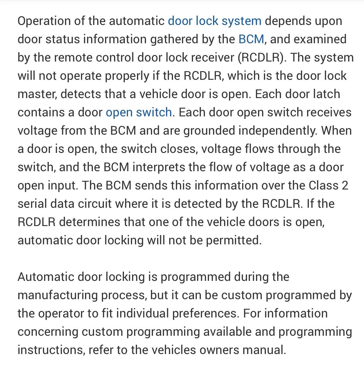

When I quickly read your first post and you said you could not open the door from the outside and you had a "no comm" with the TCM and "No Fobs Found" I thought that maybe the ECM/TCM/EASY KEY fuse 11 was blown...that fuse is battery power for the ECM,TCM, and RCLDR...with that fuse blown the car will not start anyway even with the FOB in the backup antenna slot in the glovebox so that is probably not the problem...each door module has 2 separate grounds so it wouldn't be that...you said you have a Tech 2 so look and both inputs and outputs...an input would be you pressing the door switch to open it...it is basically a command...an output is you command the door to unlock....I'll have to look into the wiring diagram further...if you just use the Tech 2 to erase codes (which many only do) you have a lot of good diagnostic information available....you may be better off installing your old BCM and RCDLR if they didn't fix your concern....you DON'T need a new wiring loom...if a wiring issue you just need to find that.,,,video below.

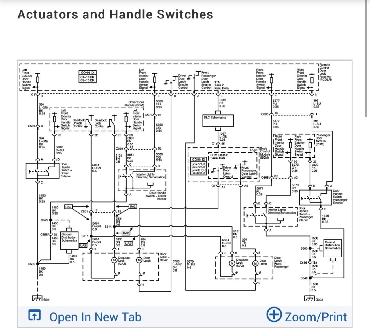

Doubt you need the whole body wiring harness but all you would need is to understand how the door lock system works, a wiring diagram, and a factory level scan tool.

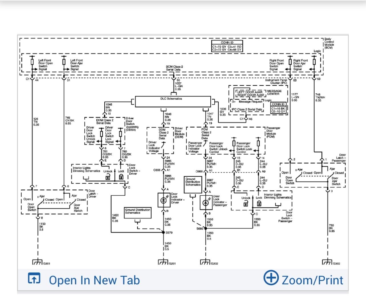

To Both Doors not opening

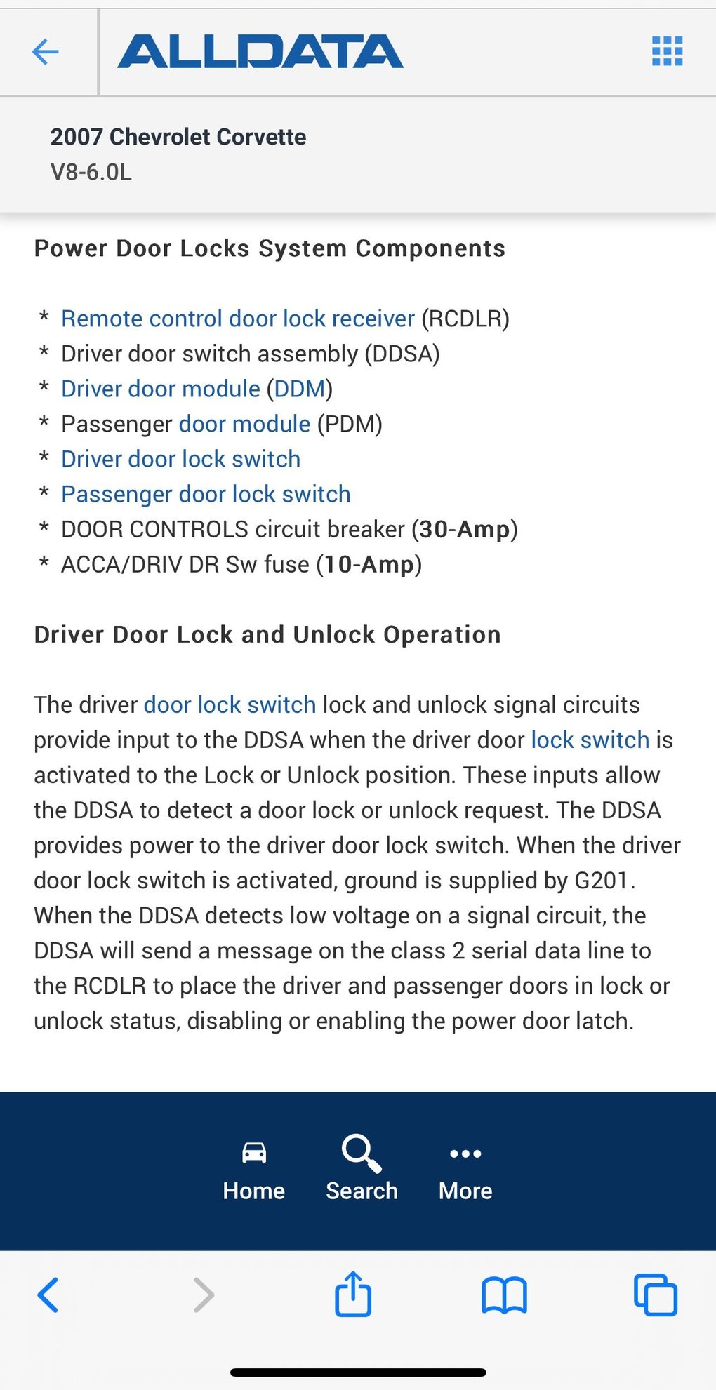

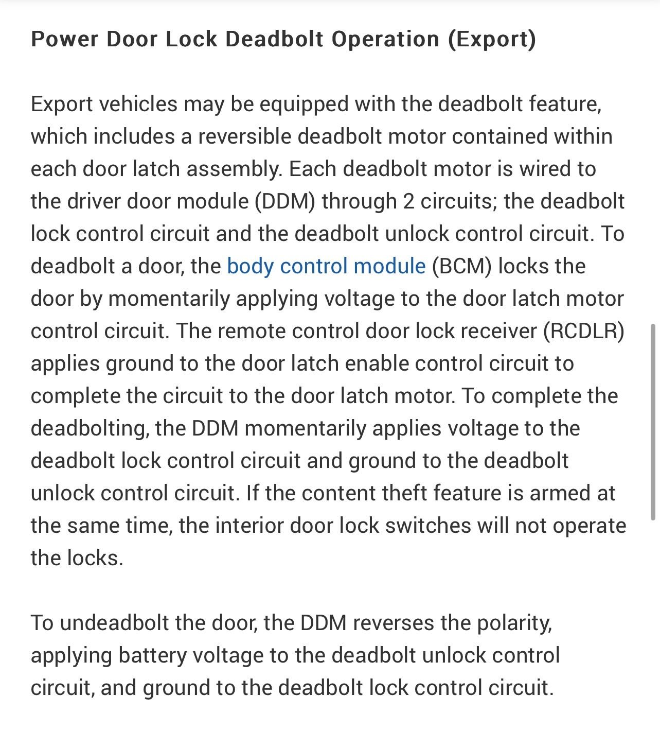

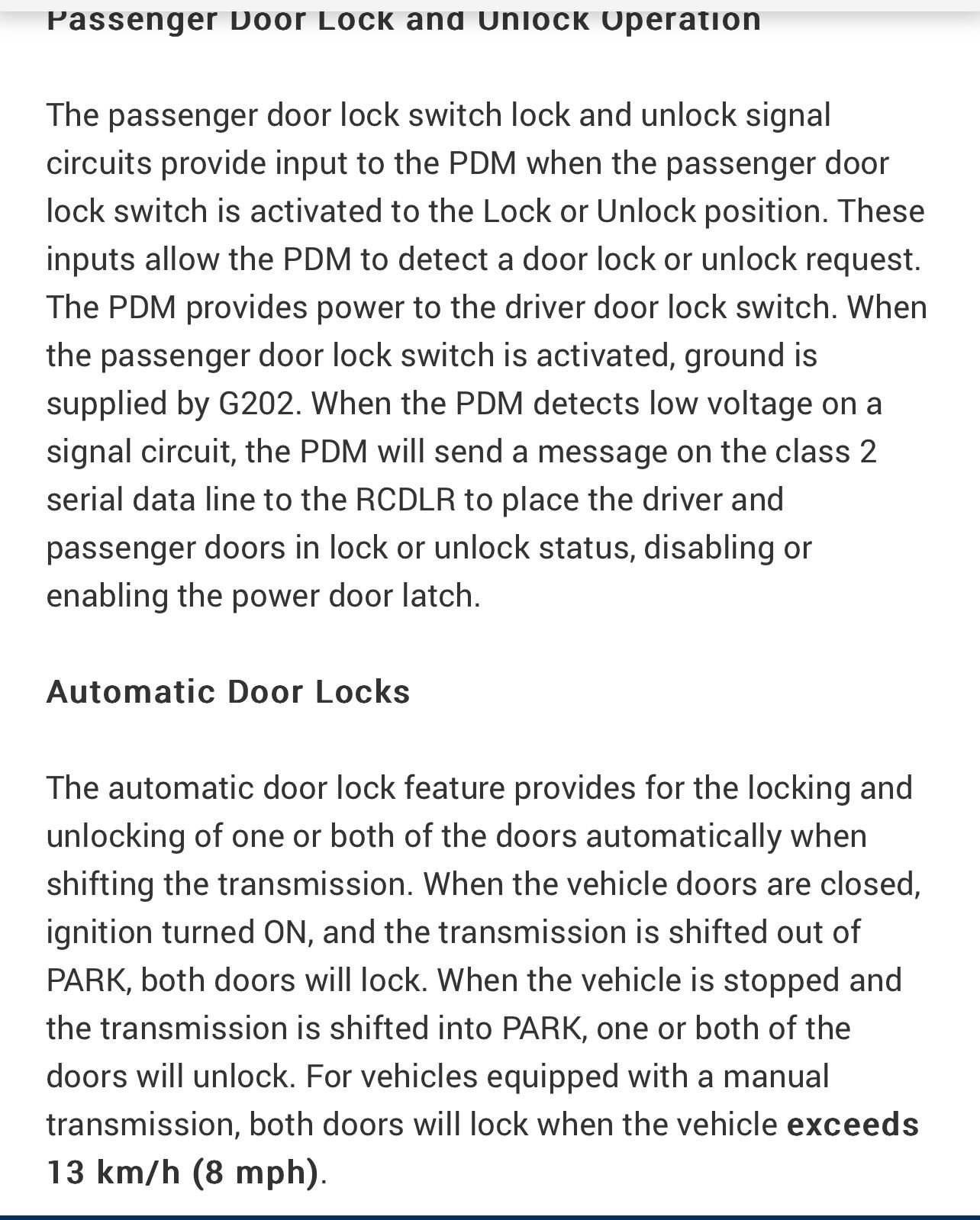

Old Feb 27, 2025 | 08:50 PM
C5 Diag's Avatar
C5 Diag
Moderator, Tech Contributor
Posts: 15,615
Likes: 4,062
From: Cape Coral, Florida
Old Feb 28, 2025 | 08:42 AM
Mr D.'s Avatar
Mr D.
Joined: Mar 2002
Posts: 44,679
Likes: 1,830
From: Huntsville AL

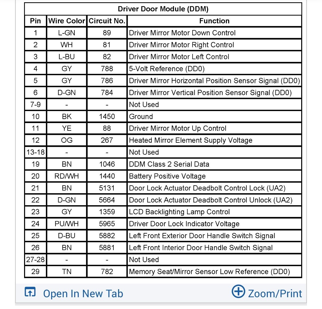

Someone educate me, looking at the Driver Door Module (DDM) what is the diagram symbol ( - at 25, 22, 21, 26? I'm assuming a connector???????
Old Feb 28, 2025 | 09:09 AM
C5 Diag's Avatar
C5 Diag
Posts: 15,615
Likes: 4,062
25,22,21, and 26 denotes the numbered terminals at the DDM as you can see below…the dashed lines around the DDM means it’s a “partial” view of the module because all of the terminals are not included here…if you look at 22 and 21 and follow it down you will see UA2 in the rectangular box…those are RPO codes and on some diagrams like the information bus you will see a minus symbol and that means WITHOUT that RPO code…UA2 is for exports only and in the DDM module box you will see the word “deadbolt”…on a domestic C6 you will not have those wires on that module…the operation of UA2 is included below…it would take me an hour to explain all the symbols on this wiring diagram…also the connectors are denoted by a “C” with 3 digits…connectors under the hood will be C1XX…connectors in the back of the car will be C4XX…”S” are splices…you will find all this information and locations in Service Information.
