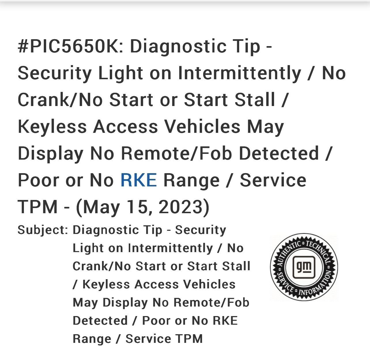

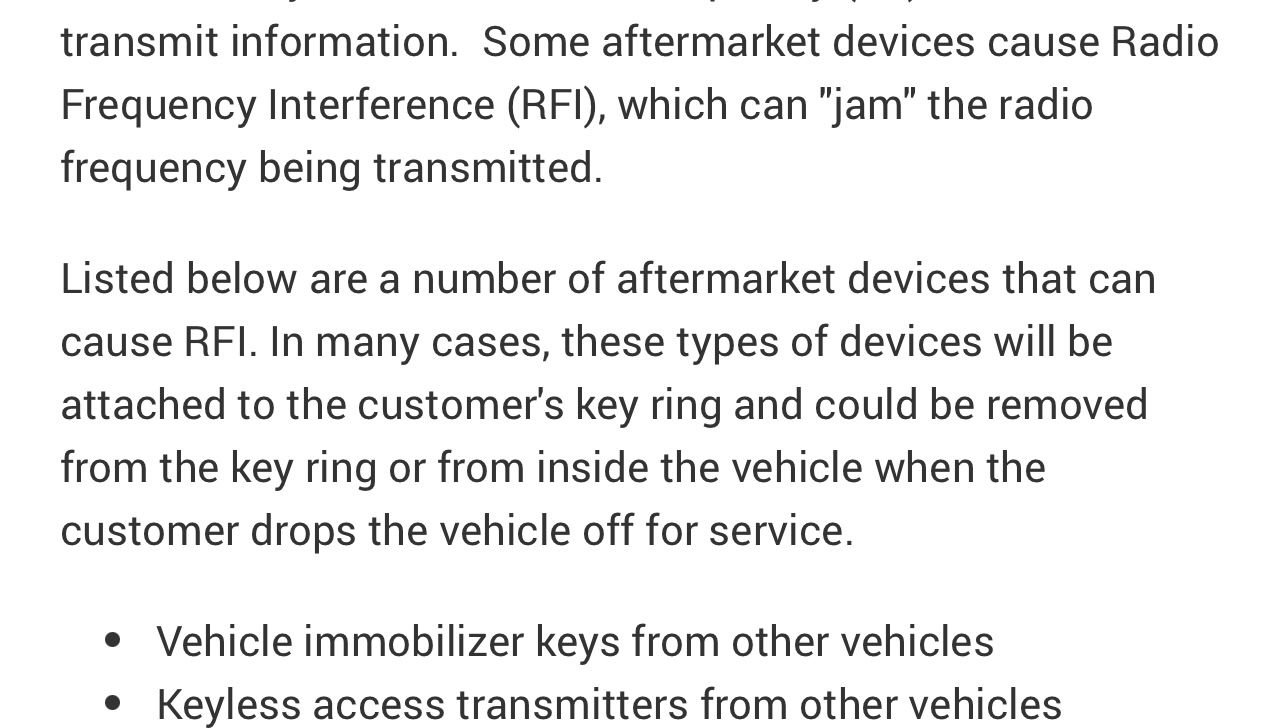

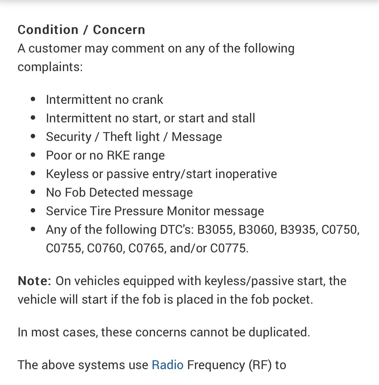

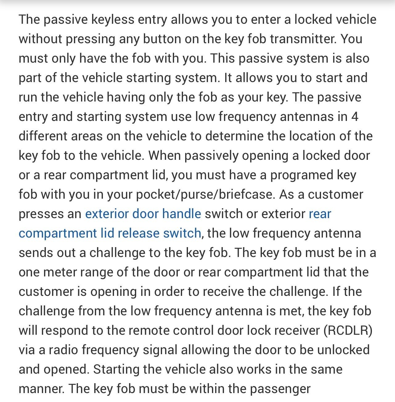

FIRST thing is read your owners manual…if your car didn’t come with one you can find a PDF version online…make sure your FOB battery is new and reads 3.2 volts…you have to be within 3 feet of the door to passively open it…there are 4 antennas of which 2 are in each door B pillar on the 2005-2007 and further back in the wheel well area from 2008-2013…make sure you don’t have something like cell phone chargers or anything that emits RF that interferes with the wireless signal…there is a TSB which is below…you only need to use the back up FOB slot where there is the 3rd antenna if the FOB battery is dead…4th is in the trunk area…as a new member it’s good if you fill out your profile with as much info on your car as possible…that you live in the US and are a male isn’t enough info !!
