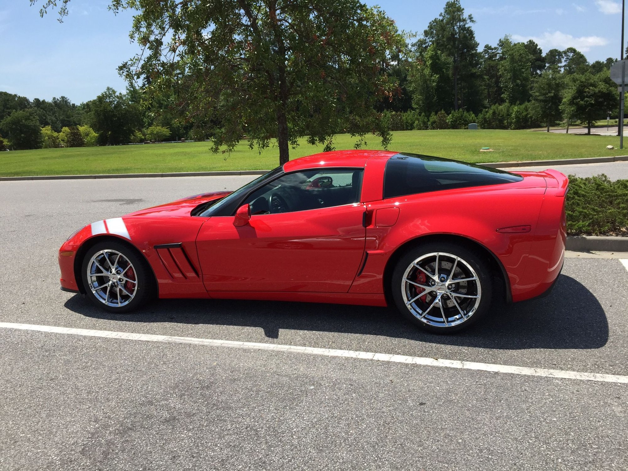

No help on the camera, but the GS photo is great. What's not to love... At 80+ I sold all our Corvettes, but this photo makes me want one just like it...:0)
Is that Victrory Red or Torch Red?

Thanks for the compliment. This car has never sat outside one night since I bought it in 2013! I’ve babied this car since I’ve owned it and I love to get it out and drive it when I can.
It’s Torch Red!
