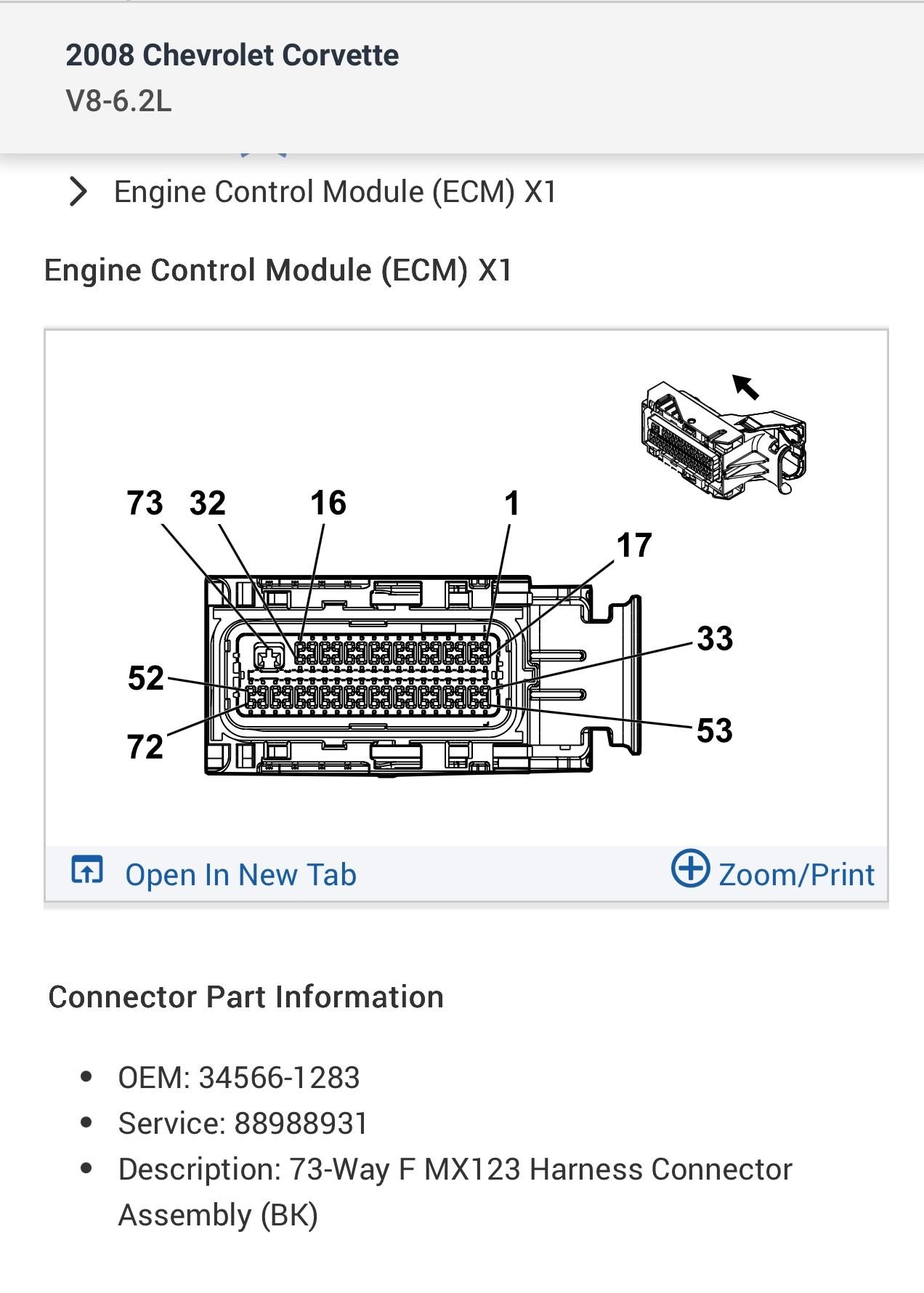

Disregard my fix. Apparently xm2 connector is having an issue and somehow while messing with the xm1 connector I moved it just right and got comms for a bit. I’ve narrowed it down to an issue in the xm2 connector somewhere not getting a good connection as I can hold the connector down with my hand and get communication. We tried a bandaid fix with zipties and it got by for a few days but back to same problem. I can not for the life of me figure out why it’s having a connection issue still and I’m fixing to throw in the towel on the whole car
Old Apr 20, 2025 | 09:04 AM
  #40
C5 Diag's Avatar
C5 Diag
Moderator, Tech Contributor
Posts: 15,618
Likes: 4,066
From: Cape Coral, Florida
I don’t know if you established communication again but the COMM lines are on X1 (black 73 pin connector) pins 27 and 28…is the lever lock fully engaged ??…you would need to do a pin drag or terminal tension test as it is called to see any of the terminals are spread apart.
