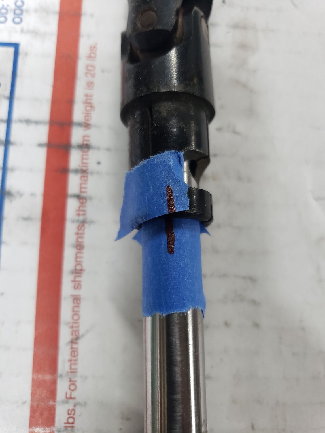

Mark your shaft / clamp with a marker and you'll be able to see the slipping shaft inside the clamp, it happens at the end of it's range of motion. The shaft, the clamp and linkage need to rotate the same amount.
You can cheat your shifter a tiny amount to one side or the other to get a little more engagement into either first or reverse before you tighten it down. If it's hard to get into reverse move the stick away from reverse (towards the driver's side) a tiny bit, (1/16in or so ) to counter the slop in the box. This will give you more engagement into reverse. Don't use more than 24# on that bolt or you'll crack your clamp.

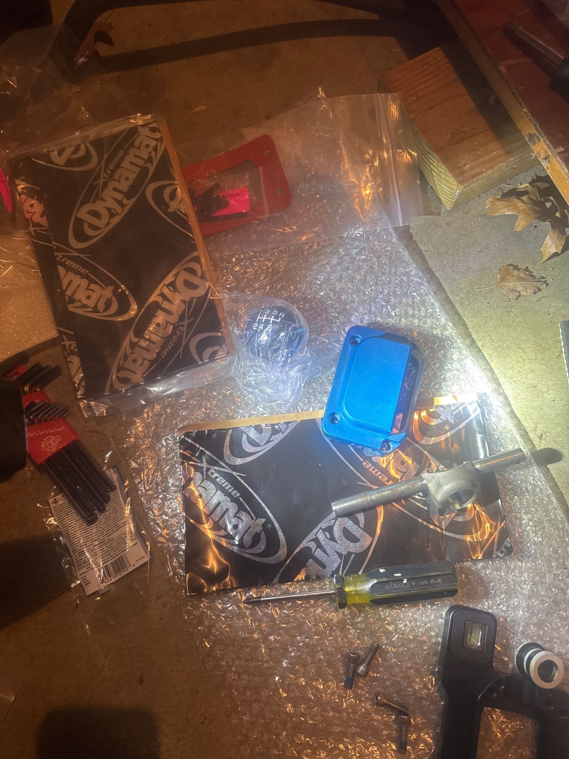

i recently ordered a mgw flat shortthrow shifter for my c5, i made sure to enter the correct specifications of my car but in the lower kit i was sent a top billet piece that isnt in any forum or tutorial i looked at the plate isnt open like others ive seen instead it has a piece of metal covering the area that should be open with an exception of a very small slit on the right side. So idk if i got sent a piece that wasnt finished, I just dont want to put it in my car and have to take it out again
I recently ordered a mgw flat shortthrow shifter for my c5, i made sure to enter the correct specifications of my car but in the lower kit i was sent a top billet piece that isnt in any forum or tutorial, the plate isnt open like others ive seen instead it has a piece of metal covering the area that should be open with an exception of a very small slit on the right side. So idk if i got sent a piece that wasnt finished? Just confused lmk if anyone has any idea. Thanks
