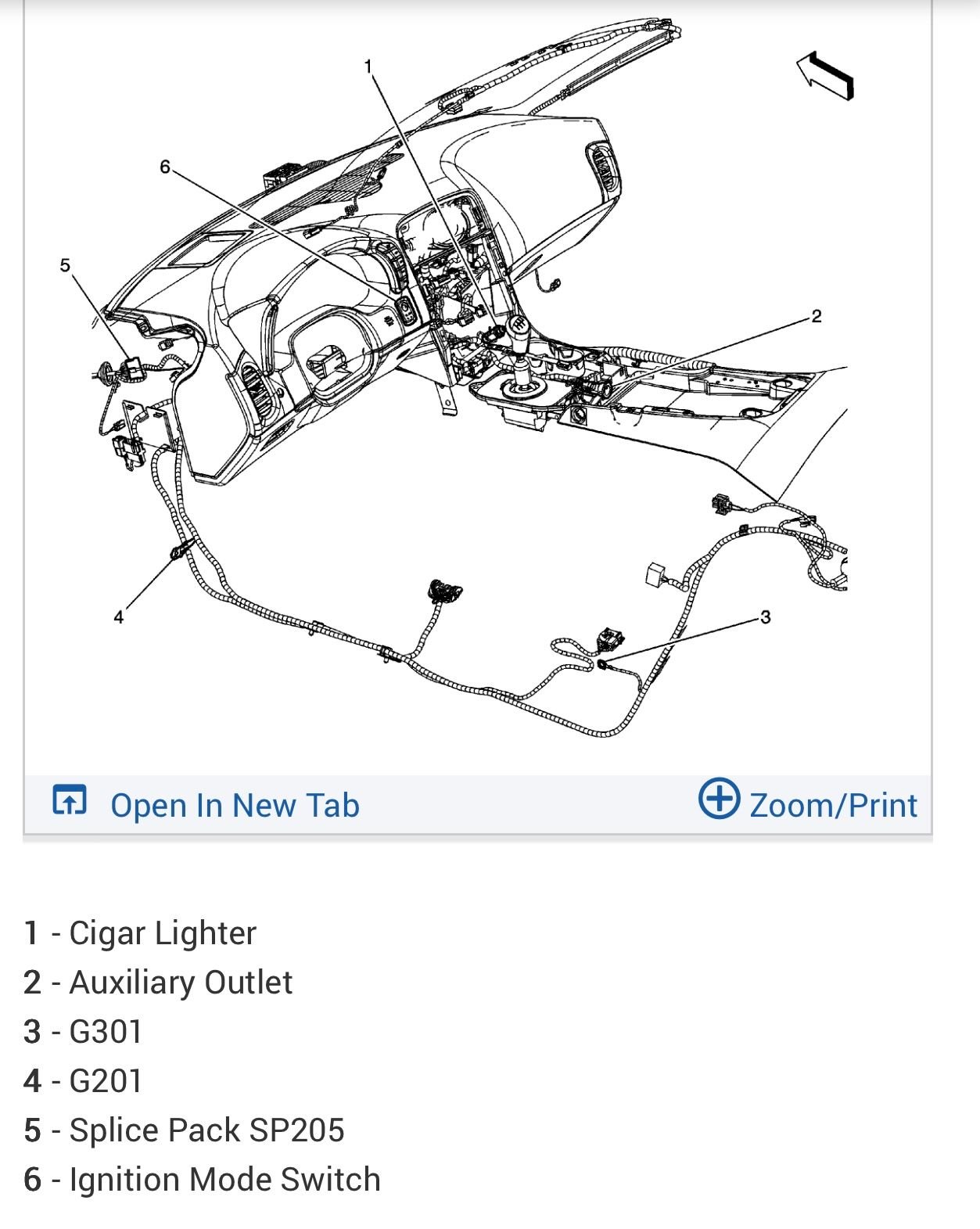

Have a 07 Z06,,,,,,,My dash lights quit working while driving. After about 30 miles they started working again, Have any of you had this problem,
I Would appreciate your input on this. I think I read something some time ago on this problem but I have not been able to find it.
Thank you, Ellis

May be a bad ground which is G201 at the base of the left A Pillar…is the DIC, HUD if equipped and IP dimmer also not working ??…look at the wiring diagram if you know how to read it.

Thank you for your response. It acts like a loose wire. I will start my search there. Hud still worked. Thanks again.

#4 below !!…it looks like a splice pack (S303) so you need to remove the “comb” and clean and inspect it since a bunch of different ground wires come together there…you may also need to pull the IP and check the ground terminal back there…BTW your profile shows you have a 93 ZR1 so you may want to update it.
