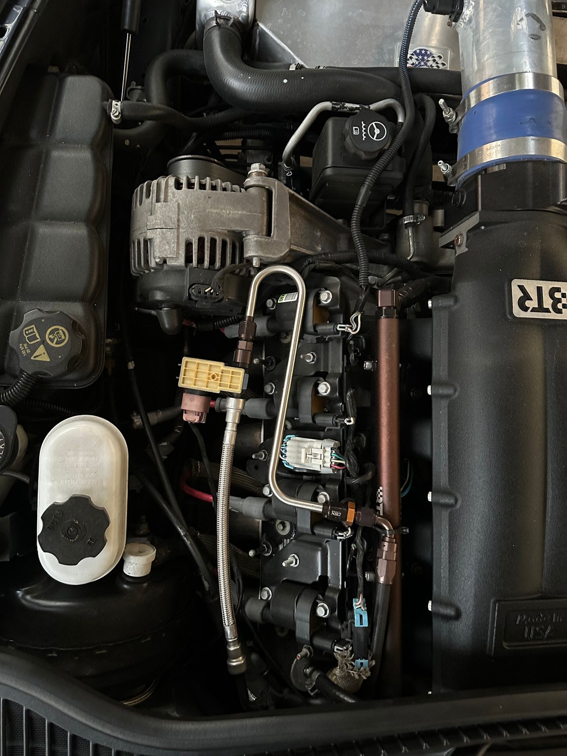

It's tougher than it looks! I didn't find a good combo of fittings where you have the fuel lines now. DSX fuel line works well but does look odd. This is what I have now and it's working well though I might shorten the hose by the throttle body or make braided line.

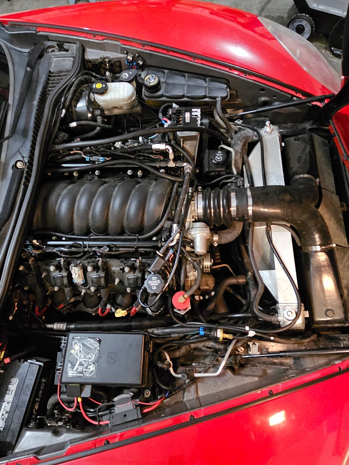

Here's my DSX flex fuel on the TT stroker car w external regulator and return line. It's tucked in pretty well.
