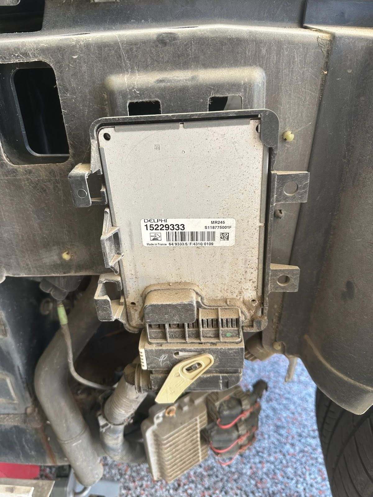

Can someone please tell me what this is? Should it have a cover? What does it does/mean. Thanks

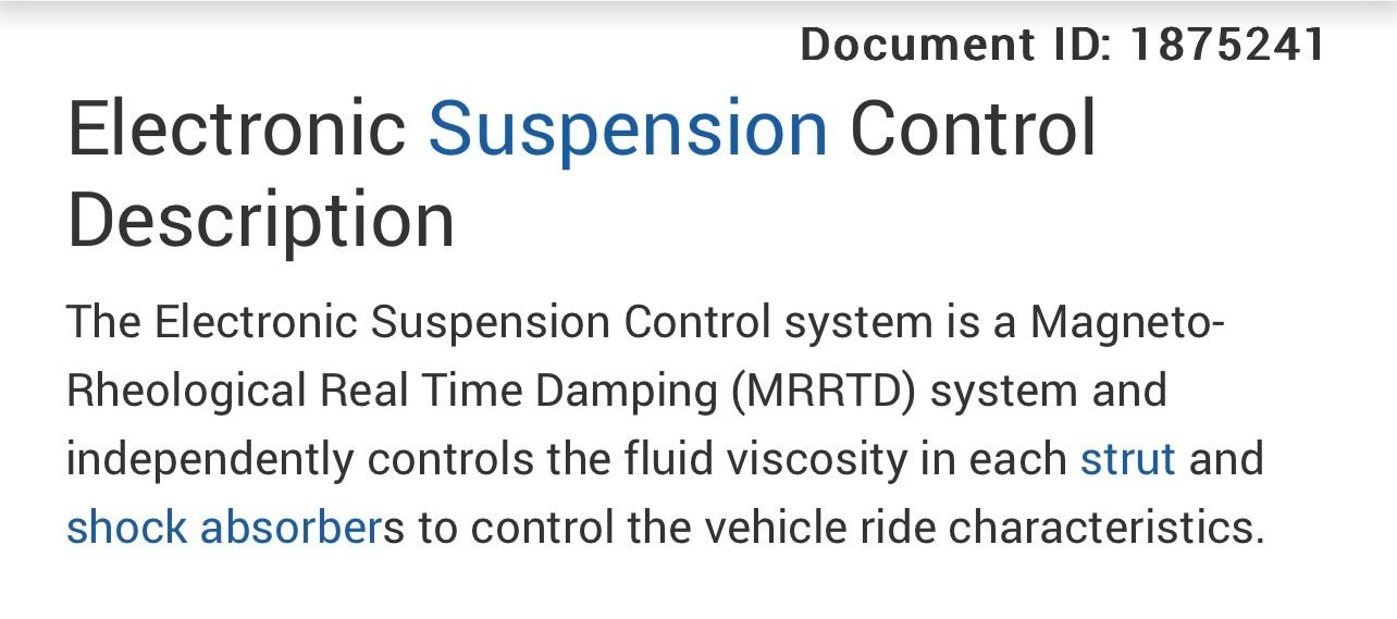

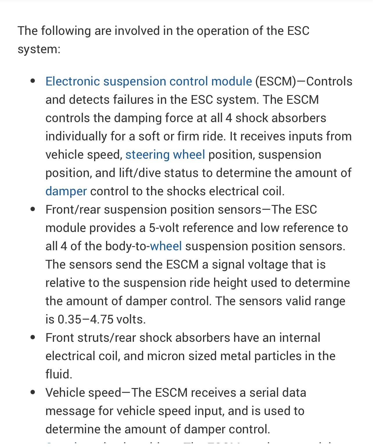

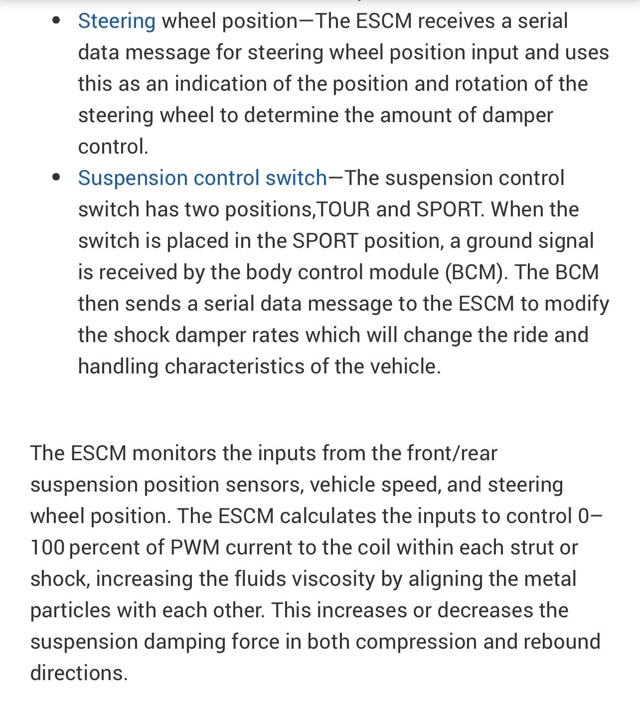

Suspension Control Module…read the verbiage.
