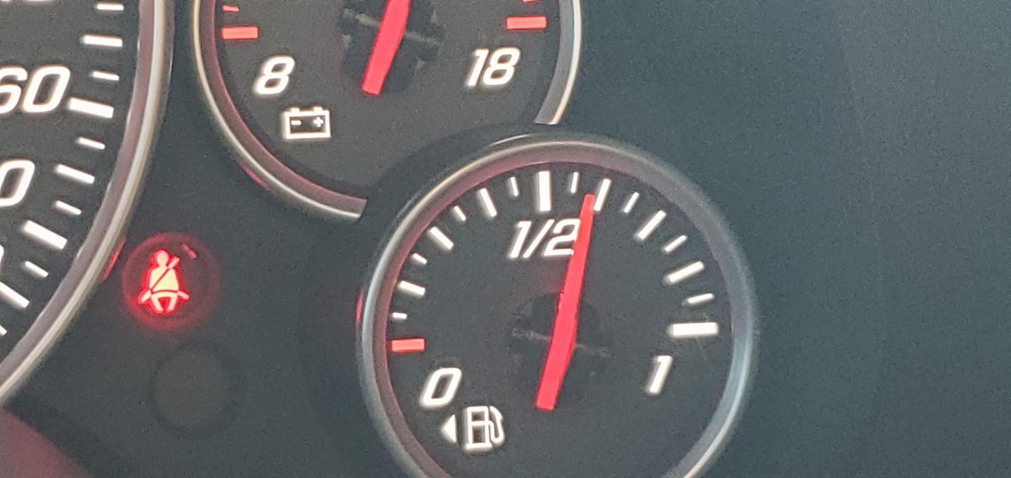

I went to fill up at Costco and the pump auto shut-off but my level was just above 1/2. I thought it was a fluke so I drove the car and put about 30 miles and then tried to fill up again. It shut-off at just above 1/2.
The gauge worked fine a few weeks ago and I would fill up to FULL and it would show FULL.
Is it my sending unit? If so, I was going to run a bottle or two of the Techron fuel system cleaner to see if it fixes it.
If not the sending unit. What else could it be?

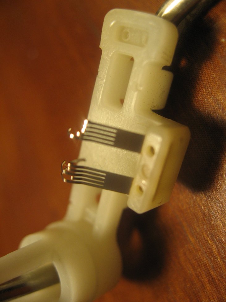

The techron only helps to clean up corrosion on the stat bars, not deal with worn out swipers isntead.
So if stat bars being oxidized or corrode the probem so the swipers can not read them, may solve the problem.
Note, there are two different sending units for the vets, depending on the year, with one increasing in ohm reading as the fuel tank fills up, and the other one with ohm reading dropping as the tank is fill up instead.
Is swipers arm tips are worn out so they not longer track cleaning over the stat bars, then fuel lever sending unit will need to be replaced, which will included new float assembly with swiper arms.

It could actually be half-full, and the pump is switching off because of a venting problem. This often manifests itself at the halfway point once fuel starts spilling over into the right tank.
Unless you're certain about the miles traveled vs. the gallons pumped, this is more likely than a gauge problem.
Try turning the fuel filler upside-down to see if you can get it to fill beyond halfway.

This is the way - I ran into this exact problem a couple of weeks ago and simply turned the pump handle to 3 o'clock from the normal 6 o'clock position and was able to completely fill my tanks.
