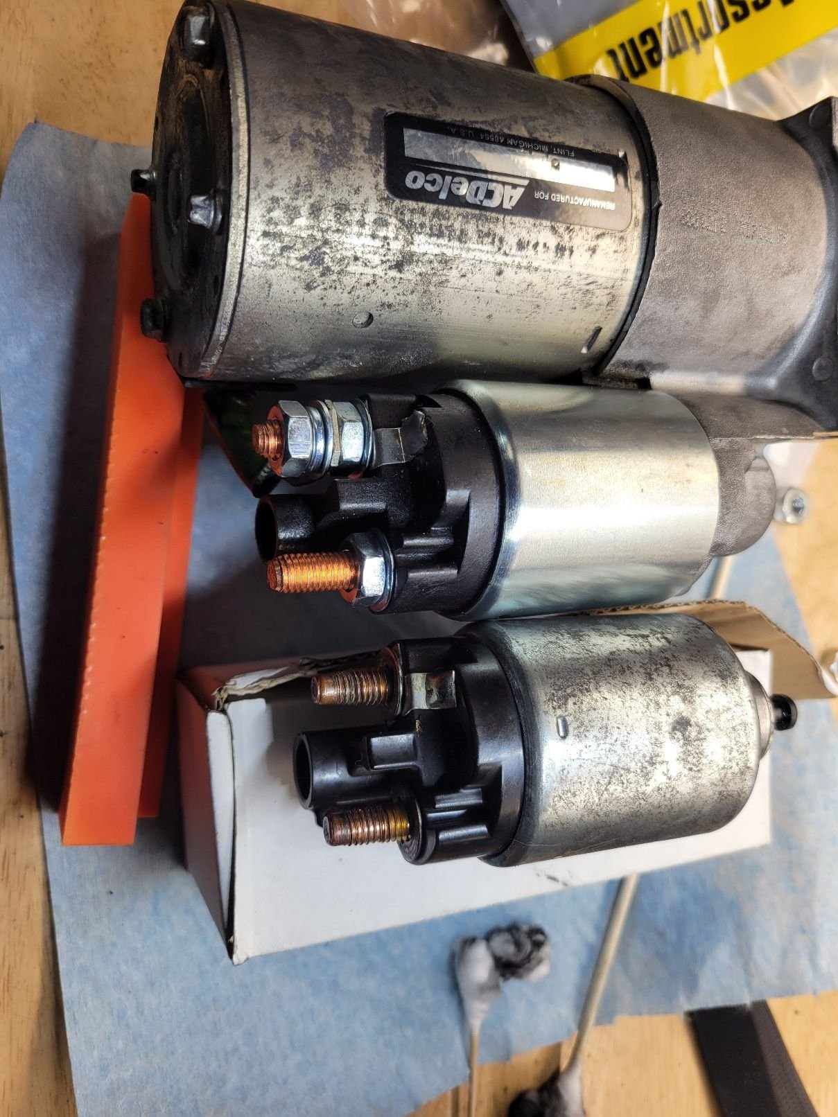

I think also some of the newer model starters have a little longer studs so you have two nuts on them 1 before the eye hole connector and 1 after it creating a sandwich even if the bakealight gives way in photo above the connector is sandwiched between the two nuts thus maintaining the connection. The old ones with no second nut the connection got loose as the bakealight gave way.
