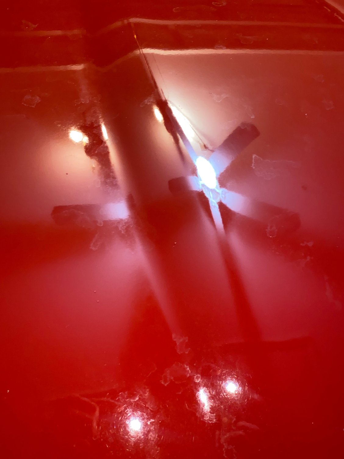

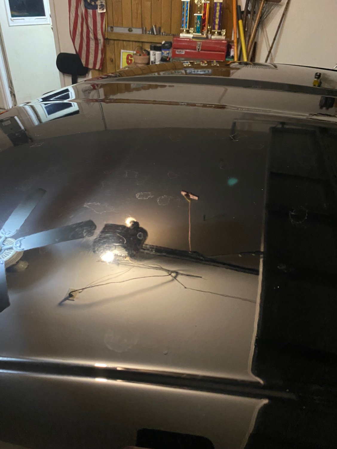

Hey guys anyone have any idea why my security light is staying on in the car when is running? Just got it back and a bunch of things aren’t working properly now like the reverse lights, trans temp sensor, paddle shifters and the security light stays on. Posted something in the tech section but figured I’d throw the security light question in here. The car sat outside for almost 4 weeks at the shop and there’s some sort of acid rain spots that won’t even buff off all over the car too, not sure what to use to remove it. Rubbing compound won’t work either… Car just had an A6 rebuilt transmission put in it. (2007 base)

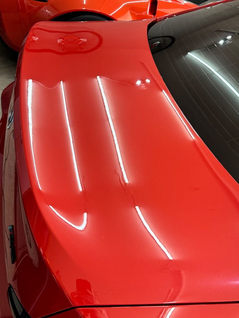

Re: the spots, I used the following products on my M2 that had very bad scratches and other blemishes under the rear spoiler & they got them all out.
Looks better than it did brand new.

I’m thinking the no reverse lights, trans not recognizing paddle shifters and no transmission temp something must be unplugged. I’ve never noticed the security light staying on and that may be something separate. The paint is screwed, i tried some rubbing compound but the spots are etched into the paint all over the car. I just had the hood, fenders, roof and front bumper repainted a few months ago and that along with the original paint is damaged. The car was fully detailed with multiple coats of meguiars ultimate wax and now it’s a disaster on top of the other issues. The battery is only four months old and didn’t go dead while sitting. No battery drain issues on this 07’ thank God.

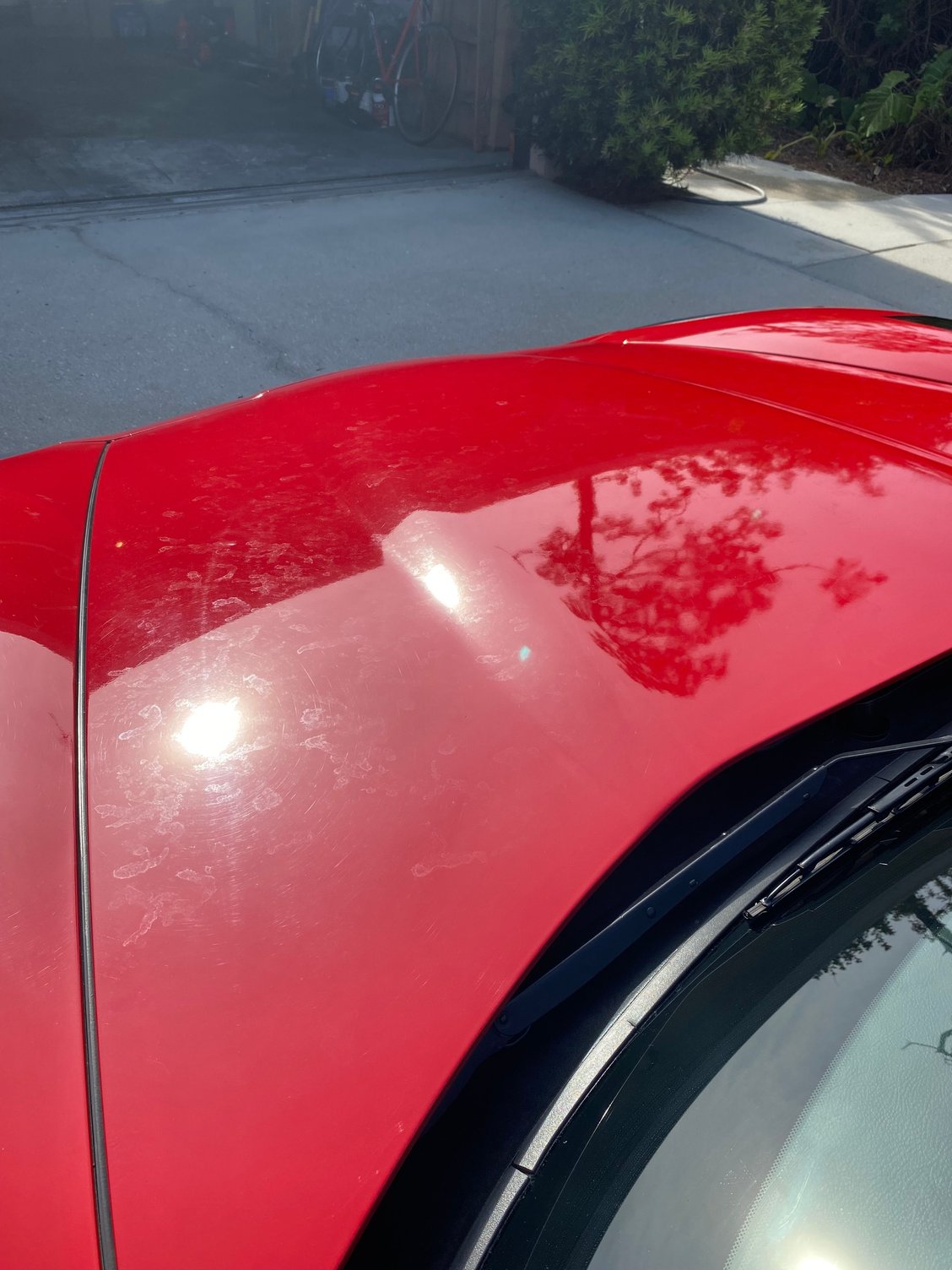

I took the car to a body shop he recommended and they told me about $3,000 to wet sand the whole car and if that doesn’t work it needs to be repainted which will cost over $10k. I bought some meguiars scratch x and a better orbital, seems most of it can be buffed out but not all. I’m about to tackle the job myself as I’m a detailer but feel I should be compensated for my time and supplies. I would charge someone $500 for the job I’m about to undertake.

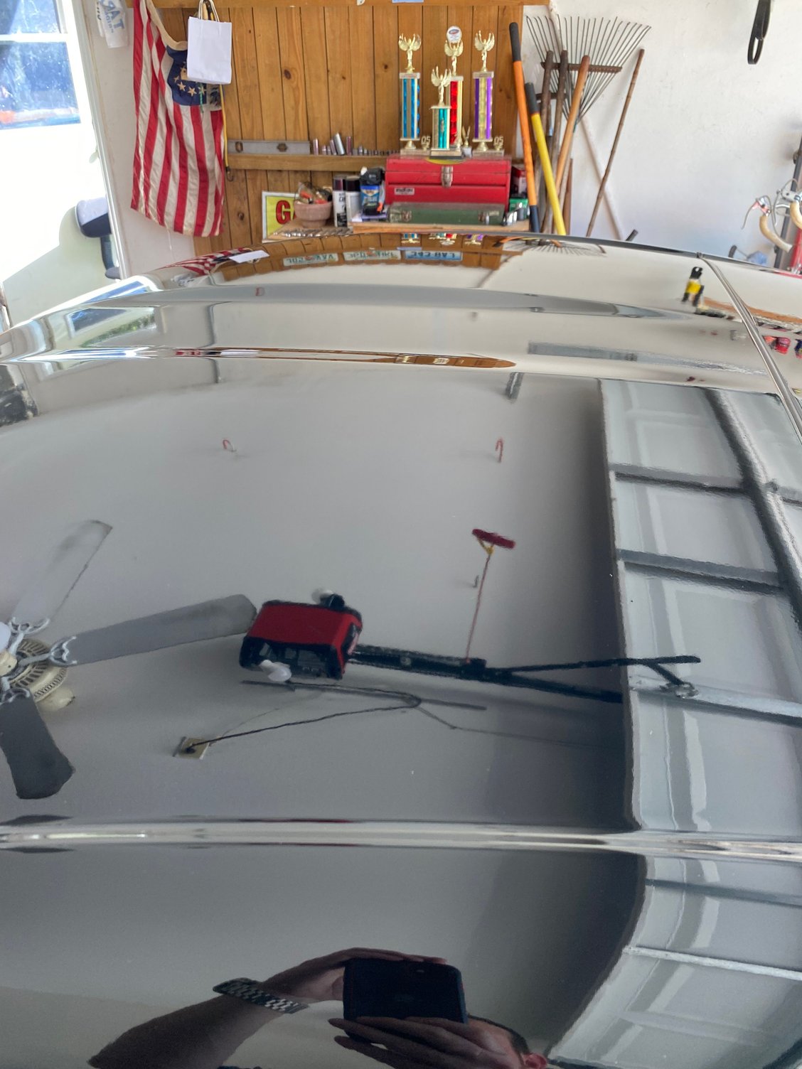

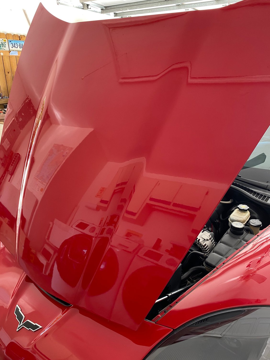

Thanks again, i can’t be 100% sure the window was open while there but with the amount of pollen and even leaves in the car (hatch area, seats etc) something had to be open. It was fully detailed when dropped off. On a good note I was able to buff out all the paint damage with a 3000 rpm orbital and scratch x. Here’s some before and after pics, ended up costing me $150 and a few hours.
