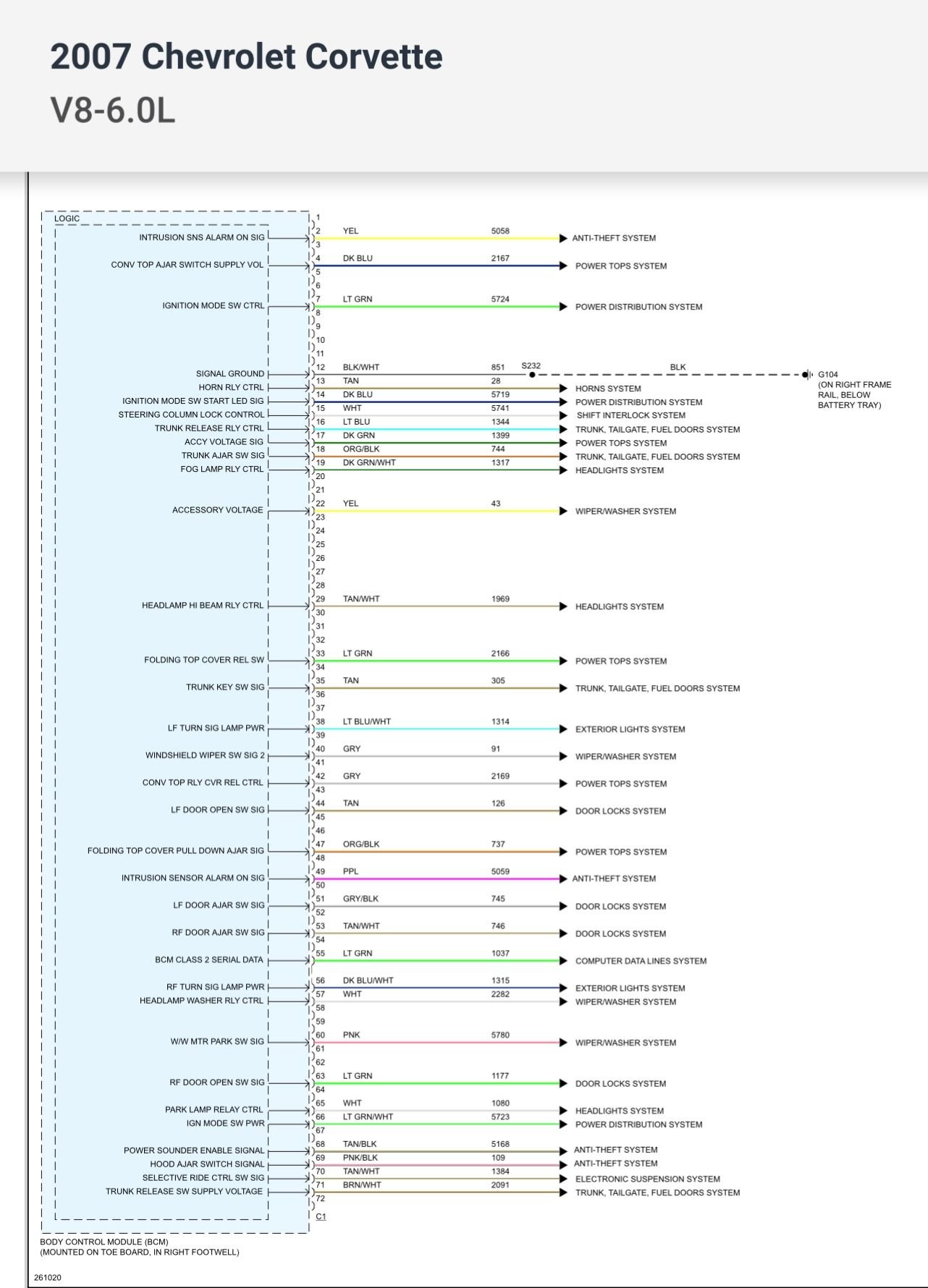

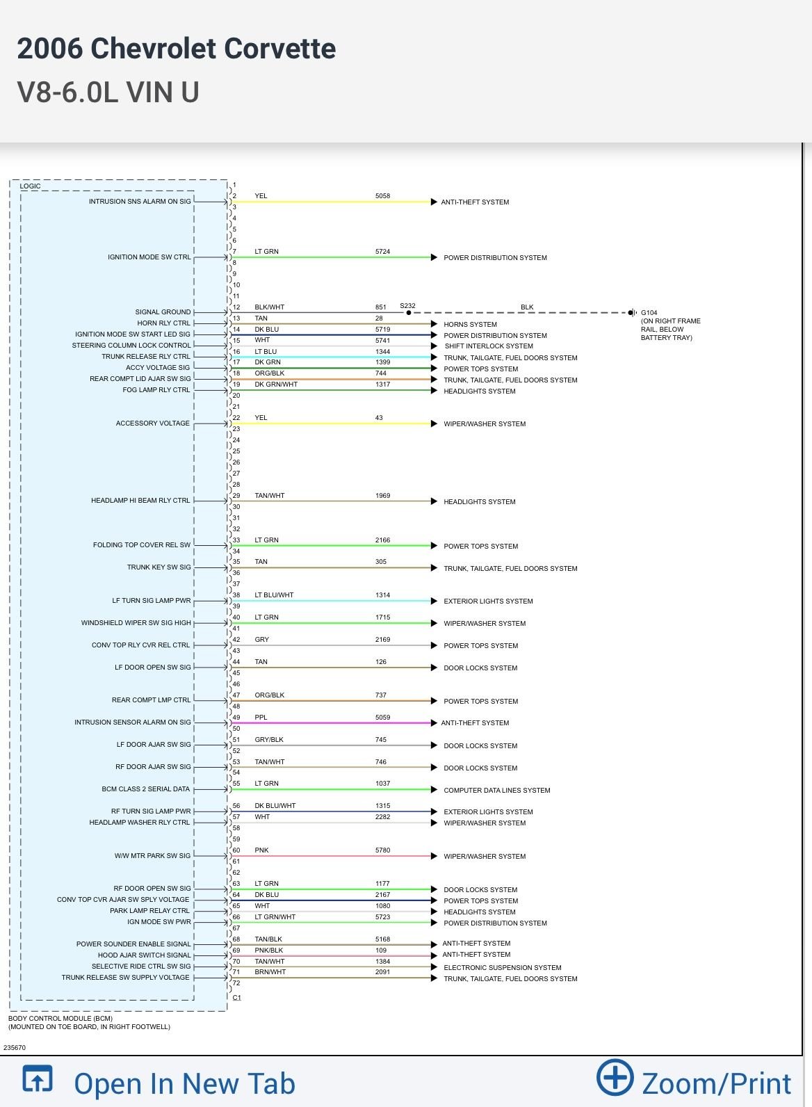

You have to be very careful when ordering a module such as the BCM that is not the same part number or year as your car as the input pin outs for that module may change or may not even be there year to year…a 2006 and 2007 BCM connector view below…for 06 look at pins 33,42,64….now look at the BCM you installed…pins 33,42,47….they are different so make the comparison between them…that is the only thing I can think of…the C1 (J1) connector is the only one that has anything related to the folding top.

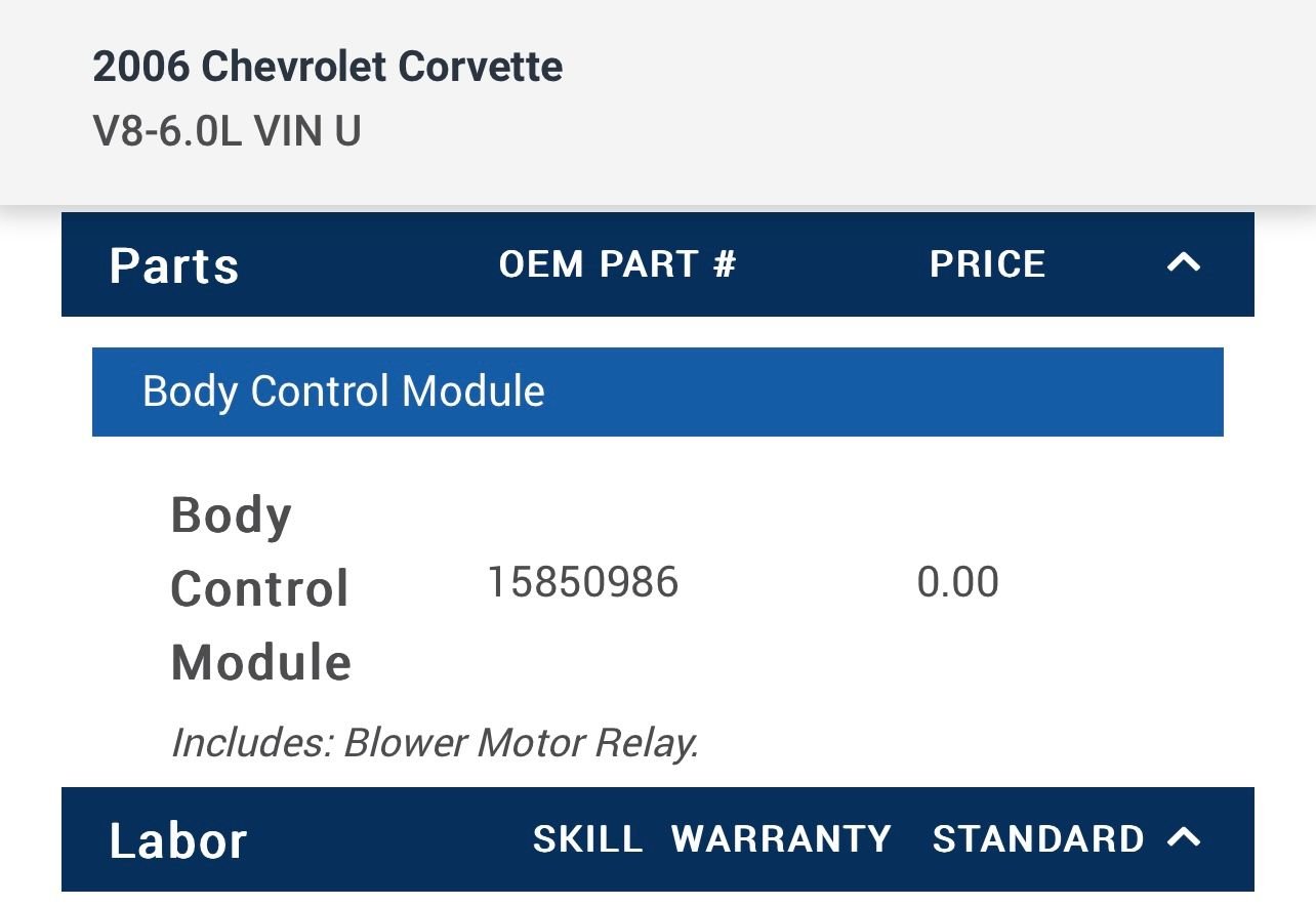

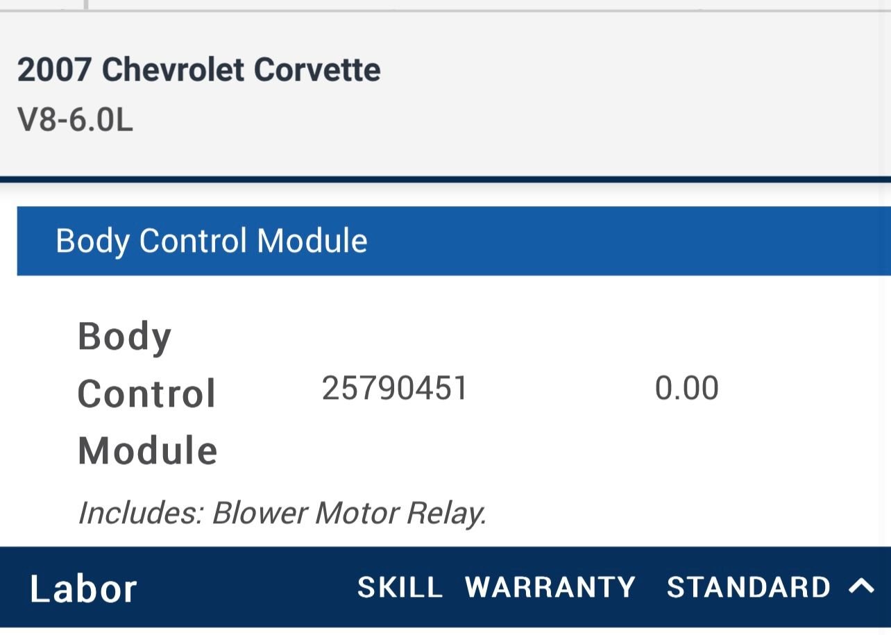

2 different part numbers !!!

Thank you for your answer C5 Diag.
I cross reverenced all the wires for the power top using your post.
Only one wire is in a different position between 2006 and 2007 for the Power Top.
2006 C1 pin 64, and in 2007 its in C1 pin 4 (dark blue wire).
I checked it in the car and it is in pin 4.
This means all the wires are in the correct spot for 2007.
Maybe this is a MY 2007? (VIN says 2006).
The bad ECM is indeed a 15850986.
But the 2007 ECM is not a 25790451 but a 15916669 (but should be the same)
I think the solution is to order the correct BCM for 2006.
Yes, you need the 2006 BCM.
These are the OEM part numbers from Alldata…best to check with your Chevy dealer for the most updated or alternate part number.
Sorry, i meant the 15916669 is the one i am using.
