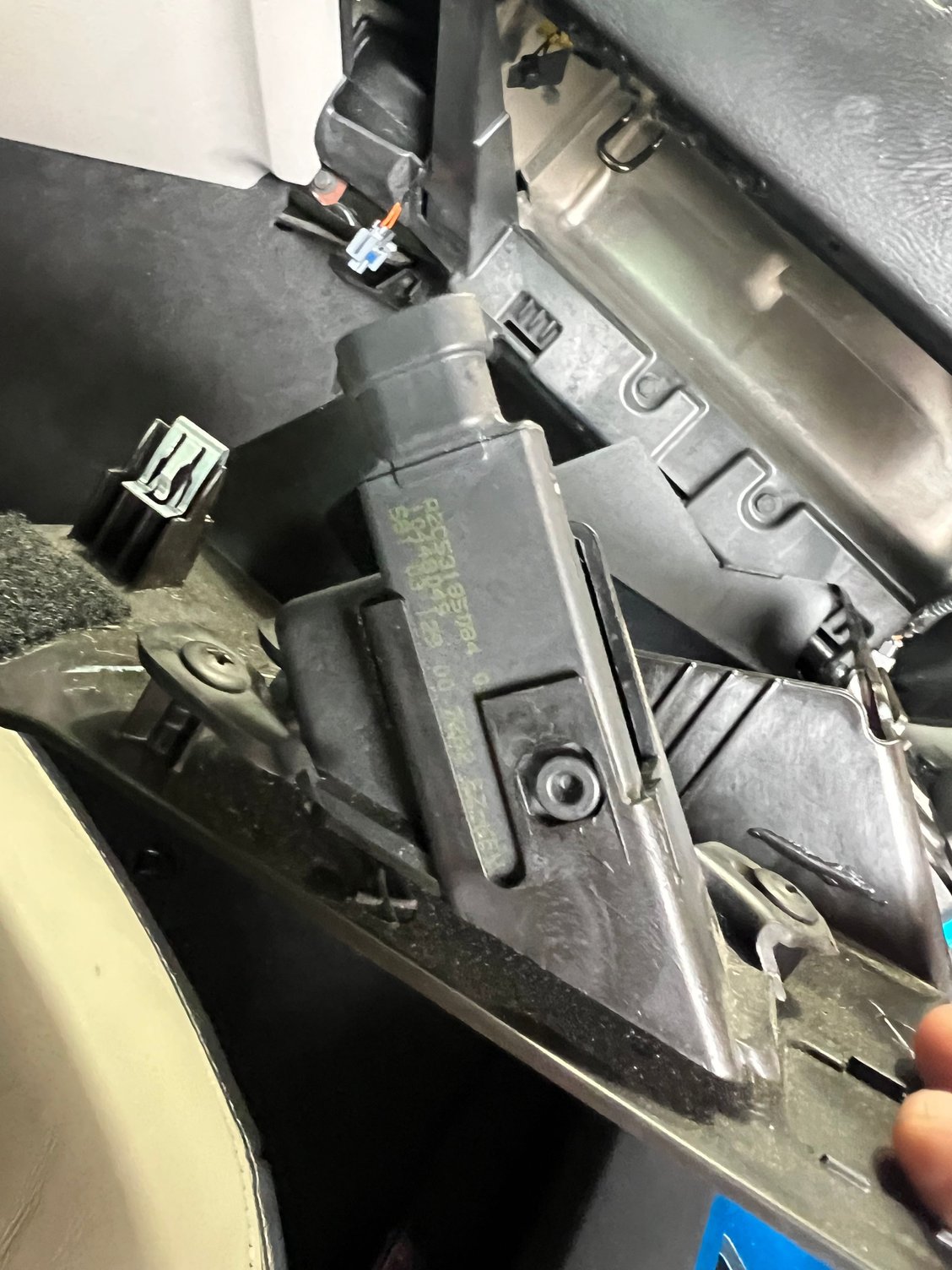

Hello I have a c6 base with 60k miles ( if you wanted details) so 2 days ago I somehow left my keys on the car and drove off thankfully I found my keys but the keys to the vette are gone. I used my spare to start it using the glove box trick and worked took it home and called it a night. Following day I started it up again using the same thing and it turned on great. Went to where I had to go was able to leave that spot back home using the same method. When I got home I tried to program my key doing the window, glove box and truck open. I did this about 2 times and failed every time. (I only have 1 key to program as of right now, other one comes in Monday.) since it didn’t work I just decided to call it and I wanted to park up the vette in a better spot and roll up my windows. After trying to use the glove box method to just move the car it no longer starts by putting it in the glove box. I’m already planning on calling a locksmith to program the keys once the other one gets here but my windows are still down. Any tips or ideas on what I can do to save myself money and time?

Did you replace the battery in the spare FOB ??...if it has been years since using it it's probably dead...as long as the FOB is OK with the dead FOB battery it should still start when placed in the back up slot...to start the car whether with a good functioning FOB or not the back up antenna MUST be good...or the AC voltage (less than 1 volt) signal going to the antenna is not there which may be a bad RCDLR....make sure the battery is around 3.2 volts.

Yes I bought a new pack of 2032 batteries and it’s strange that it doesn’t work anymore because I turned the car on 3 times using that method and now it doesn’t even work so I’m lost. You think i hsould check the antenna?

Well those batteries could have been sitting in the store for a while so if you have a DVOM check the voltage first…it’s funny how the FOB worked in the back up antenna slot but not now…do you hear any “clicks” coming from the RCDLR when pushing the start button ??…to satisfy my own curiosity last year I removed the antenna and with my good FOB and with my spare FOB with no FOB battery installed the car did not start with the back up antenna removed…I took the antenna out of the garage and the car did start a few times and then a no start…you said yours started 3x’s and then a no start.

When pushing the start button or putting car in ACC mode max of .780 volts AC…red lead of DVOM to Orange wire and black lead to Orange/Black.

Service Info for your 2013...of the 4 antennas only 3 are used for passive entry...the last being the 'back up' which is only used for starting...I've read some info on here that states that 2 antennas are required for start...only 1 needed !!

I wanted to give an update about my issue. I want to first and foremost thank C5 Diag for his time and knowledge. The issue I was facing was the my spare no longer wanted to connect to my car, I believe the buttons in the fob weren’t responsive so after multiple attempts, trying the Amazon key fob and on the verge of paying a locksmith to come and program them for me. I was able to get my hands on an OEM key fob and got it to connect by doing the 30mins process. I HIGHLY recommend to just buy the OEM key and save yourself the headache of trying any other option. In the end I now have a brand new WORKING OEM fob and I’m happy with the result.. I know a lot of people would say to just get the OEM one off the bat and I wanted to avoid that to save myself a few hundred bucks but truthfully it’s the best option and makes the process a whole lot smoother! Thank you again !!!
