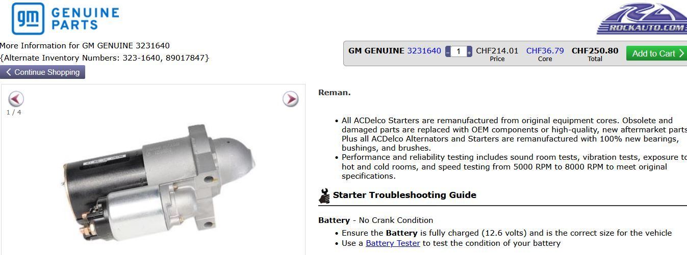

2008 LS3
The starter is this one :
Old Apr 15, 2025 | 03:19 PM
fat biker's Avatar
fat biker
Joined: Sep 2002
Posts: 111
Likes: 29
From: Hayward CA
Sounds like a defective drive.
Ask how I know.
Second on reman as crap shoot.

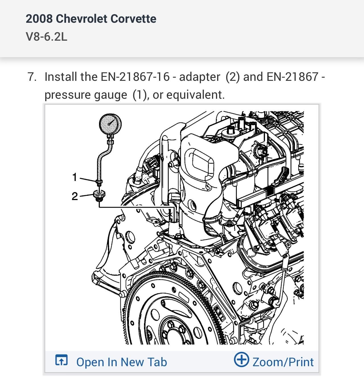

You can look on EBay for this adapter and gauge to read your oil pressure directly.
Old Apr 27, 2025 | 11:26 AM
chris383's Avatar
chris383
Joined: Mar 2010
Posts: 238
Likes: 10
I searched eBay, but I couldn't find a product that matched the ones in the GM manual....
There are "universal" tool sets that allow you to measure oil pressure.
However, I couldn't find the threads for the LS block.
