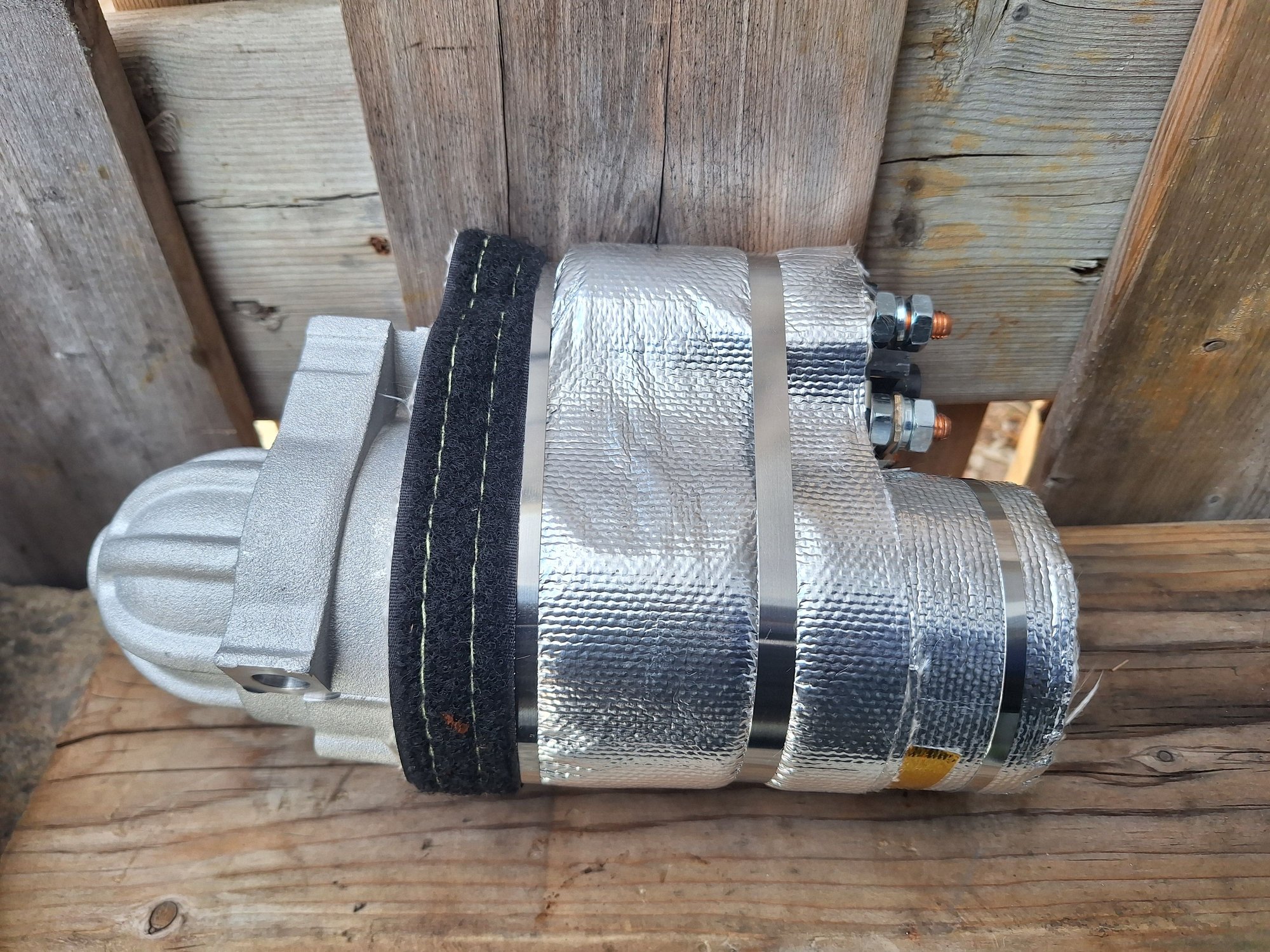

I’m looking to insulate my engine bay even further as well. At the moment, I’ve got my fuel lines, catalytic converters, starter, and intake all insulated, but the headers still dump a tremendous amount of heat into the engine bay. Beyond any performance concerns (even just IATs), we're talking about a nearly 20-year-old car. This kind of heat isn’t doing any favors to the longevity of the surrounding components and materials. I’m fairly certain the stock manifolds didn’t radiate quite this much heat, but I can't really remember to say for sure. As for the setup in the OP - I just wish the components were a bit longer. As it stands, it looks a bit unfinished or cheap. Maybe with a bit more time with a hammer and zip ties, it could work. Though I really like the idea.

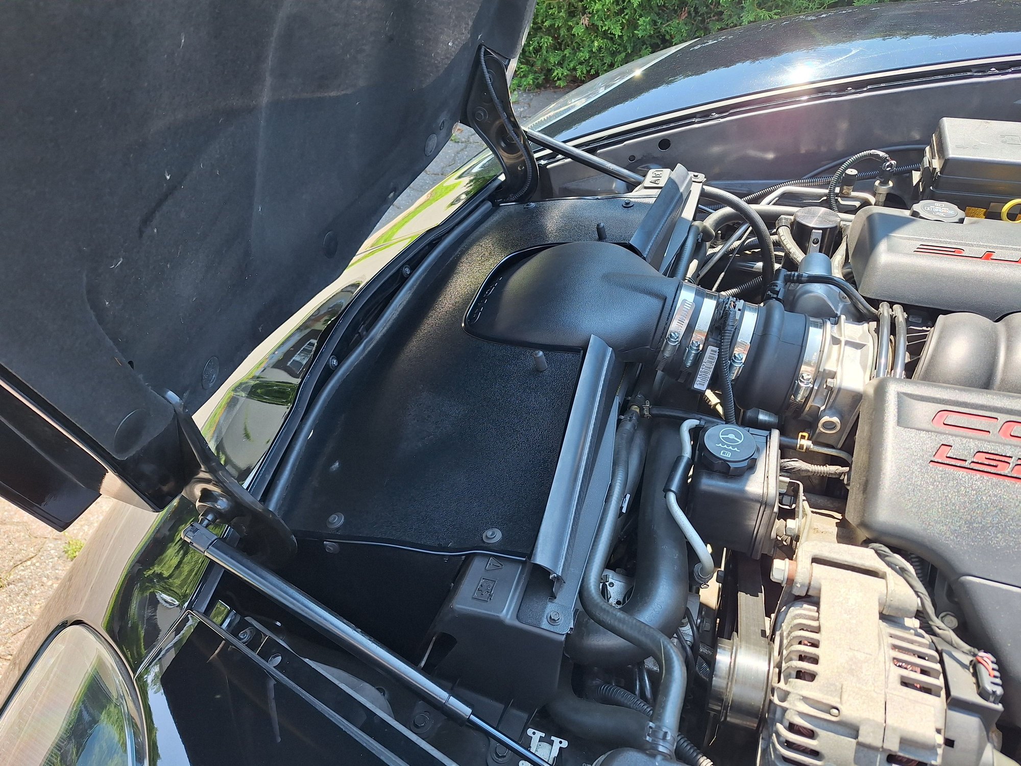

If money was no factor, I would have went with Inconel but it's pricy and doesn't look much different from mine. The "incomplete look" is for clearance. I only put it where it was important for the engine bay heat, the headers sit so close to the frame, they wouldn't fit if I covered everything. Once they are installed, you shouldn't be able to see any exposed piping unless you are under the car.
As for IAT's, I made my own cowl and modified the plastic in front of the radiator so it would funnel air directly into the air filter. This really helped in keeping IAT's consistent.
