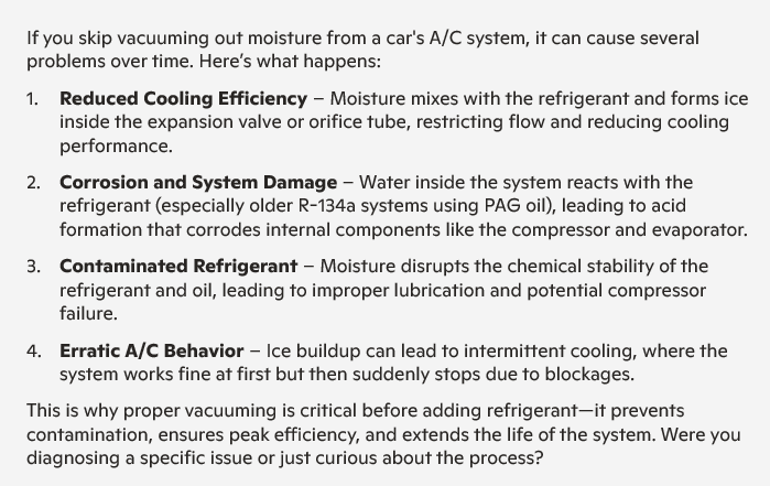

I like copilots description of what happens if you leave the water
I've always heard the ice crystals forming can damage components and block orifices
