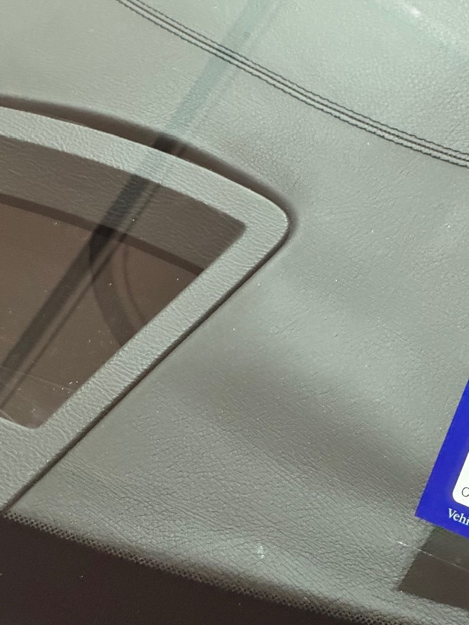

Guys,
My 2010 Grand Sport is a 4LT. The leather cover is starting to let loose up by the windshield. I am planning on reglueing it probably sometime this fall.
My plan is to have Safe Lite remove the windshield , reglue and then have them reinstall the glass.
My question is: What is the best glue to use . I obviously don't want to do this twice so I want the right glue.
Can anyone recommend a good glue. ( right now I'm thinking of contact cement )
Also, any other tips are appreciated from those who have done this PITA job. Like removing the old glue.
Please: no comments on removing the leather, That is not happening.

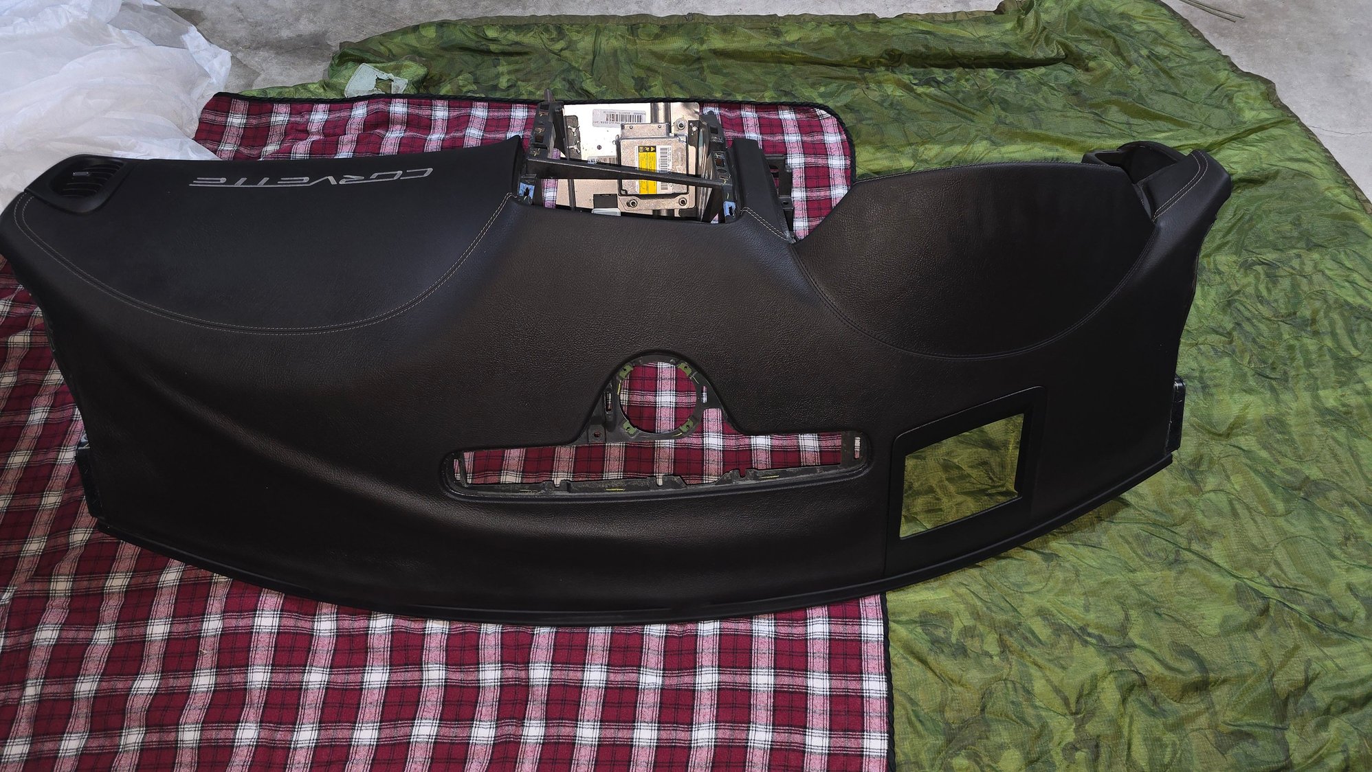

I'd like to see video of this 1 hour dash removal... It took me over 4 hours in multiple stints. Though I do have a Sony head unit and went very slowly ensuring nothing was damaged and all was labeled. All those damn connections are hell...
I dropped my car off at LG Motorsports last week and they wrecked the dash by running excessive heat into the cabin during a coolant change. Stay far away from them.
I'm taking the dash into Maupin in Dallas/Garland tomorrow so they can fix the dash and a pillars.

My dash looks similar but not quite as bad as yours. Are they fixing the glue issue or replacing the leather.

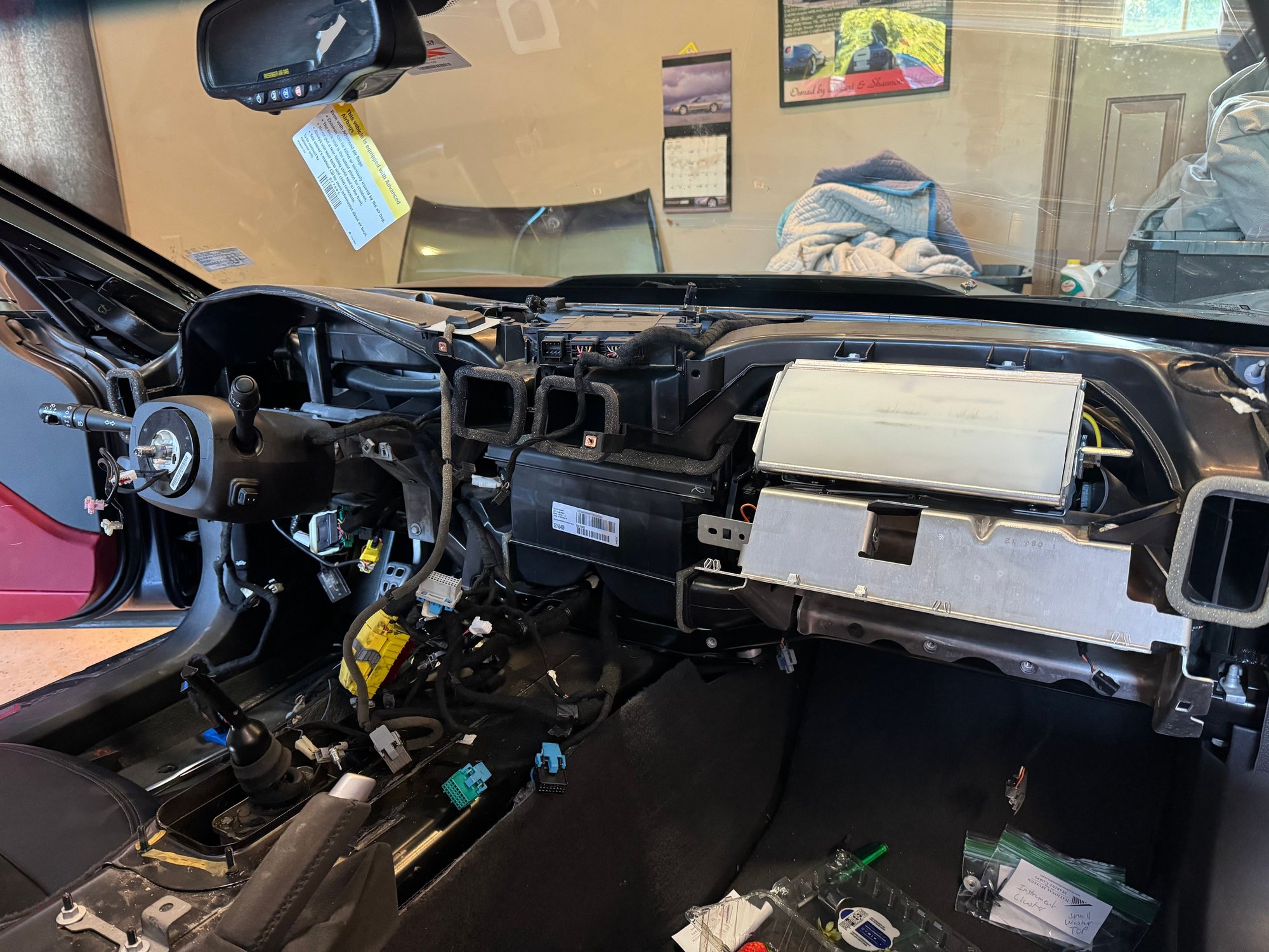

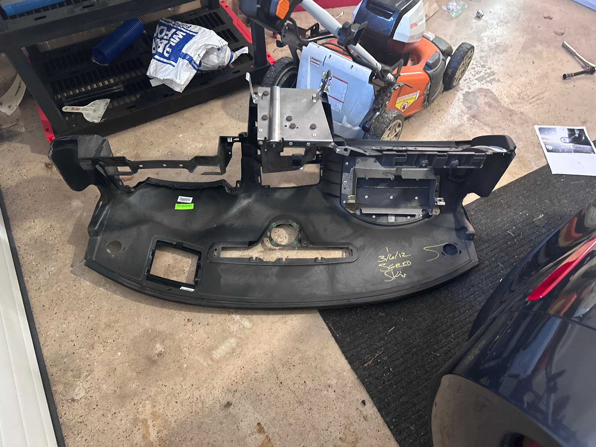

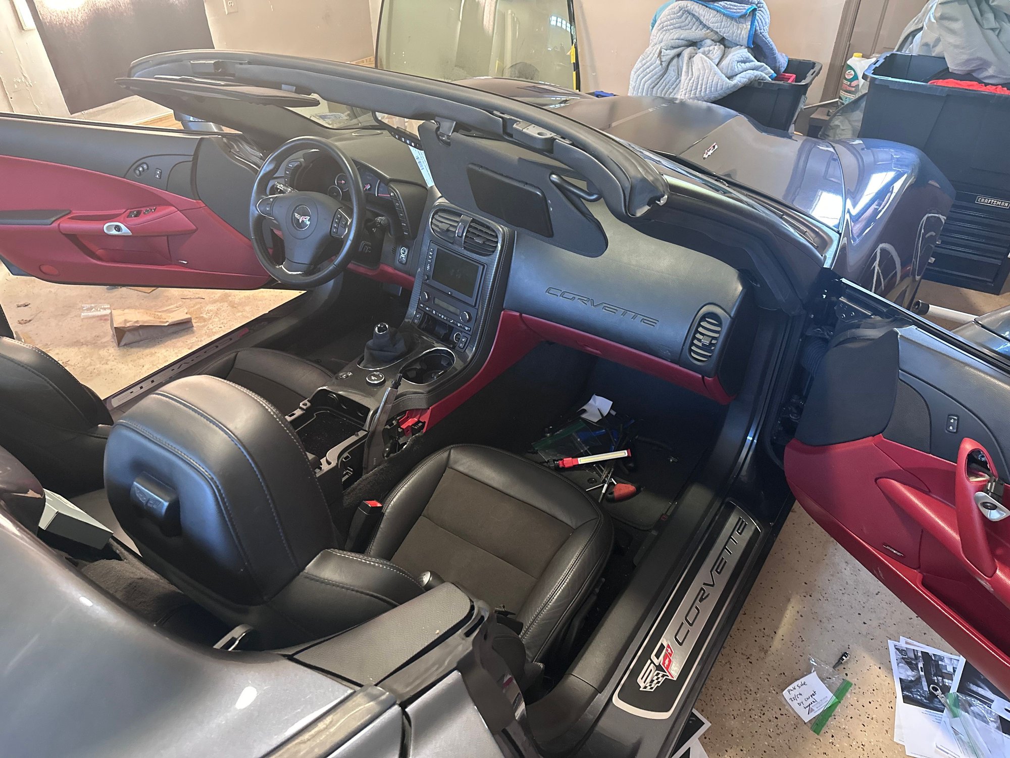

Removing the dash isn't difficult as mentioned above. Keep these instructions saved.
https://www.kawal.net/Dash%20Replacement.htm
I had my dash "professionally" repaired by a custom auto upholstery shop in Dallas in March 2021. The car had 18,600 mi at the time. It currently has 23,739 mi & I noticed this today.
I'll be pulling the dash again and fixing it myself this time.

Yes! They did a great job. Dash in back in. Now onto other gremlins!
