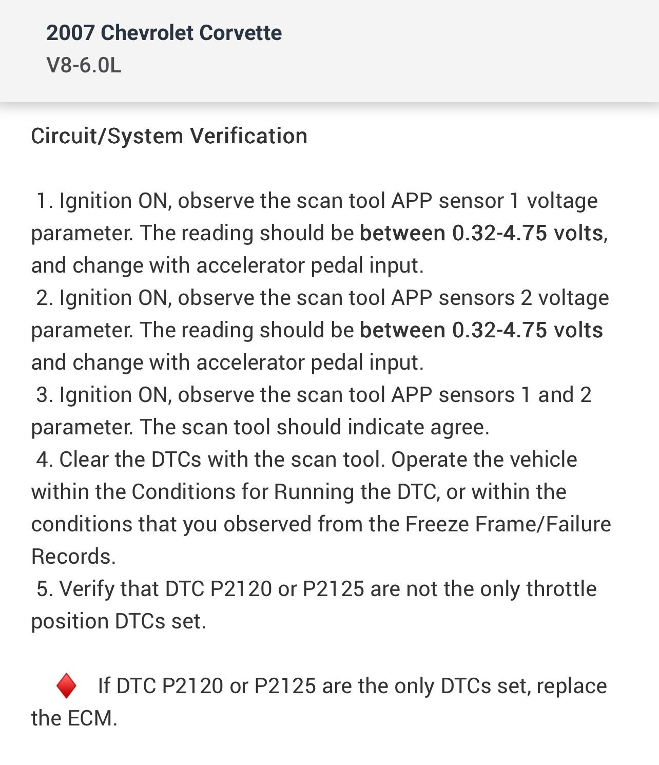

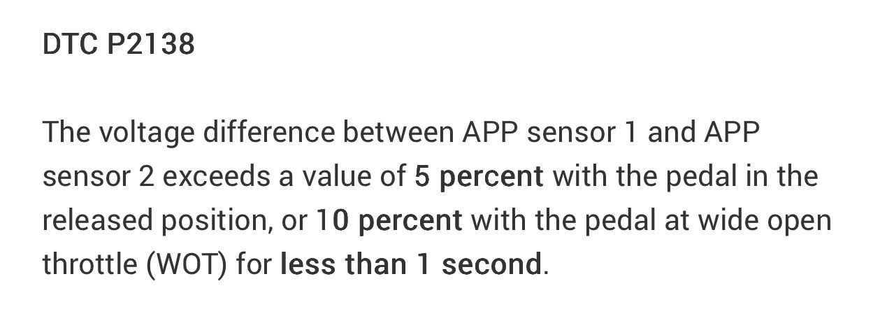

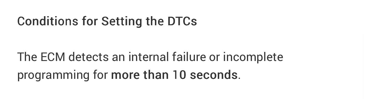

Seems like you already threw a throttle body at this so I doubt you or your Corvette Specialist will be able to diagnose this…Corvette “Specialists” are usually good at just oil and brake changes…seems like your P0606 may be a bad ECM but you’ll need to check its powers or grounds…the 2138 can be a bad APP or even an ECM…best to find a diagnostic shop that has the advanced equipment to diagnose this.
