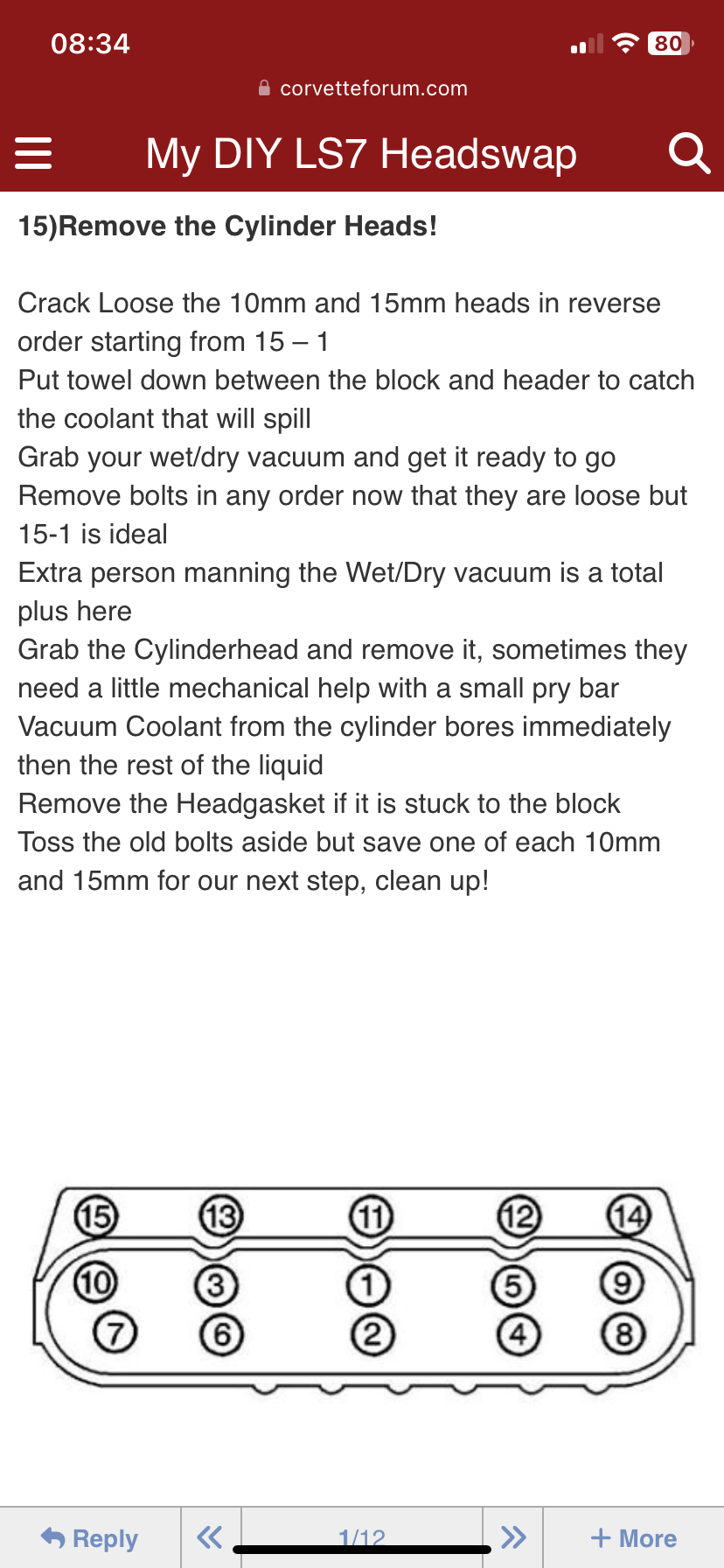

Going to remove the heads on my LS2 to replace the lifters and lifter trays since I just installed a cam. I am not going to have the heads or block machined.
Do I remove the head bolts in any sequence or just unzip them? Small bolts first then big bolts? Reverse of the install pattern?
I never had any issues, just want to make sure they don’t become warped during disassembly.

On the two head swaps that I’ve done I don't recall using any particular sequence for removal. That’s more important during install. I don’t think you’d hurt anything just pulling them out in whatever order you wish.
*Edit- I found the LS7 DIY head swap thread on this forum. It recommended that you break them loose in reverse order from that which you use to torque them. I followed those instructions both times, so perhaps there is something to using a particular order.

Common sense tells me to remove the outer bolts first then work your way to the center. Install would be the opposite, start in the middle and work your way to the outside.

I know yours isn’t an LS7, this is just for reference. The sequence may be the same regardless of which LS platform.

I pulled the heads off. Used a shop vac to suck out all of the coolant so the job was really clean pulling it all apart. I did this because I already had the water pump off plus the front timing cover since I put a new camshaft in. New front main seal as well along with a summit racing harmonic balancer and arp crank bolt.
Removed the bolts reverse of the tightening sequence. Sent them off to the machine shop to be cleaned and checked out even thought there were no issues prior. They said there was very minor pitting around some of the valves but they held vacuum perfectly. I opted to have them do a 3 angle valve job. They also resurfaced the head but are only taking off .003 thousands of an inch. I’ll be picking them up in a couple days.

In automotive school they taught us
to remove in reverse order
