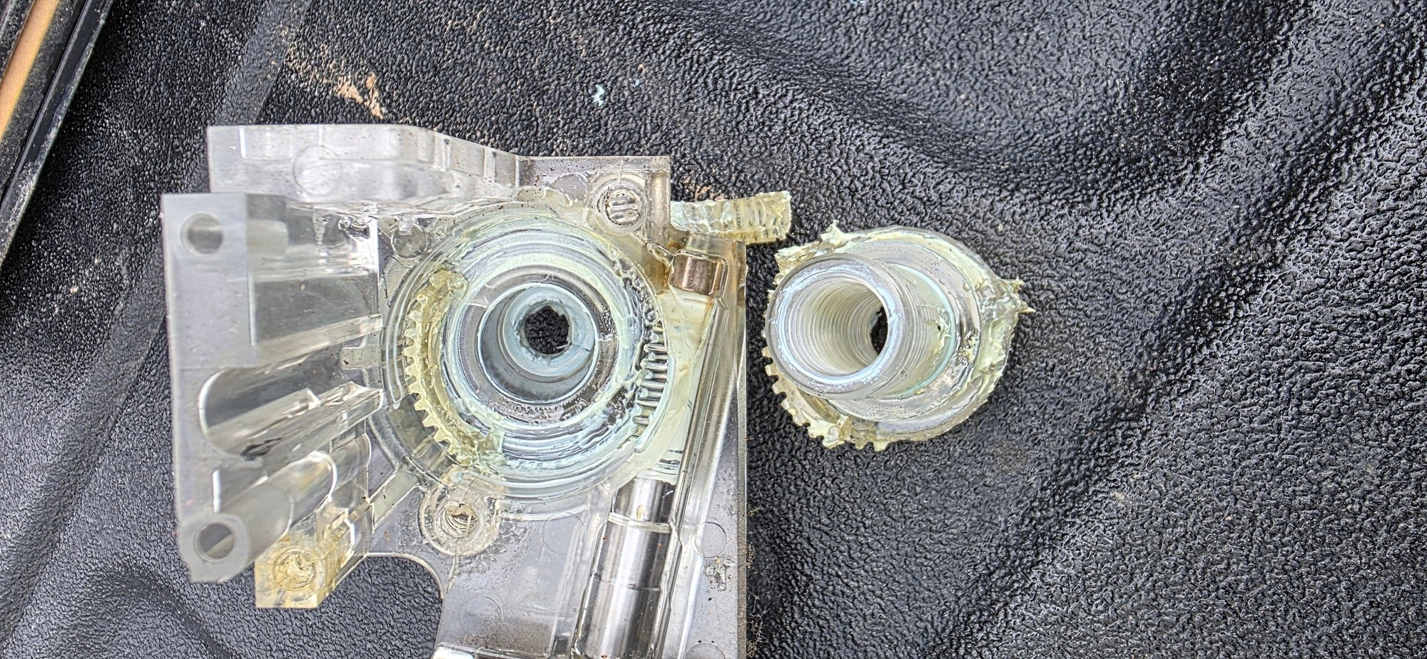

A few days ago my top stopped working (3LT, so power top) it would get about 1/2 of the way then would stop. I did some online investigation for others with this issue and it seems like the common item to break is something in the tonneau cover latch, so I ordered a new one from C&S Corvettes. It came in today and I installed it, fixing the issue of the old gears being destroyed!
destroyed plastic gears
